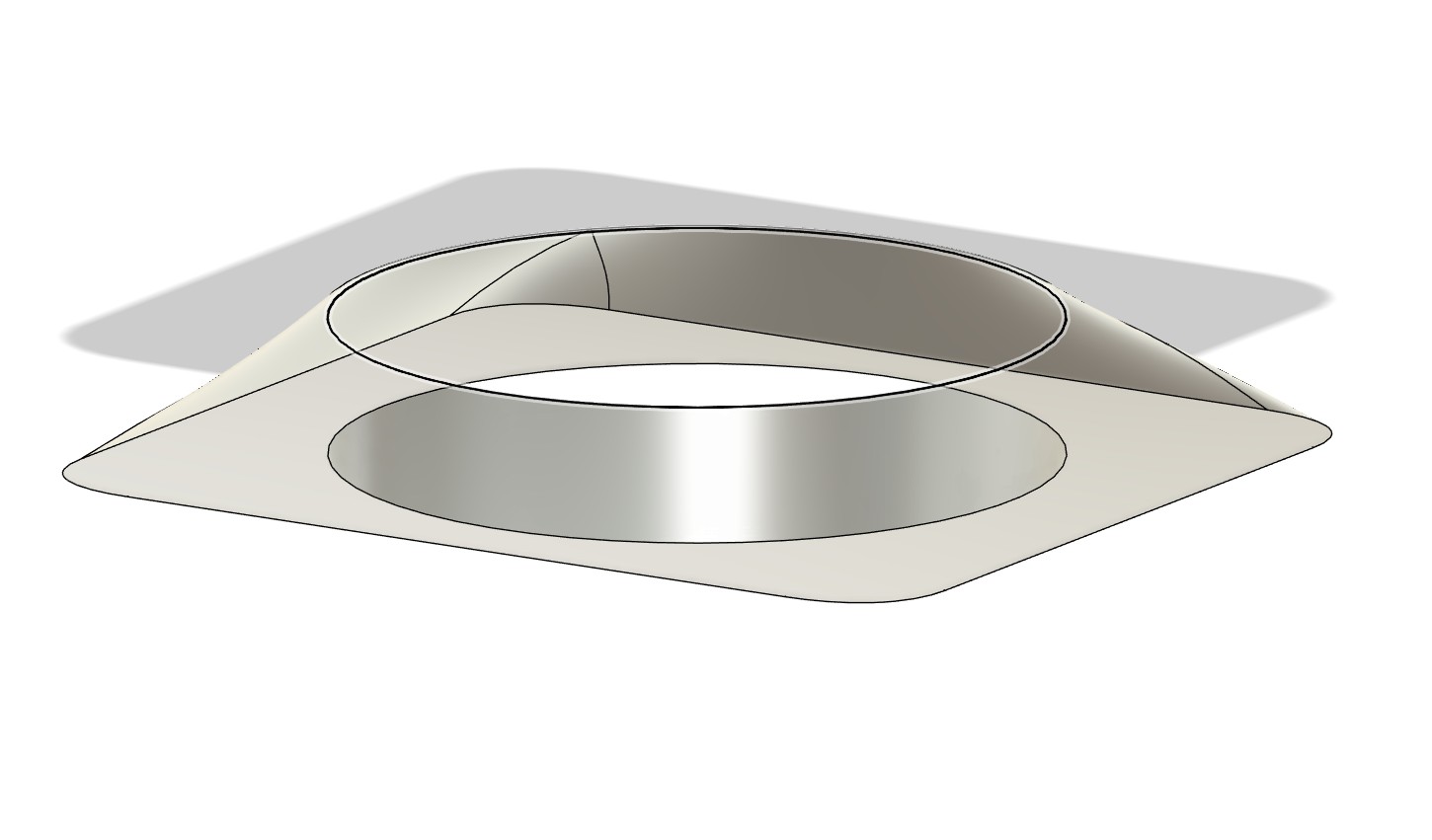

Hi, I modeled the cap for the exhaust pipe of my house and printed it using ASA material. I’m facing a problem with poor layer adhesion. I can’t figure out why this is happening. The filament is brand new, freshly opened Elegoo ASA White.

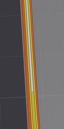

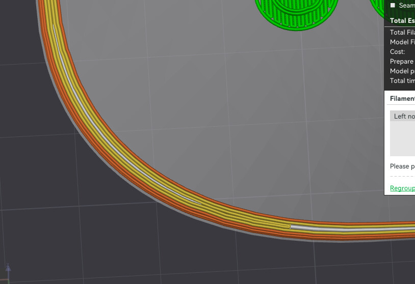

A couple things that I noticed:
  1. Your model was not exported in high resolution. The geometry is quite rough and jagged.
    2. You might want to use Arachne to avoid generating gap infills
Gap infills are pretty bad for printing as they create very uneven extrusion. This could be the main issue of your print.

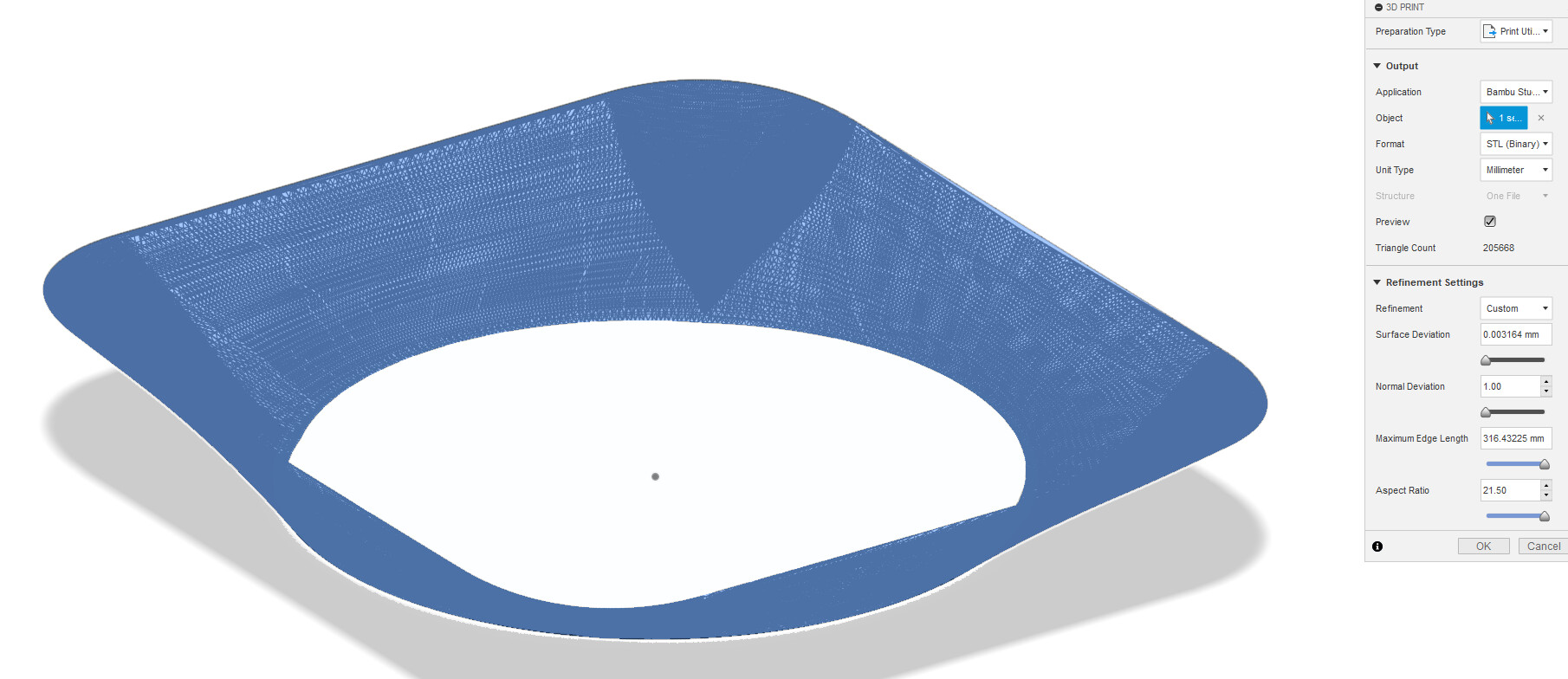

I modeled the part myself in Fusion360. It’s true that I exported it as an STL and not through the 3D Print option, but until now I never had a problem with that. Honestly, I’m curious — how did you come to the conclusion that the issue might be with the export quality? Could you please explain it to me so that I can assess it myself in the future?
This is for now.
The problem I have now is how to export this quality directly into an STL file in Fusion, and not just into a project for Bambu — but that’s another topic.

You have some significant overhangs in the corners. This will reduce layer adhesion because there is less overlap between layers. Can you make the angle steeper in the corners? You could also try using supports if you cannot make the angle steeper.
