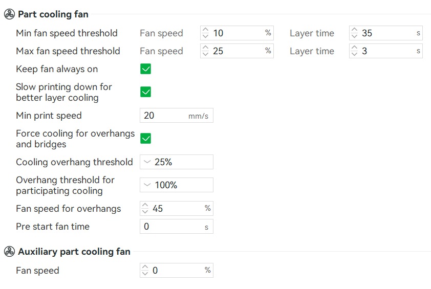

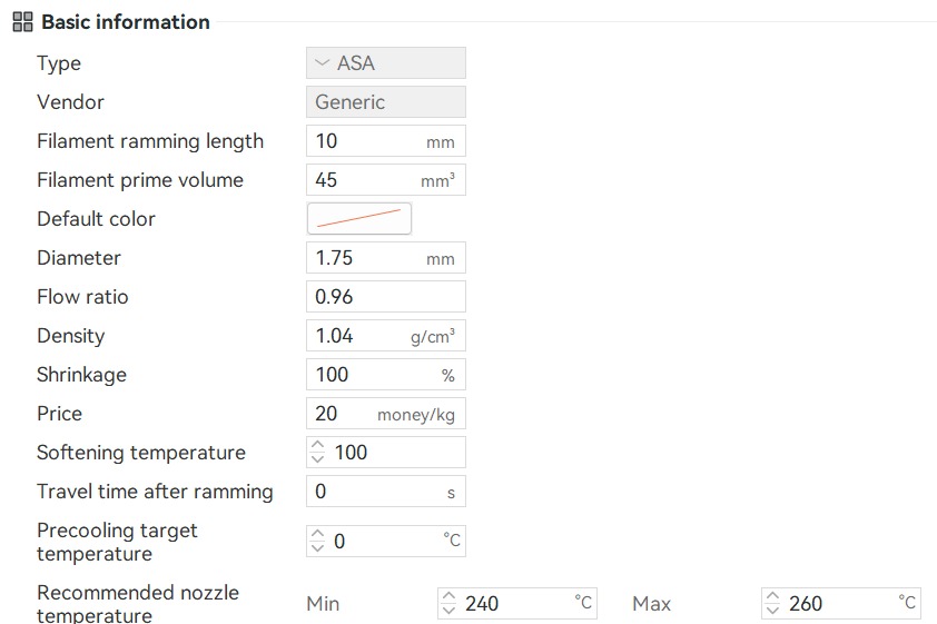

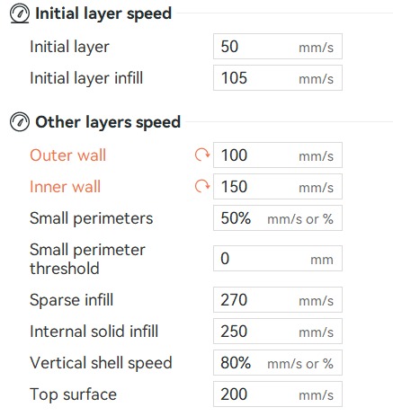

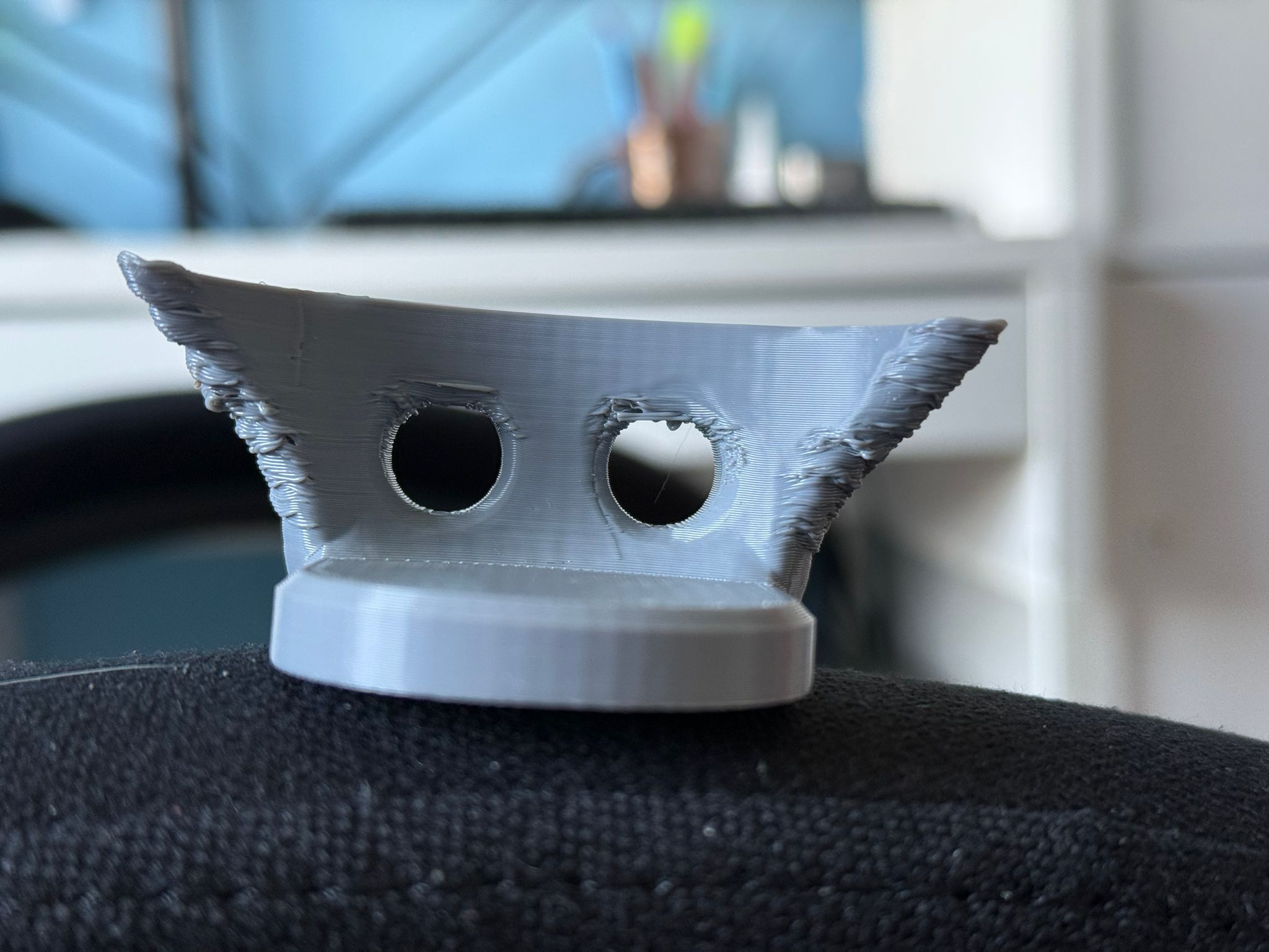

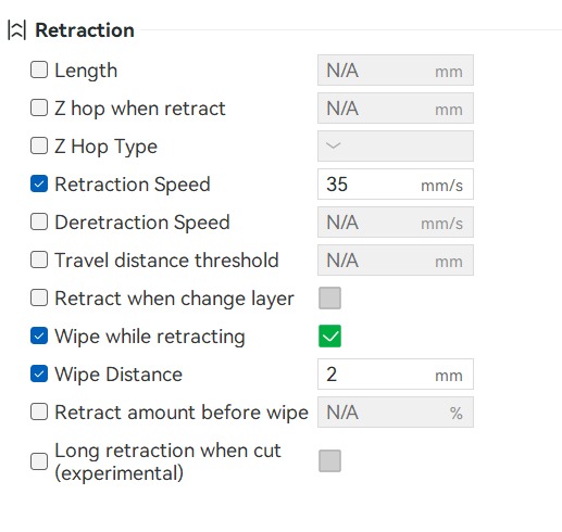

I am having serious issue with the adjustment of my printing profile of Nebula ASA filament.
Generally it prints very well the first layer when the project is flat, however when it comes to the hanges… its getting really bad.
Filament is dry, in the chamber the temperature is around 45 celsius.
Here’s my settings:
Any ideas for the improvment?

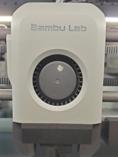

Have you verified that your part cooling fan is infact working? You can do this by turning it on via the display or remotely with Studio or the Handy app.
No, I haven’t. Do you think that’s the case?
It’s the first thing I would check when over hangs are a problem.
I made a small “dot” on my fan with a silver Sharpie, making it much easier to see if it is spinning. Shows up well on video.
If I were to use anything heavier, like paint, I would make two dots to preserve the balance.
