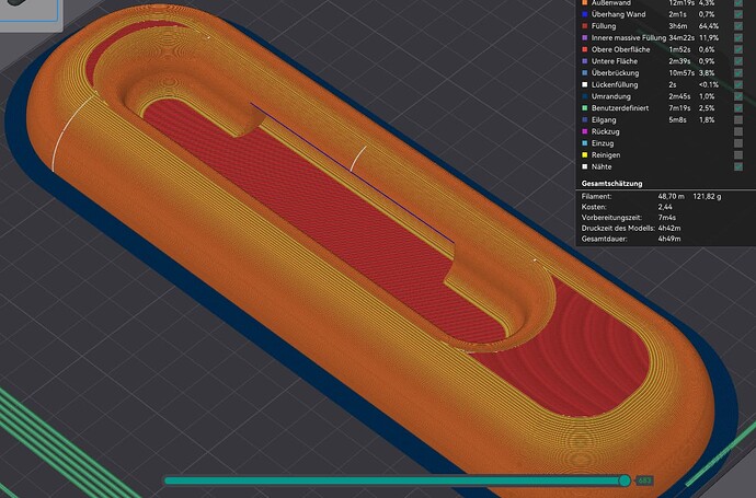

I’m not a fan of ironing on anything other than a flat surface. How many top/bottom layers are you using? Also, how does the sliced version look? Is it clean or does it also show oddities on top in the slicer?

How many layers is the top surface? If you’re printing the filament too hot/no cooling, with a low enough % infill, the filament may not successfully bridge the infill, it “droops” and then the top surface will be ratty because the underlying layer(s) aren’t smooth. Increasing the layer count will fix that.
@just4memike I only used 2 or 3 layers, but I also tried like 5 and it did not really change the result.
This is a screenshot of the sliced model
