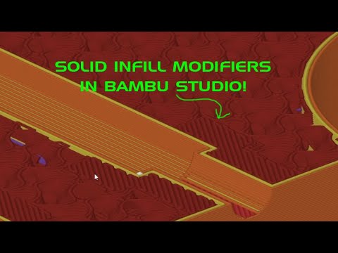

Here is a video about using modifiers in Bambu Studio that is a very similar use case to what you are printing and wanting to achieve.

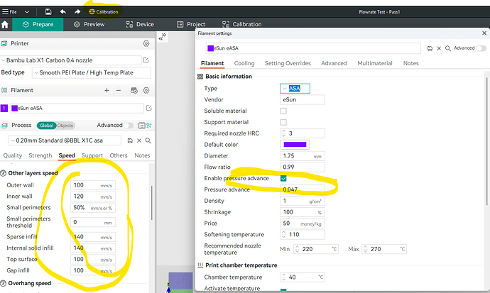

that is bad, slow than man first Temp, K(Advanced pressure/ Dynamic Flow calibration) and Flow calibration and make sure drying ASA This is a must
ah and speed bellow 150mm/S everywhere
Talking about the actual surfaces and calibrations
All of the above changes and tries will not drastically improve until you do the above
  • Set the Temp to Max of the Filament type or 5-10C bellow max , i am using 255C and very often go above max for ABS
  • Bed Temp at 110C this is my max , but US models have 120C
  • then suggest you to follow the following

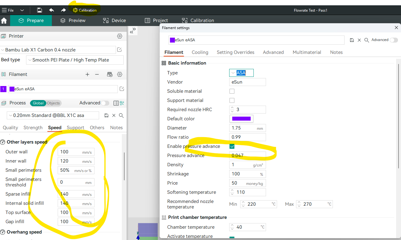

  • do Flow first Pass 1/ Pass 2 - kinda you can skip Pass 1 if you have an idea where you are , usually i do only Pass 2 for ASA setting it to 1 , result usually is around 0.94-0.99
  • do K
  • Repeat Flo Pass 2 again with a bit higher value from the first result for ASA thsi fine tunes it
  • if change the Print temp you need to do it again but depending on the barnd and type around 5C-10C does not change enough to affect the print , in this case i do not bother too much with K unless changing temp a lot and do not do the fine flow repeat

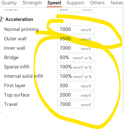

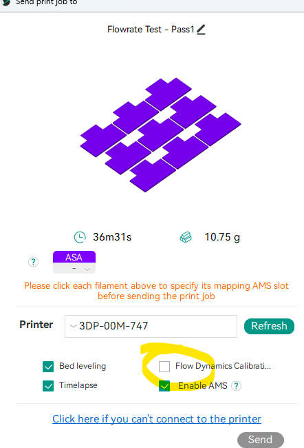

For K Calibrations and printing after that this must be off:

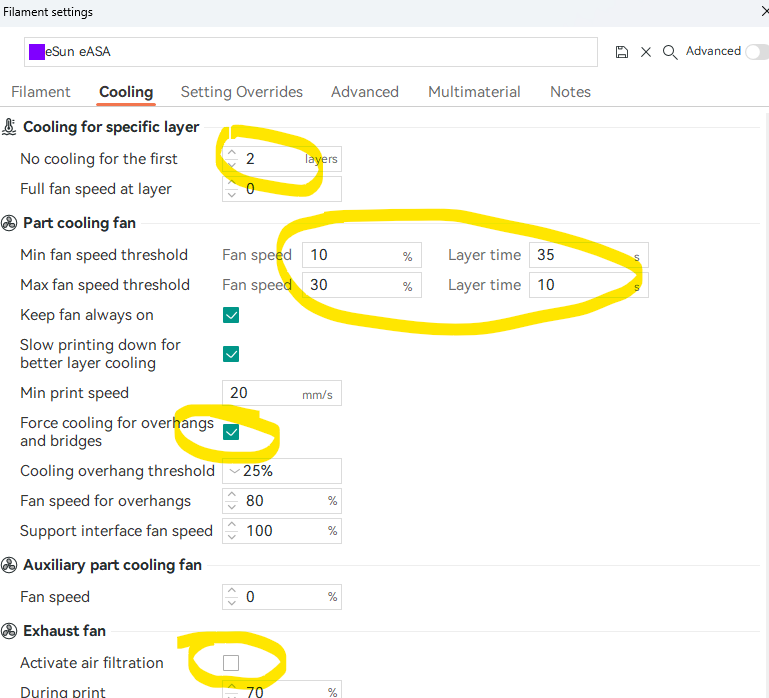

ASA print cooling settings which work for almost all my prints very rare had top decrease from this
Only for some Prints with warping usually big prints , now i use it with everything
high chamber temperature 50C+ usually close to 60 , achieved with Bed Temp 110C and initially i was covering the printer with a blanket for some real big ASA/ABS Prints, but since @NeverDie or some one else suggested cheap method to cover it instead of Active heating i just glued 5mm insulation material on top and sides externally with out the door and now no problem with Warping and getting around 60C , with out the blanket hassle

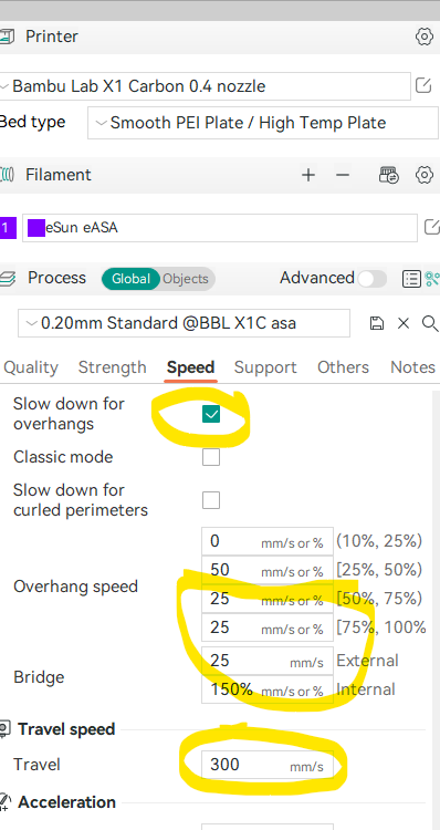

It’s a small nit, but the 20mm/s “Min print speed” can and will override the “Layer time 10” on small parts, whereas probably what you really want is for the “Layer time 10” to dominate. I don’t see that “min print speed” has ever been helpful to me, so I reduced that field to 1mm/s (effectively disabling it) so that it won’t interfere with the “Layer time 10” setting.
One note regarding the Pressure Advance (Factor K). In both Bambu Studio and Orca you can go to the Calibration tab, then Flow Dynamics. Click Manage Results and you can add or edit Factor K values on the printer
@neverDie thanks for pointing , for the other people would be good to know. for some reason if i print eSUN eASA bellow 20mm/S on overhangs does not get a good result . Not sure why, but i discovered that when was tunning the overhangs as you will see there it is 25mm/S as that is the speed for me with best result. And in saying that have not tested specially for small perimeter flat probably does not matter so much. and after a few nights and tests of 5mm to 50mm on each angle, stack with 25mm/S and for this one just reverted to defaults
Also the bridge speed not tuned to perfection , but as it is ok ( and tired from too many tests ) , if you or some one has different bridge speed would like to know about it
@all if some one is using for ASA overhangs different speeds and cooling profiles - from defaults and mine , please publish
