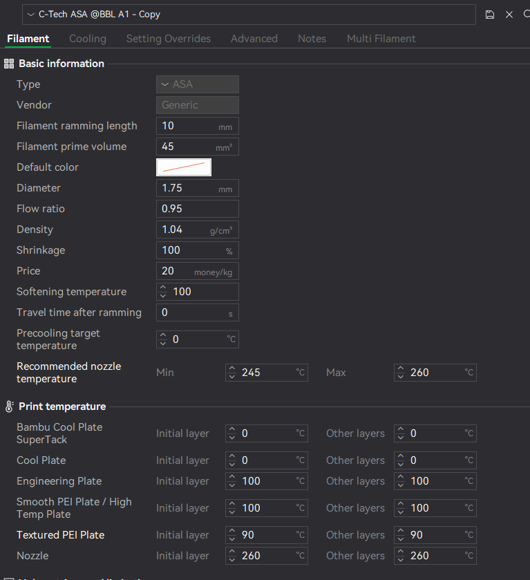

I tried twice different settings, before finding what works with my BambuLab A1 printer.
I used as starting point what @Sideline_Review gave as screenshots and it solved my wrapping but at 75-80% of printing part, suddenly the part stopped to stick on plate and ruined my printing.
After adding glue to plate, everything works well with filament C-Tech.
Here are my seetings for C-Tech filaments (based on generic ASA settings):

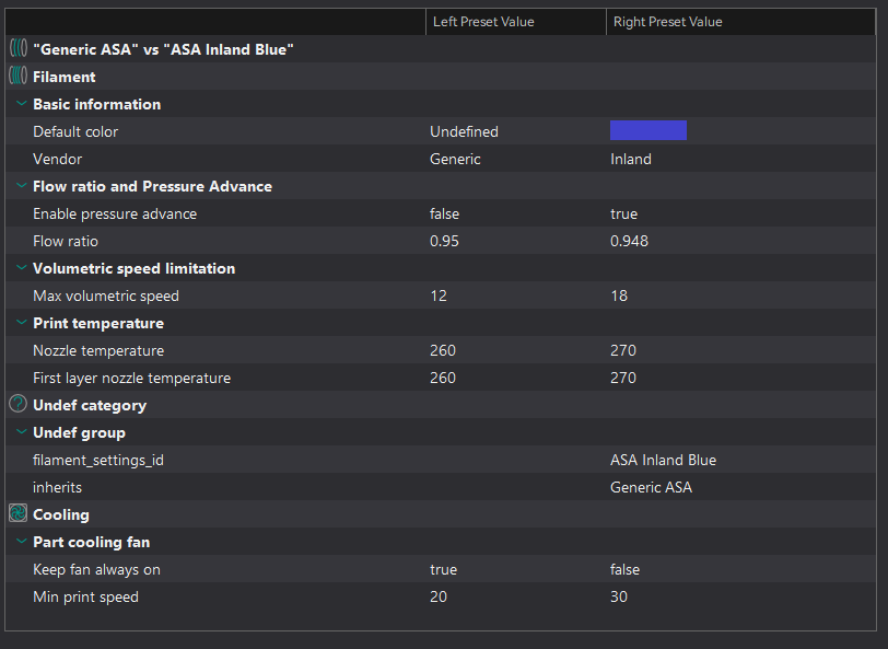

This is typical of my calibrated ASA presets.
No speed reductions. Nozzle temperature is the only significant change from the Generic ASA preset, and probably accounts for the higher max volumetric speed. I use Engineering or PEI plates, with glue.
Preheating the chamber with the heatbed is essential. I don’t think an X1C or PiS can get too hot, but I look for at least 45°C.
