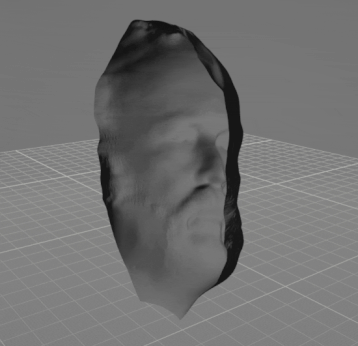

I created a 3D portrait bust in Blender cut it in half to expose the interior shell (similar to a mask) then exported it out as an STL… I have an issue slicing the model to create a smooth surface.
I really could use some assistance as to how to properly slice this. I am printing with the outer surface down (with supports) and the inner surface up.
I am uploading three images for clarification:
BlenderModel - This is the view of the interior ‘mask’
InteriorSliced - These are the weird artifacts I see when sliced
PhotoInterior - This is an actual photo of the 3D print.
I am trying to achieve a smooth surface. I have tried dozens of slicer settings, I have also tried thickening the model in Blender using the solidify option.
I think I am just missing something major. If anyone could tell me how to fix it I would be appreciated.

Thank you Olias for your very detailed and informative explanation of the issue and options available. I was hoping to minimize post production manual surfacing. The exterior surface would be simple to sand and finish but I really need the interior smooth. I could definitely finish the interior with the techniques you recommended but I am trying to reduce the labor.
When I built this model I exported only the surface polygons of the face. Now polygons are just planes with no thickness or depth so I am not sure how the slicer handles that. I was trying to achieve a single layer thickness for the shell and ideally something like a spiral vase print to minimize any artifacting. A spiral vase print did not work because I needed supports.
There are two different types of problems with the model that I see, one is the squiggly layer lines which I understand, and as you mentioned I may try switching to a finer nozzle and reducing the layer height to help minimize those lines. The other issue is the messy what looks like second layer, and I don’t understand where that comes from. I included an image of the slice with the two areas highlighted.

I believe there’s a setting to ensure wall/ceiling thicknesses and that might be what’s triggering the second layer? I mention this since you mentioned exporting zero thickness polygons.
Printing a model that has what sounds like no thickness, it could be that setting is what is allowing it to print. Frequently when parts of a model get to be on the order of the line width, the slicer will just leave them out.
I don’t know that’s what’s going on with your print but maybe?
I will look that up. What I just tried was creating a cube in Blender and then using a bool subtraction of the positive of the mask. I made a prlnt and it looks great. I still see the layer lines but that doesn’t bother me. Those weird messy double layer artifacts are gone. I am going refine down the cube and I can play with a higher resolution nozzel. I am using Bambu Lab’s new white PETG-HF and I am printing in ludicrous mode. The semi matte surface is great.

This is my theory too. Without access to the model, I can only infer that the slicer might be trying its best to render a dimensionless model, i.e., one that has only a shell without solidity, and is therefore only able to approximate the geometry. There are tools such as Meshmixer that have the ability to make this solid. Fusion360 as an example, as a function that will convert a mesh into a solid.
@phodara : Without seeing a cross-section of this model, it’s difficult to provide specific help. We can only speculate on what the slicer is interpreting and the suggestion above is only a guess.
If, for example, your STL is a hollow mesh, meaning a shell with no solid inner surface, making the mesh solid might resolve this issue. However, without more information, we can only make educated guesses.
Here’s an example: On the left, we have a solid model, and on the right, we have a hollow model. You can see that the slicer treats these two models differently.

I’m assuming that this is a proprietary model that you don’t want to share. However, it would be extremely helpful if you could at least cut out the problematic section and upload that, so we can directly see what the slicer is interpreting. Of course, you’ll want to do a test print to ensure the model hasn’t already been made solid. If you encounter a “Non-Manifold” error, don’t fix it—try the print anyway if possible, or just upload the 3MF file with the open mesh error.
Also, where did this model originate from? Is it from a 3D scan?
It is a 3D photogrammetry scan done with an IPhone. My last print came out pretty good. As I mentioned I did a boolean subtraction from a cube. I am trying to reduce the back of the cube with another boolean subtraction, I want as a final result a shell with 1-2mm of thickness. I am doing another print now. My current model started as a solid cube, not a 0 thickness polygon shell. I don’t mind sharing the model, nothing proprietary except my image. Let me finish this print first and see how it works out. I can send you something tomorrow, I’m in the NY U.S. time zone.
Using boolean subtractions from a mesh I was able model it with about 3mm between front and rear surfaces. This worked perfectly and gave me a very nice surface finish on the inside surface. Here is a pic:
