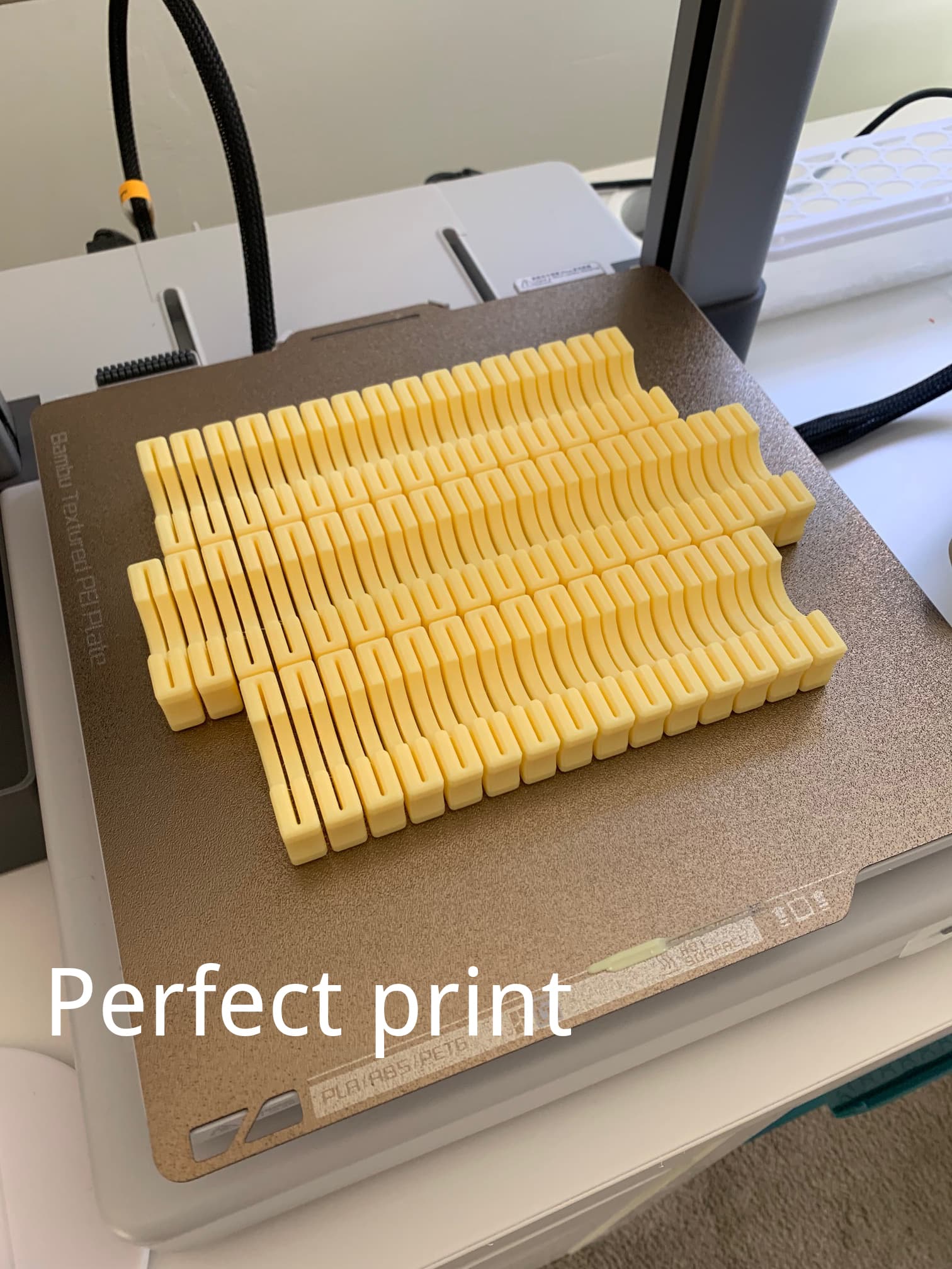

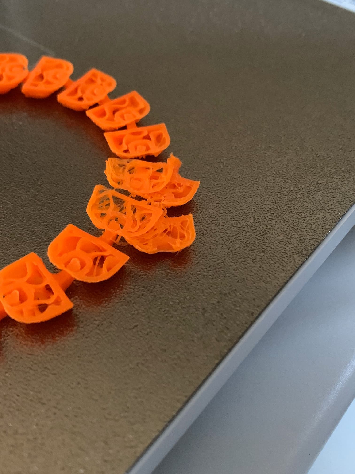

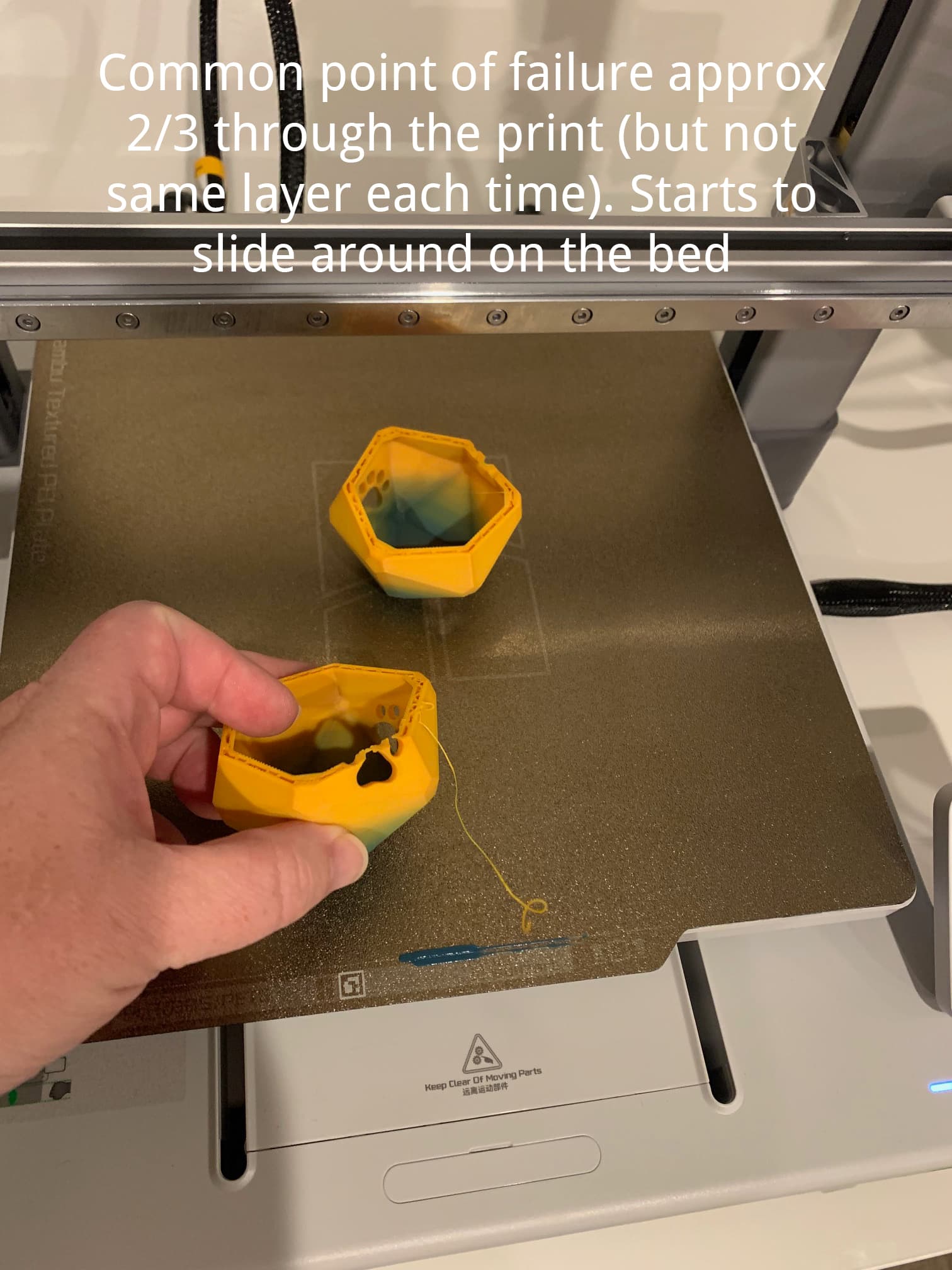

Hi there! New to 3D printing but have put in many, many hours printing and experimenting (read troubleshooting) since the A1 with AMS Lite arrived.
Initially, prints were working beautifully, all different shapes and sizes, primarily printing with Sunlu PLA, PLA+, PLA+ Silk.

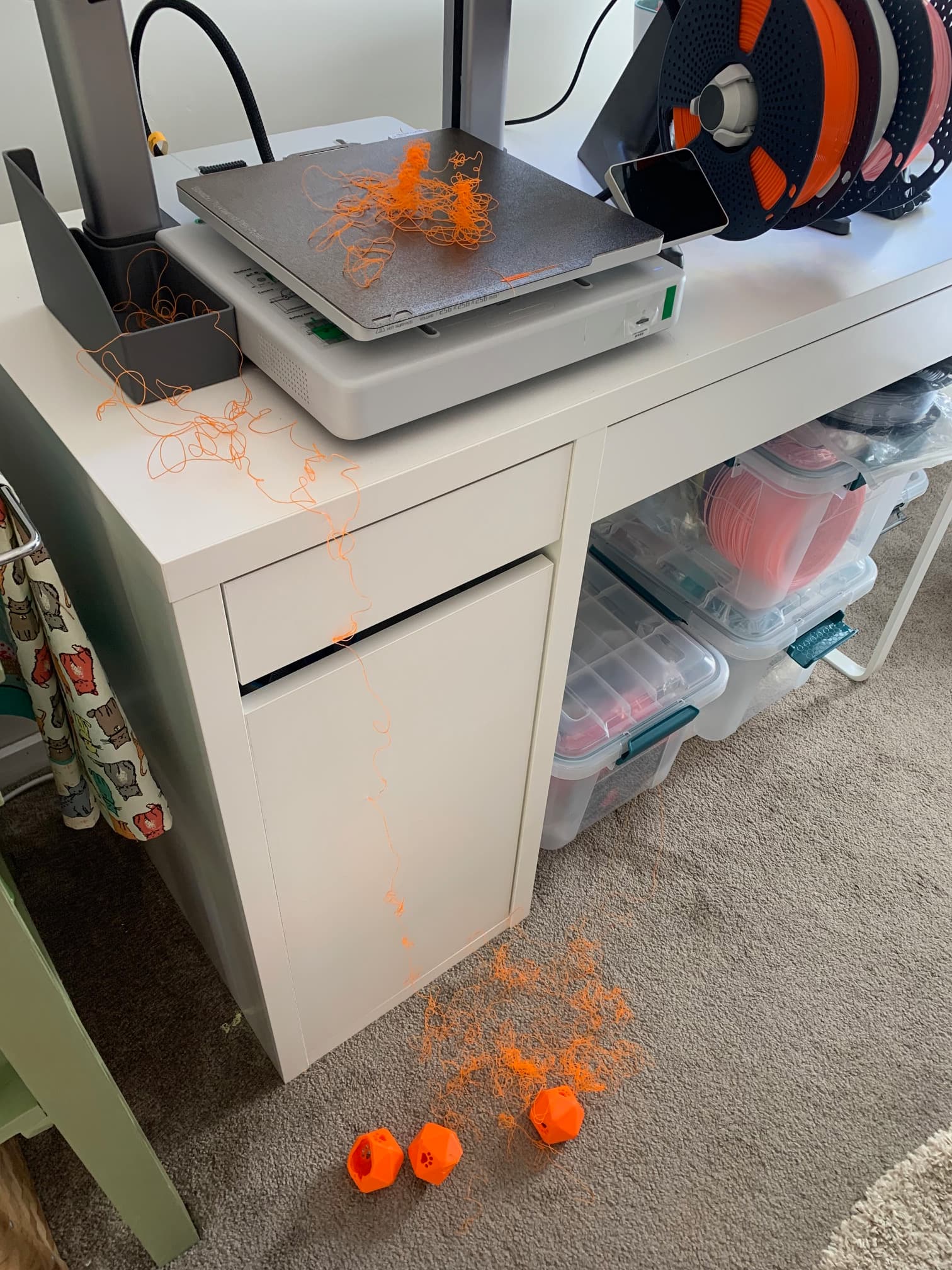

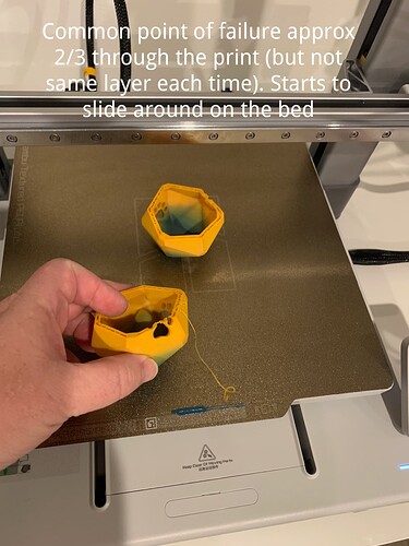

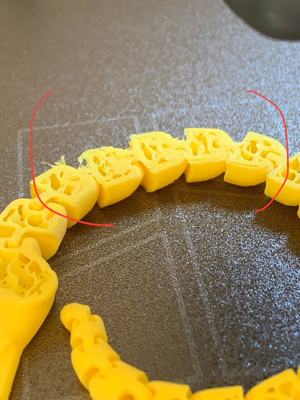

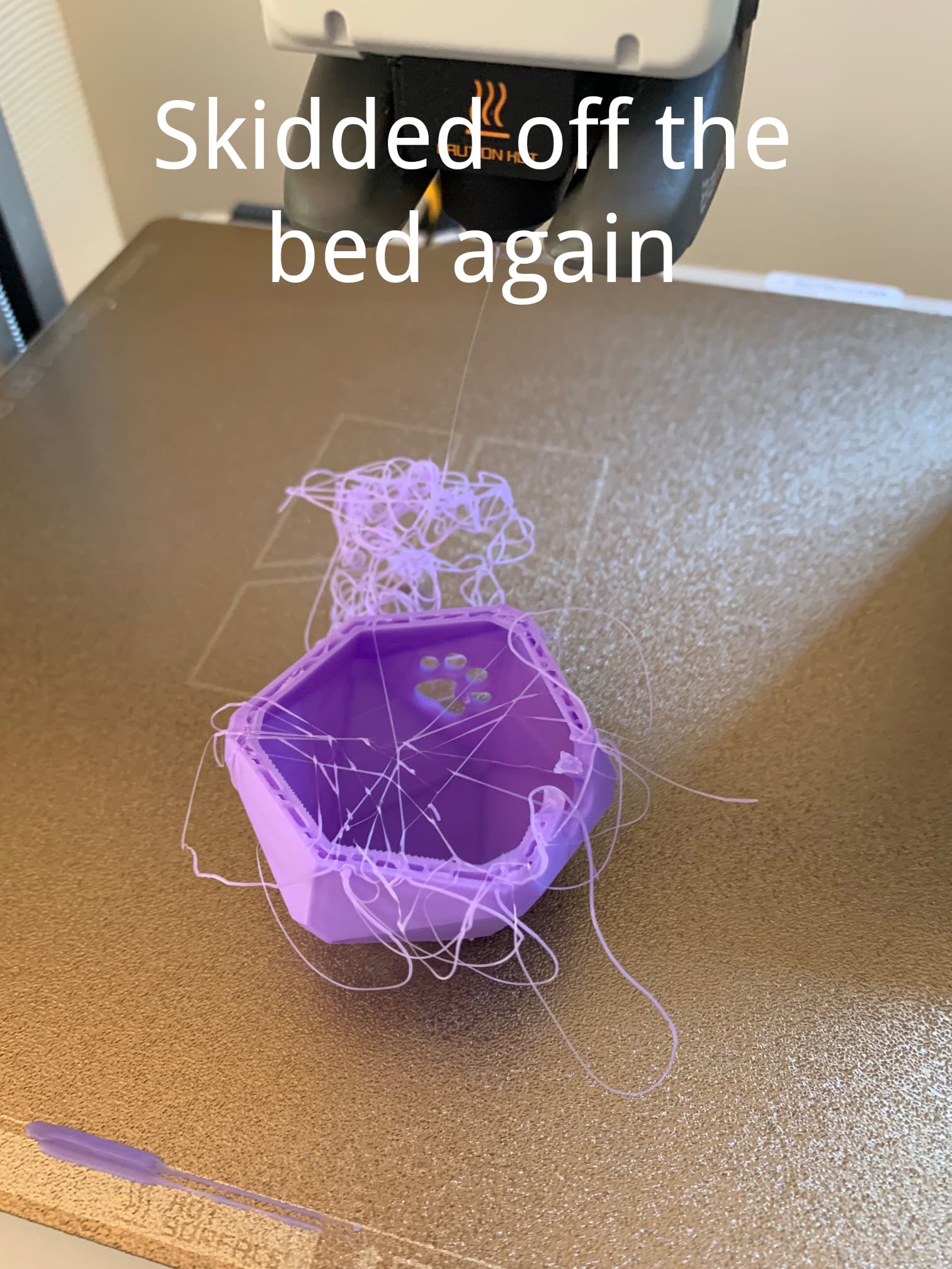

Things have gone downhill with regards to bed adhesion and prints failing/skidding off the bed partway through the print (but not at exactly the same point). I have included a bunch of photos to illustrate the issues I am having.

  • I have supervised scores of prints, repeating the same couple of items over and over, with incremental changes to the nozzle temps, bed temps, and some speed settings (although as I am new to Bambu Studio I am being mindful that I am not fully across the speeds)

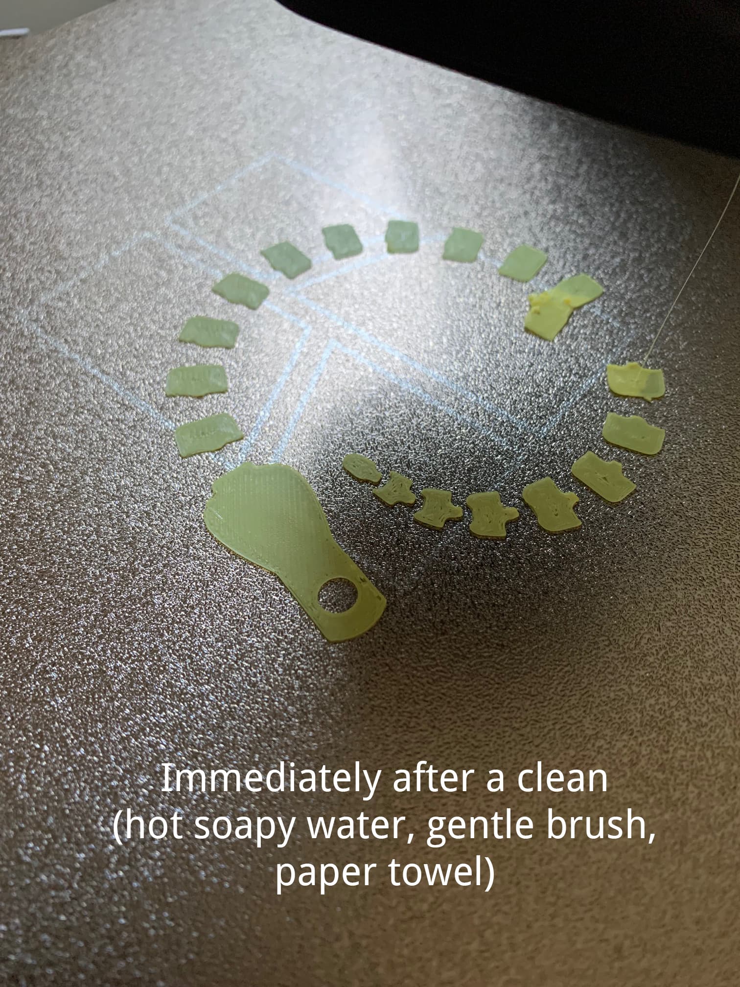

Don’t worry about clogs or anything, it’s just a issue with a “dirty” plate. (Try not to touch this kind of build plate with your hands or the adhesion will get bad due to oils from your hands) Soapy water isn’t enough, you need to put dish soap on it and scrub it with a very small amount of water, then you can rinse. The point of the dish soap is to latch onto the particles that are causing the bad adhesion then rinse away with those oils.

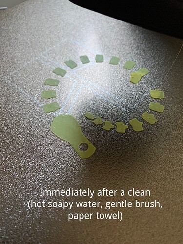

Sorry, I should have clarified that the ‘soapy water’ I am using is in fact dish soap. I have tried a couple of different brands (and checked that they don’t contain oils etc). I really hope this is a ‘dirty’ plate issue, as I feel like that is something I can keep working on!

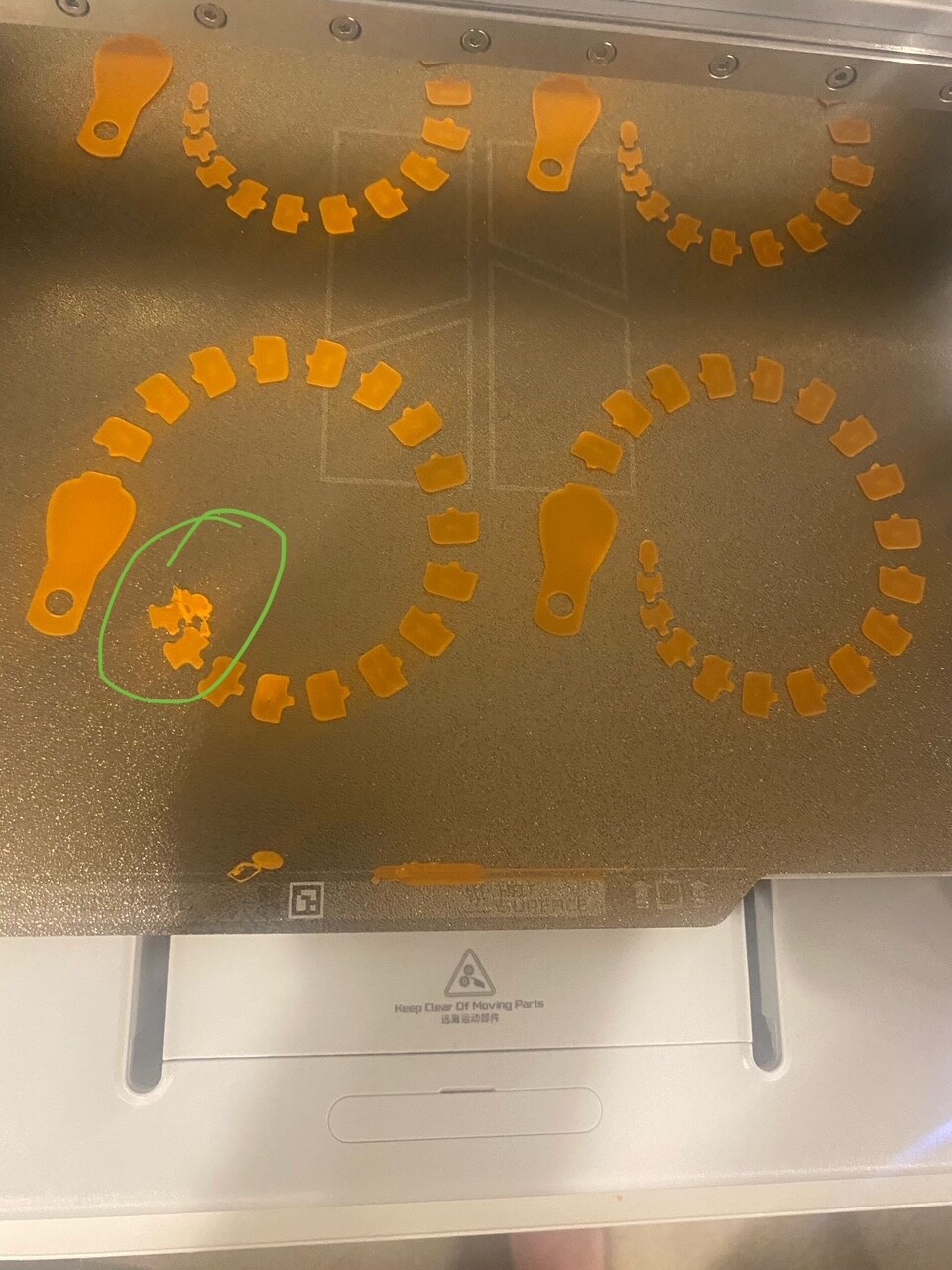

I just did my first print on the other side of the plate, which theoretically hasn’t been touched, except for the scrub that I gave it beforehand.

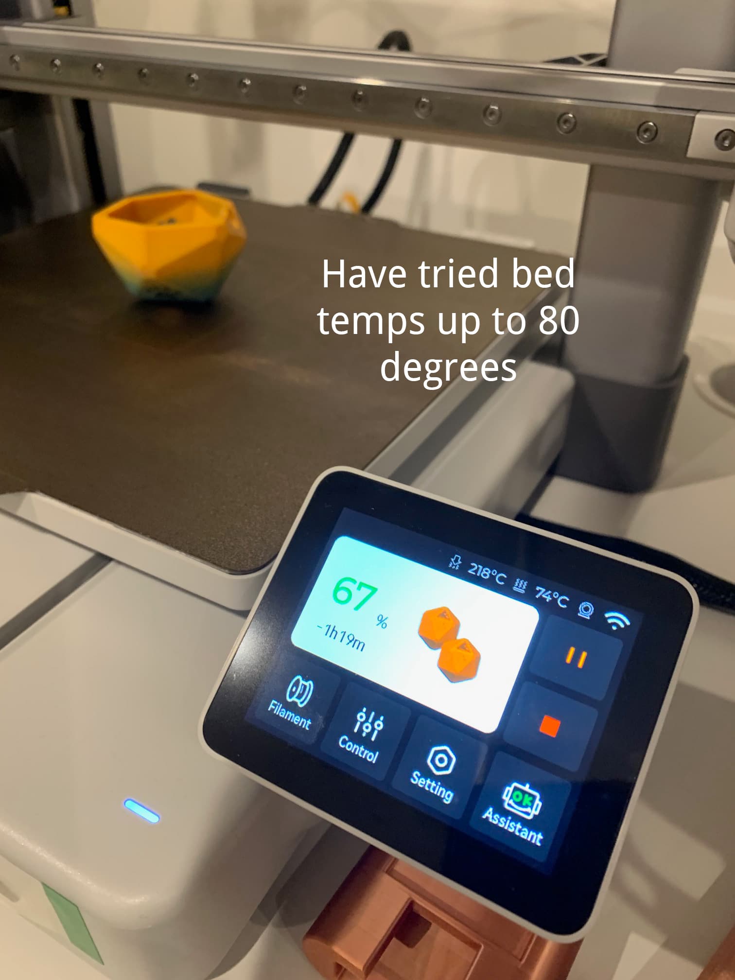

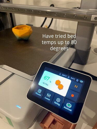

The result was these parts coming loose and ruining the print 75% of the way through. I heard one piece click loose so I immediately increased the bed temp to 80 hoping to help the print hold on, but adjacent parts kept coming loose

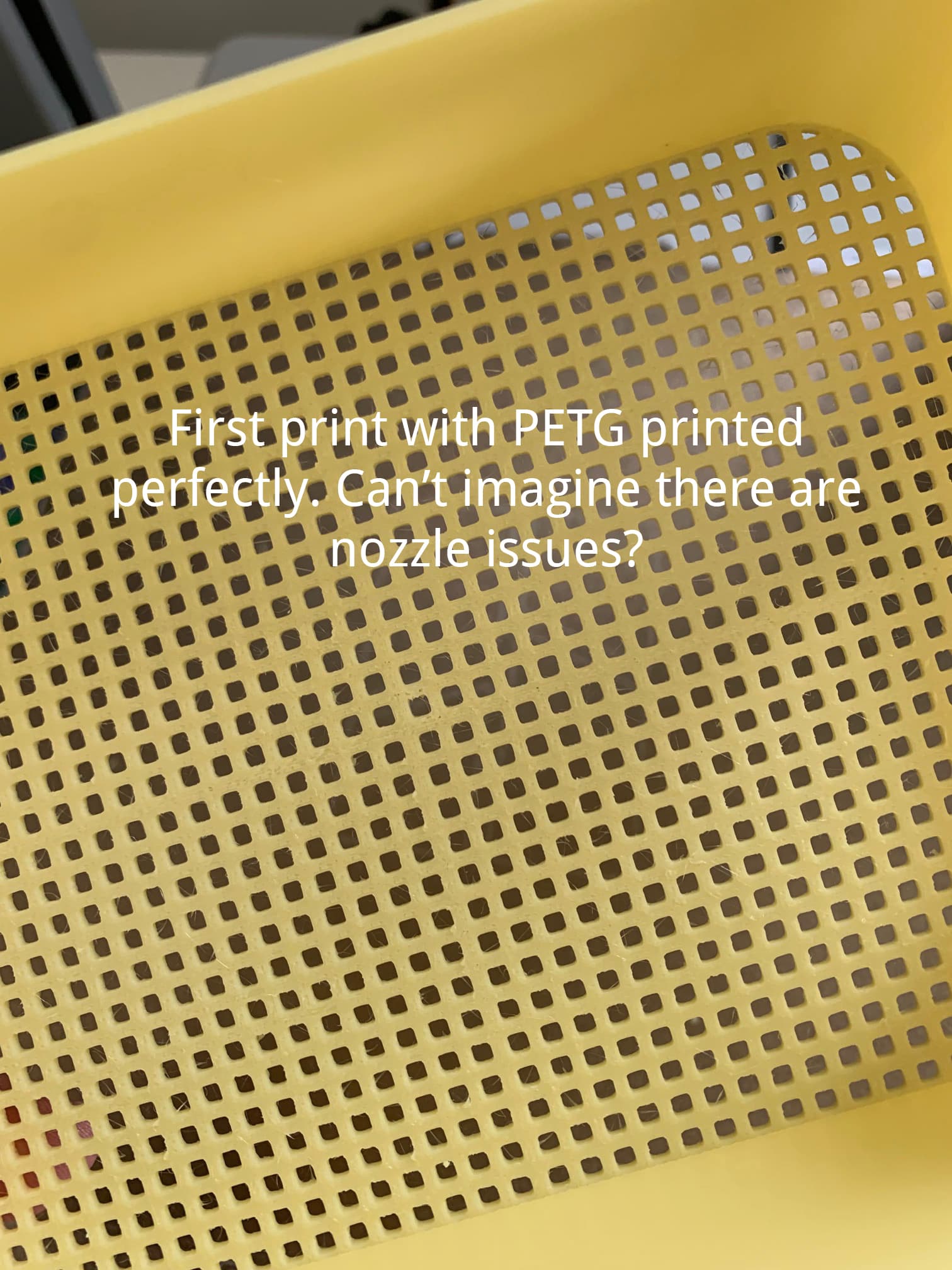

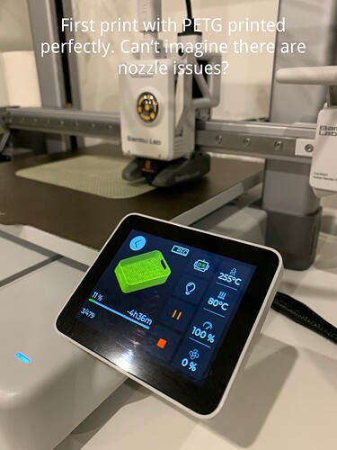

Have you printed anything besides regular pla, like glow in the dark or something? I’m wondering if maybe the nozzle is damaged and extruding filament unevenly and then hitting those parts. Happened to me once after printing with marble filament and a standard nozzle.
Amazing! I have just ordered one, thank you!
I have printed the yellow glow in the dark at the manufacturer’s recommended temps and it printed just fine (this was early on in the journey). The hotend has been changed since then due to the blob incident, to the hardened steel 0.4.
.postdeletedinprotestofdangerousgoods.
Did you change the nozzle type in the printer settings on the machine?
Yes I did, thank you for checking :slight_smile:
I think I was probably underestimating the level of scrubbing that I should be doing between each print, and my print success has greatly improved since I stopped wiping with alcohol!
Can you tell me what you would recommend to clean the Bambu 3D effect plates? I have purchased a couple but haven’t used them yet. Is using a soft plastic scrubbing brush (with the dish soap) likely to damage the surface? The surface obviously doesn’t seem as durable as the PEI plate
Yeah the thing with wiping with alcohol is that it doesn’t really do much. It mostly just smears the impurities around with the alcohol, then the alcohol just evaporates leaving the impurities. The effect sheets should be cleaned with hot water and a small amount of dish soap. They are considered consumables and you should try to clean them gently. I doubt it will damage them to clean them a few times but I think the best solution is to just avoid touching them unless necessary. BTW you can replace just the film if they are worn out.

Try raising the bed temp by 5-10°C and adjusting the Z-offset. A light glue stick layer can also help with adhesion. Hope this helps!
