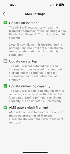

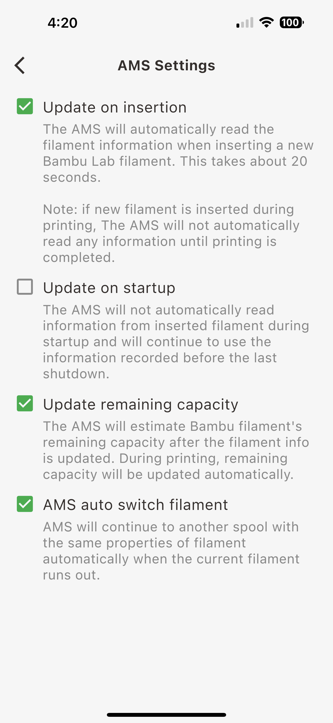

Yes it can do that. It’s in the Settings → AMS settings in Bambu Handy. Auto switch filament
I think type and color have to match. And there’s an order it follows I think
Yes, it will continue printing with any other spool that has the EXACT same settings. Earlier software versions had a bug where it would only change in order from left to right in the AMS but that is fixed now.
