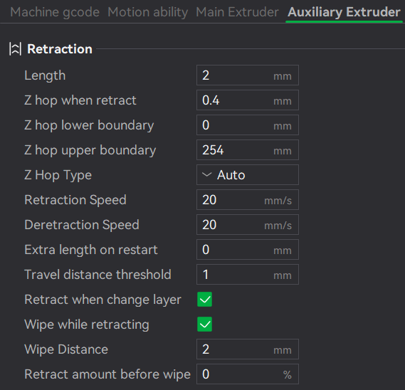

I did actually just check out of curiosity in the printer settings for the Aux extruder retraction setting and it does seem to be higher than the main extruder, at 2mm.
I reckon I’m gonna up it to 4-6mm because 2mm seems really short for a bowden. The retraction and de-retraction speeds do look good at 20mm/s so props to them for almost getting there :smile: .
But what is the retraction in your filament preset overrides? I habe a bunch of filaments based on the generic filaments and the main/aux retraction is the same…
