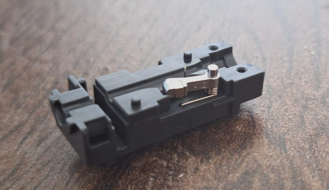

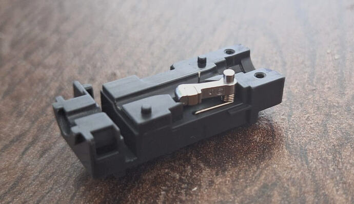

Hello everyone, OP here.

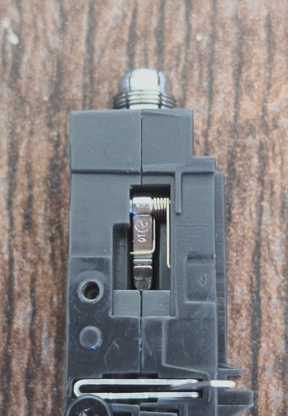

I just finished tinkering with the X2D, and I FINALLY managed to solve the issue. Apparently the spring inside the casing for the Filament Cutter was positioned incorrectly. When I saw the corresponding Troubleshoot Picture, I noticed that the little Lever inside pushed back once the filament was pulled out, whereas the Lever in my device didn’t.
I opened it up again, and positioned the spring in such a way that the lever bounces back again. After putting everything back together, the Filament is finally loading quickly again! Because the Lever didn’t move, it permanently signaled to the printer that there already is Filament in the toolhead, which is why it moved so slowly.
Here is the part with the spring installed INCORRECTLY:
And this is how it’s supposed to look:
As you can see, the spring is behind the lever, towards the opening - not towards the inner casing.

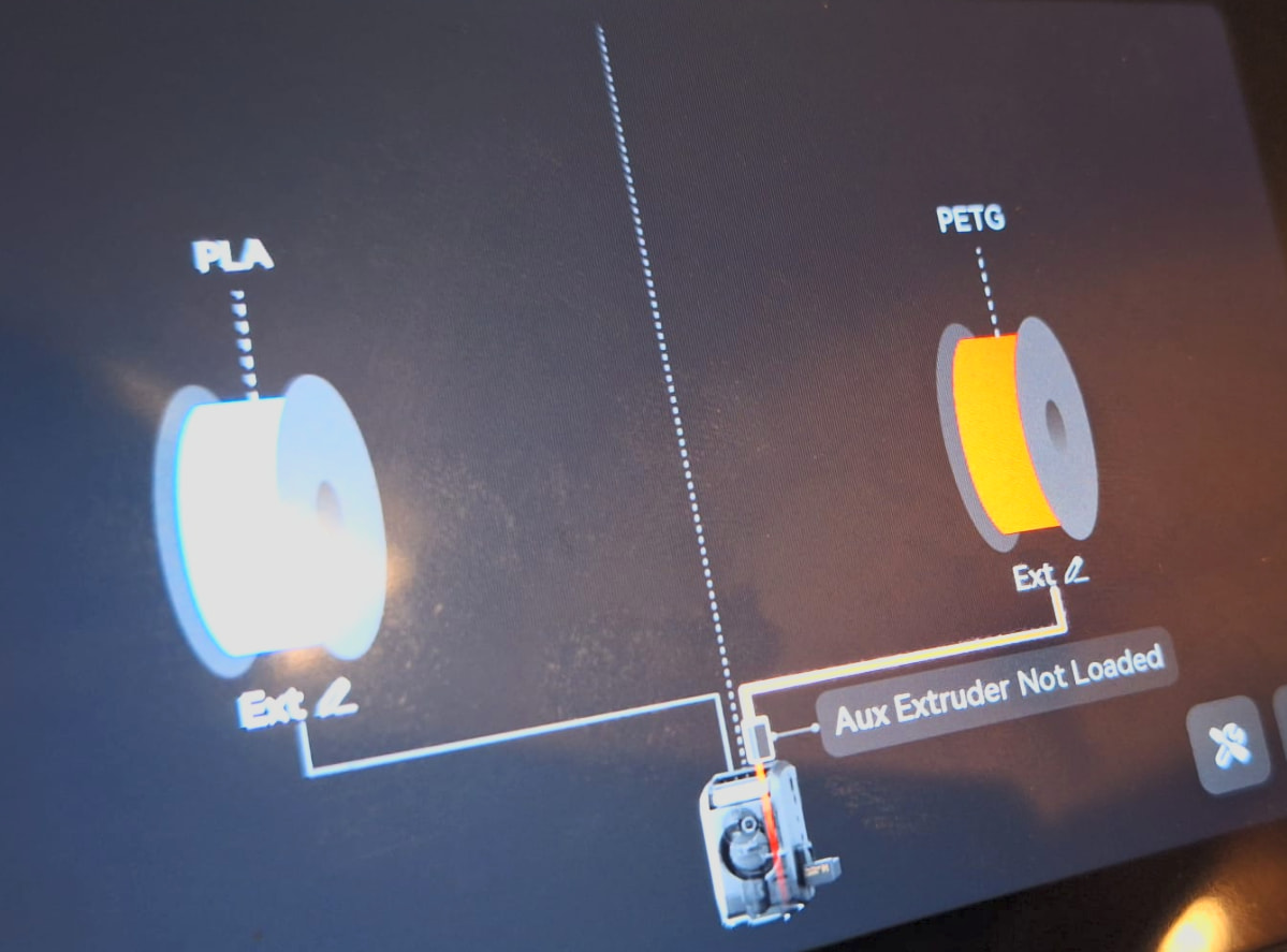

I realized that there was something wrong during the troubleshoot, because the printer displayed the Aux Nozzle as “loaded” even though it was empty. You can see that the red line indicating the filament is still in the toolhead.

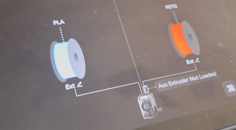

This is what it’s supposed to look like fully unloaded:
