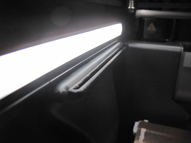

You can change it in a custom filament profile. I prefer to just use a deflector so I don’t have to remember to change profiles.
This is crazy, why are Bambu having default filament settings that destroy prints.
I’m having to go it and change it every time now. I dont know what deflector is?
This is the one I use, it just deflects the air up…
Oh! I was thinking it was some software addon. Cool, thanks :smiling_face::v:
