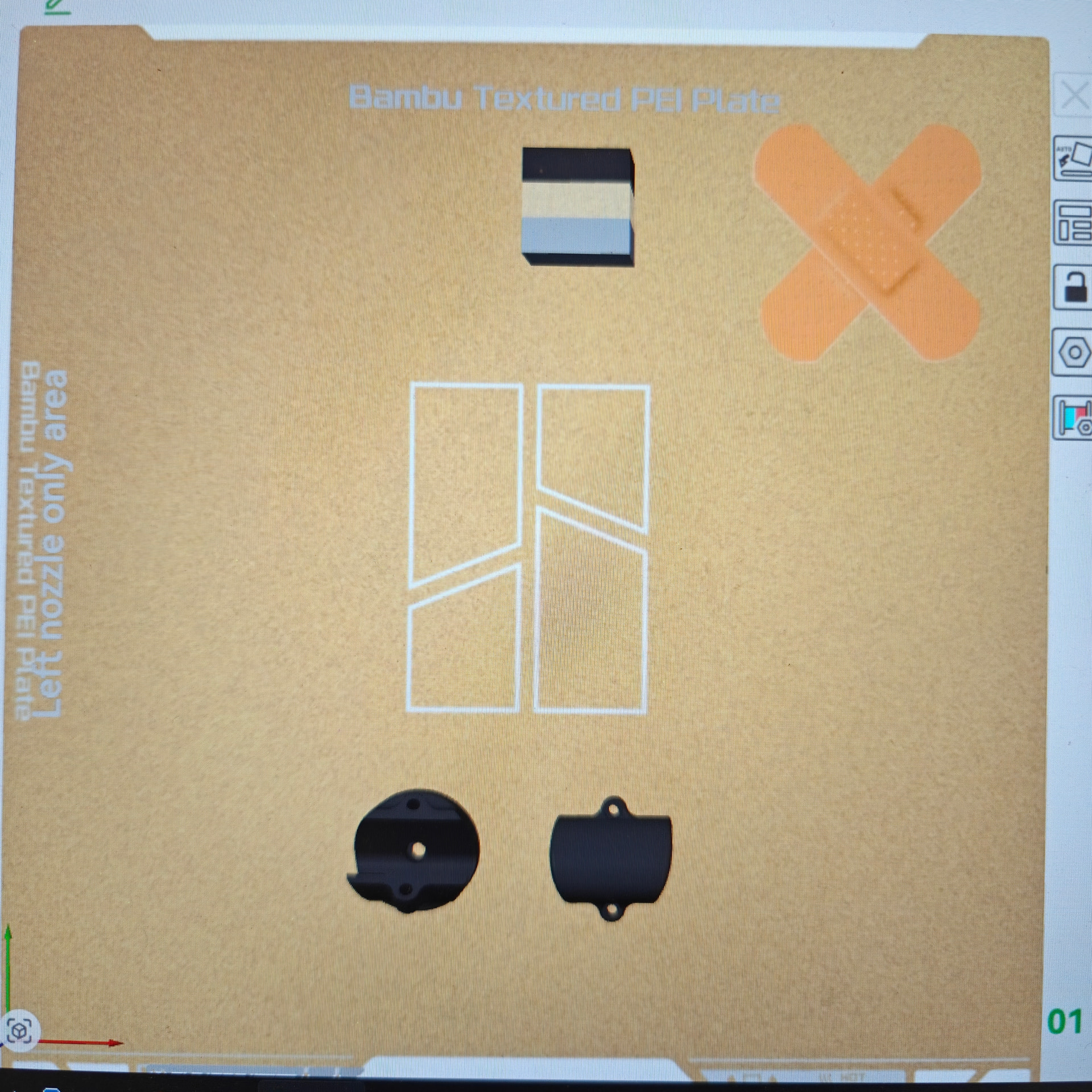

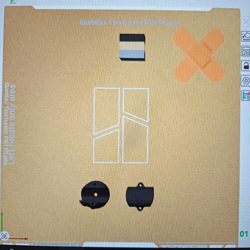

One thing you could do is set up a custom machine profile, that allows you to set an image as your build plate. You’d just mark the image file with the area you want to avoid prior to uploading.

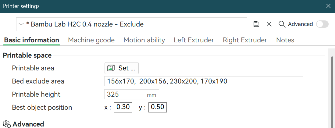

You can define that area in your printer setting under “bed exclude area”. Unfortunately you can only define one area.
You add the corner coordinates of the area as follows:
You use A, B, C, D locations in X and Y coordinates and you add them in the bed exclude area of your printer settings. You save that new printer settings with a new printer name that you will use when you select your damaged plate.
The format in the exclude area will be XAxYA, XBxYB, XCxYC, XDxYD
XA being X location of A, YA Y location of A etc…
Example on my H2C:
A is at (XxY) 156x170
B is at 200x156
C is at 230x200
D is at 170x190
Syntax is then 156x170, 200x156, 230x200, 170x190
Here is the input in printer settings

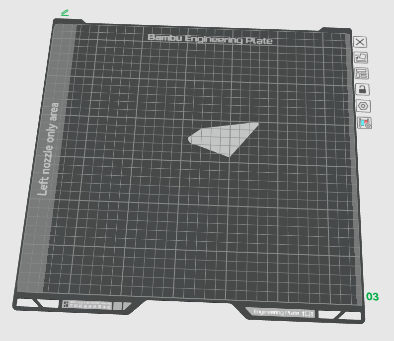

And the resulting area in prepare and preview tab
Again, you can only define one single area and sometimes, you get rounded corners like in my example or strange non linear or broken curves so try do your your best with the coordinates ![]()

From the Prepare tab, you’ll go to Printer Settings by clicking the little edit pen icon to the top-right of the printer.
In Basic Information, hit Set next to Printable area. Leave the shape and size alone, and load a texture - that will be your new plate image:
