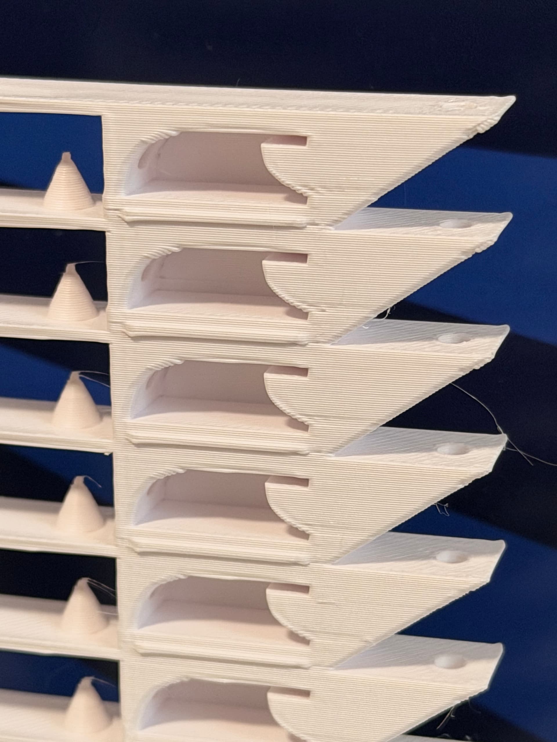

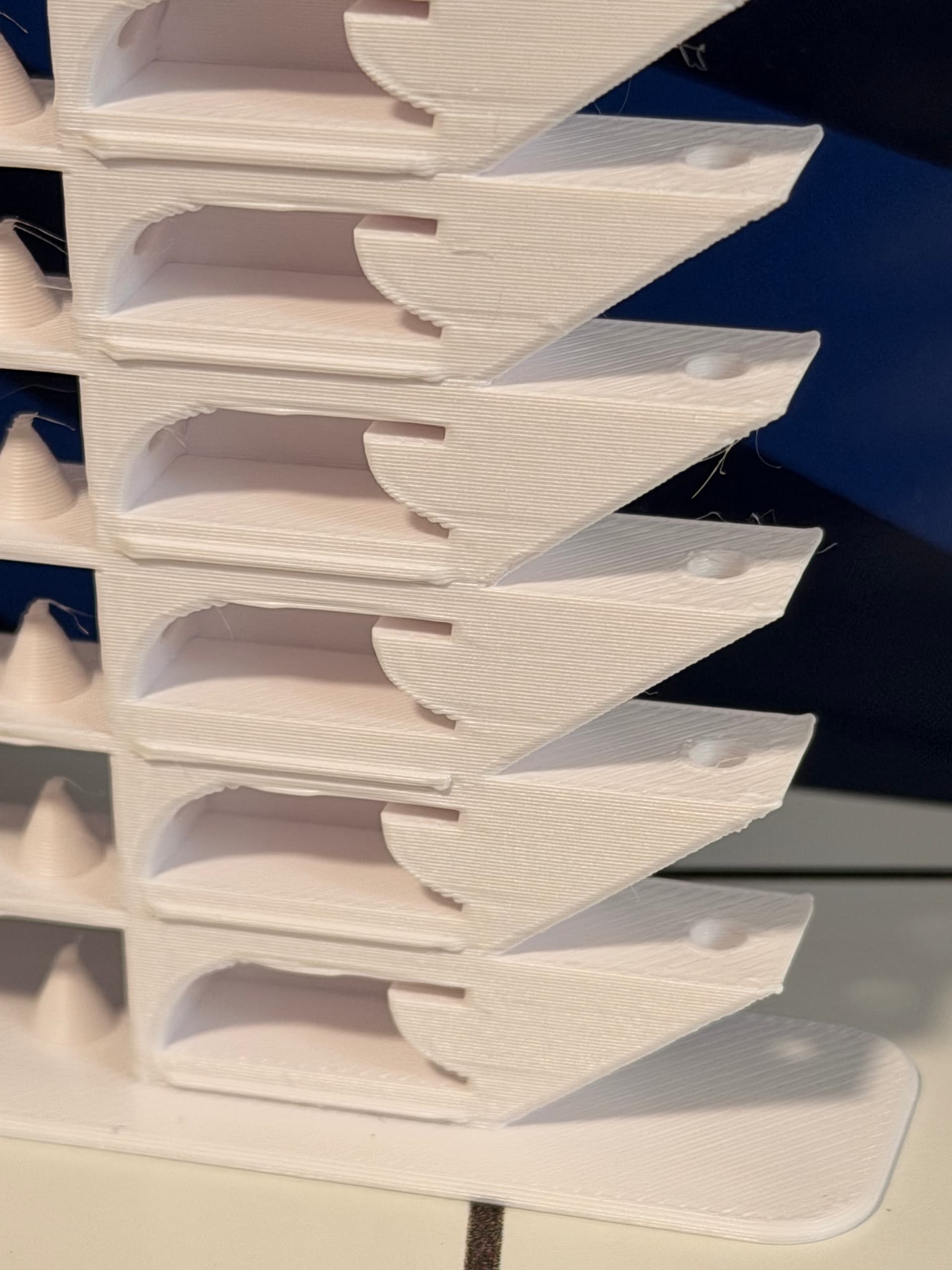

Jumping on this thread to ask my own questions about bad pressure advance with Bambu PETG-HF on an H2D.
To set the facts:
I’ve done a 8 hour dry on all of the PETG-HF loaded in my AMSes in my AMS HT at 75 degrees.
I’m printing on 0.4mm Hardened High Flow nozzles.
The machine prints PLA just fine - so this feels like a material profile calibration issue moreso than a machine issue.
and I’ve done all of the calibration steps, including automatic and manual flow calibration, landing at a 0.033 K value.

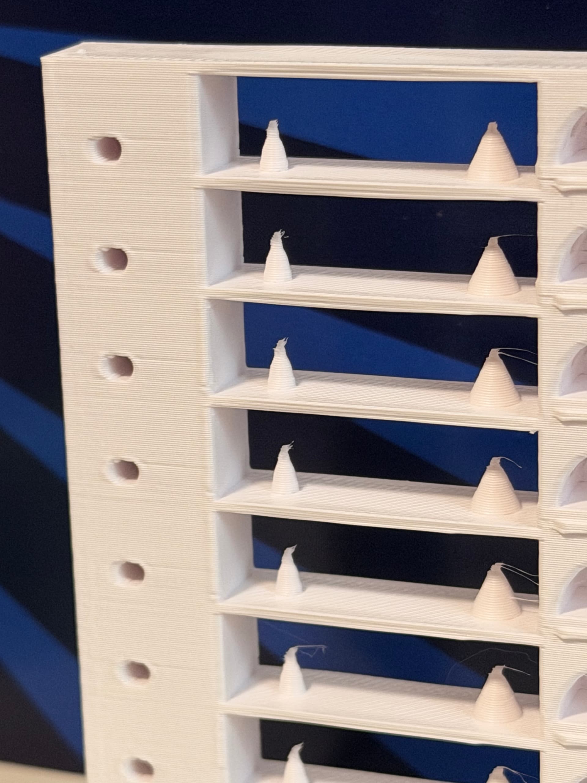

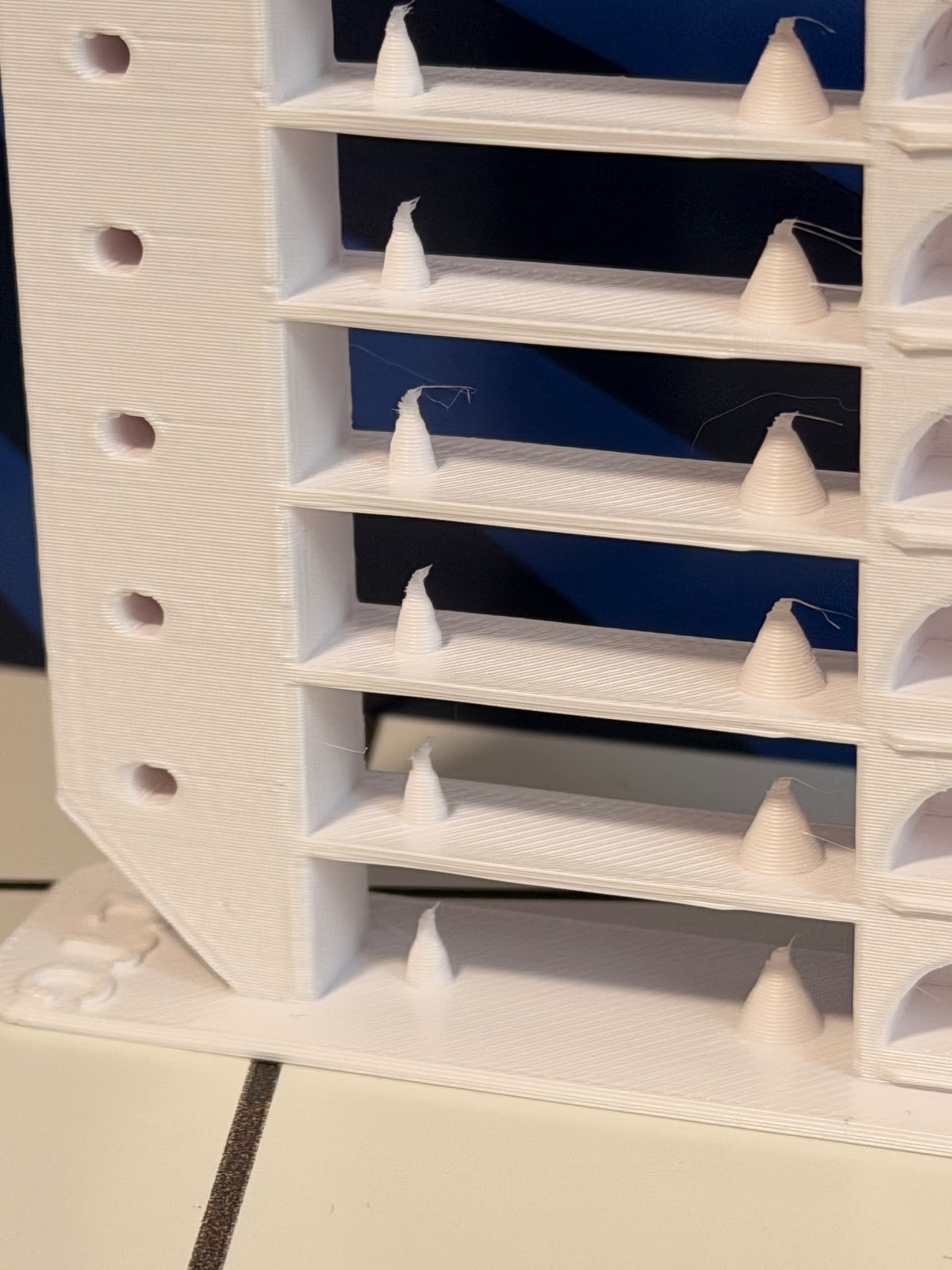

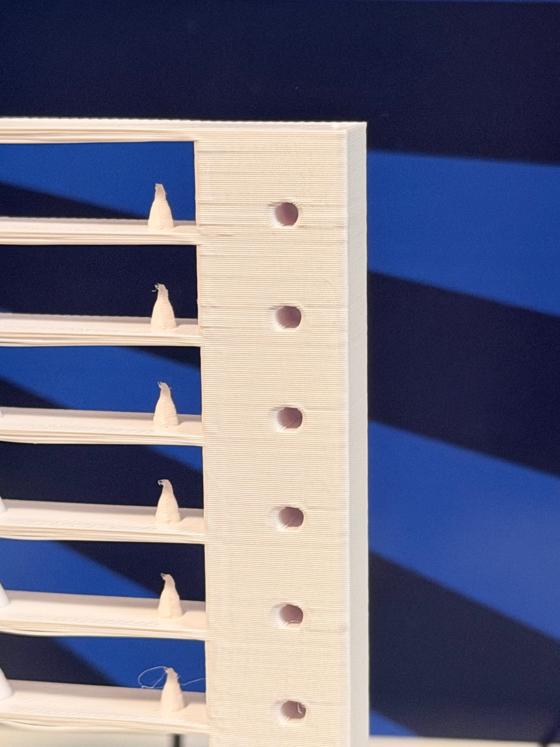

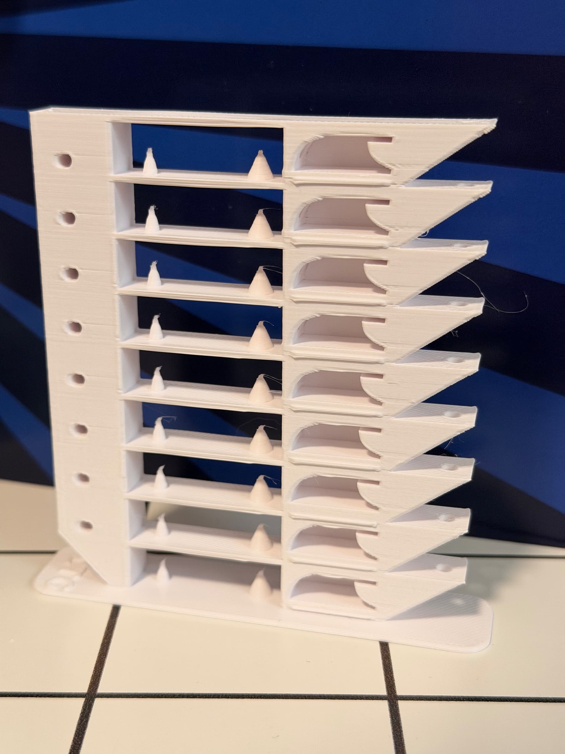

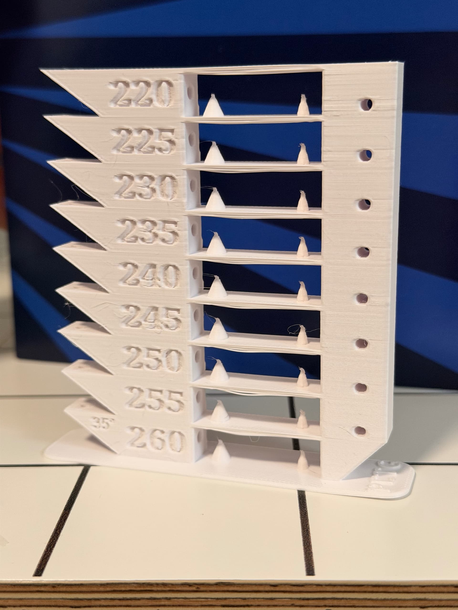

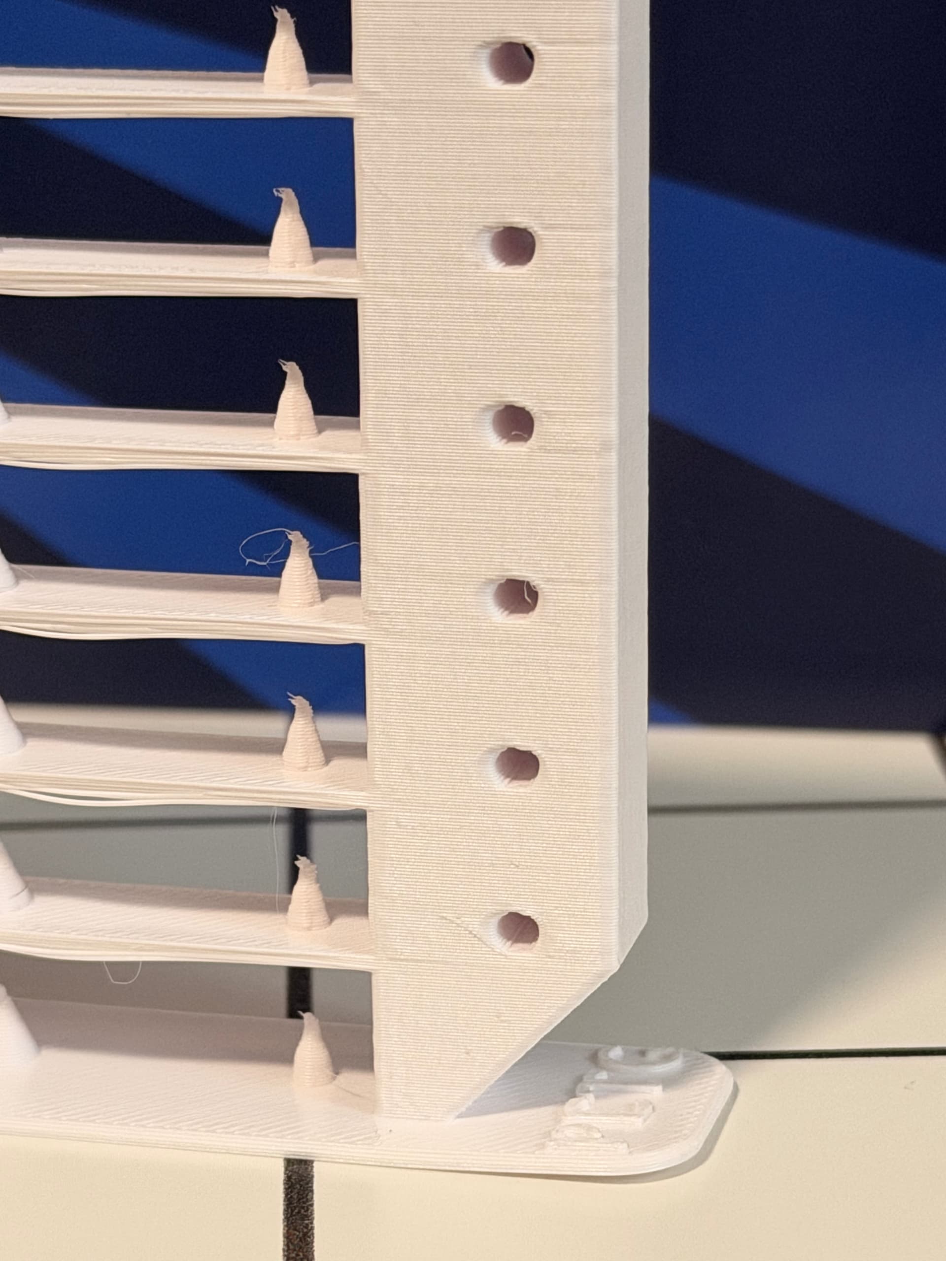

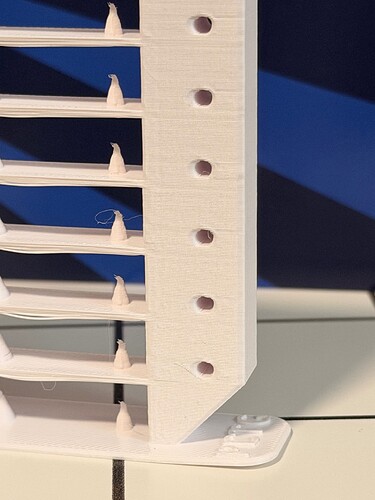

I printed a temperature tower to see how various settings would be affected by different print temps, and to see if I could get some help on this forum! I’m not sure what I’m doing wrong - printing at a higher temp seems to definitely help, but should I also slow down the print to eliminate some of the artifacting/lumpiness I’m seeing on the front?
Front of tower:
Back of tower:
Production part - less concerned with bed adhesion problem than I am with the lumpiness/skipping around the corner… this was after running a Pressure Advantage test and setting an appropriate K value.
Many thanks – the responses in this thread have already been enlightening, so I’m really hoping some of y’all kind folks could point me in the right direction :slight_smile:
