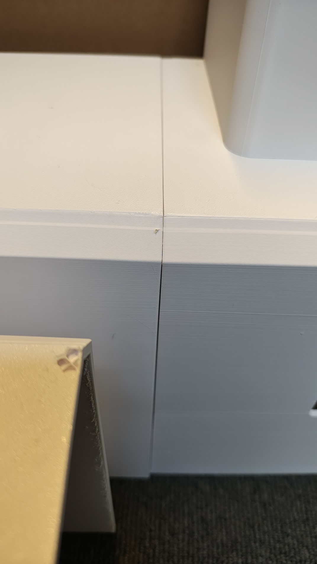

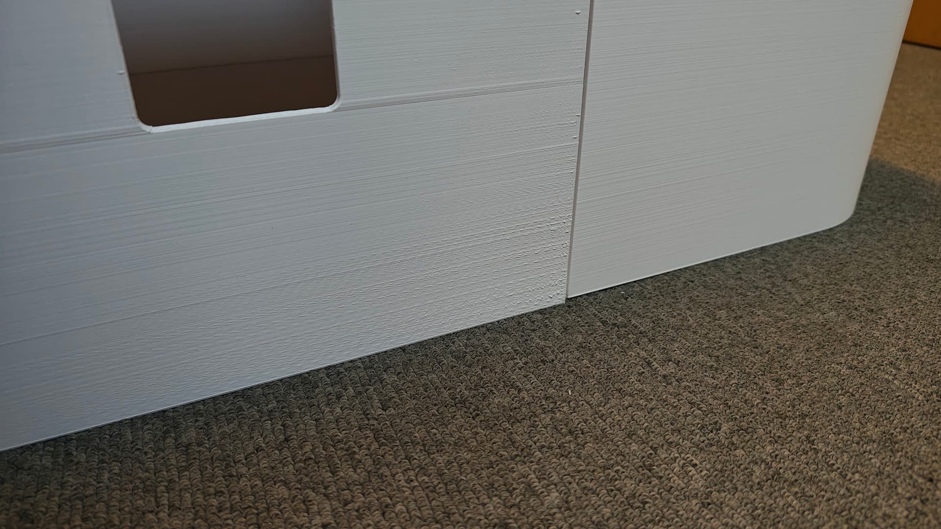

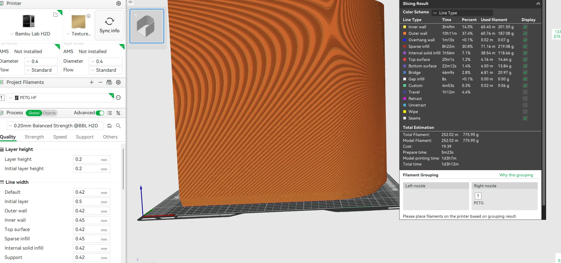

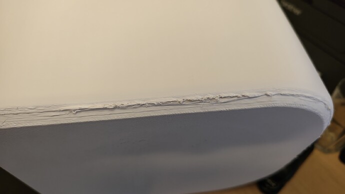

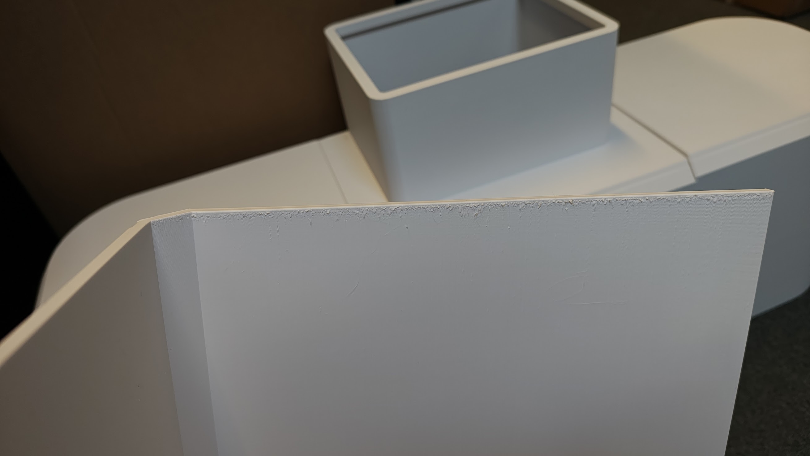

We purchased an H2D for our company. From the outset, we have been trying to print certain components for a new product prototype. We even changed the design for 3D printing because the printer couldn’t handle a radius of 20.
The strangest thing is that I printed a test of a cut-out fragment of the same object, and it printed perfectly!

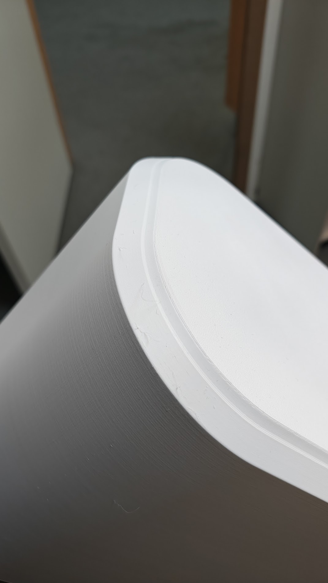

Unfortunately, full prints with Bambu PETG HF dried filament are terrible, nozzle 0.4 layer 0.2 Bambu profile for . While I can understand that height can affect quality, H2D is much more expensive, also due to the double bearings, which are designed to ensure the quality of high prints.
Here, the quality is nothing like a good printout.

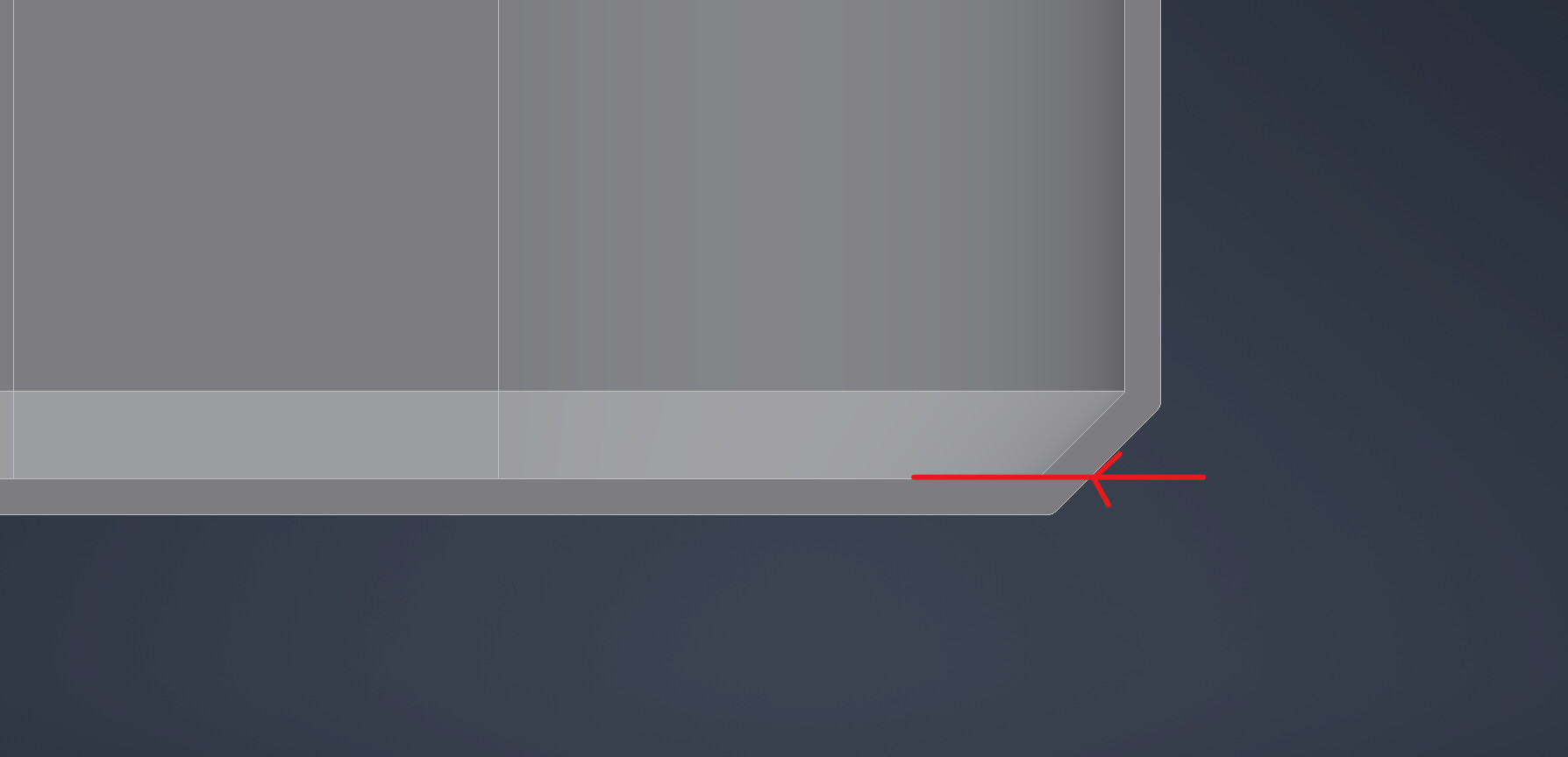

I used a 15 mm chamfer, so there shouldn’t be such a jump in the print, right?
Do you think I should create a ticket and report the machine?
Thanks in advance for any answer.

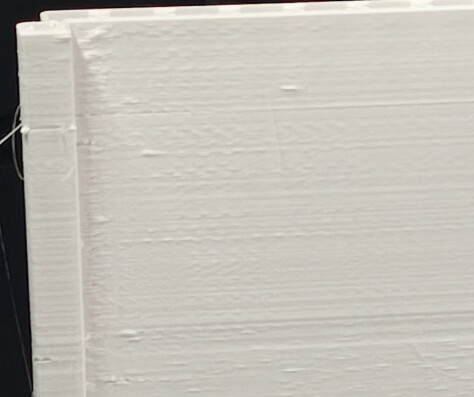

I don’t know if I would call those prints “awful”. The model/settings could be tweeked for a slightly better result but there still are limitations with FDM.

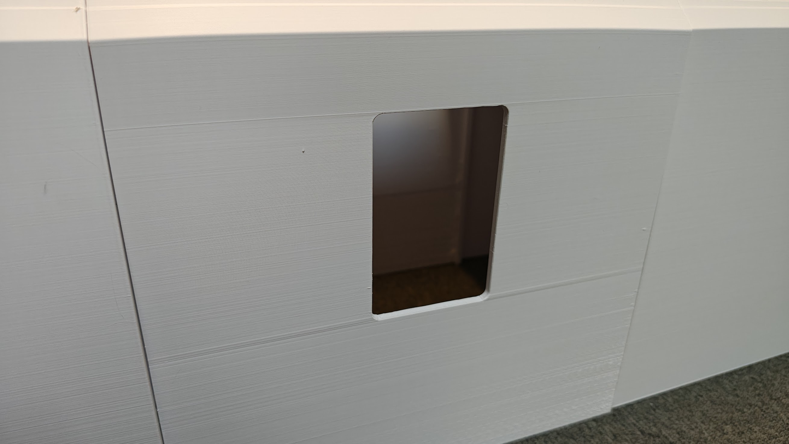

All in all, I was a user of Ultimaker and Prusa devices. I have been using Bambu for several weeks now. I have never seen such a print in a top-of-the-line machine before :slight_smile: Chamfer 15mm has never given such a result anywhere else.

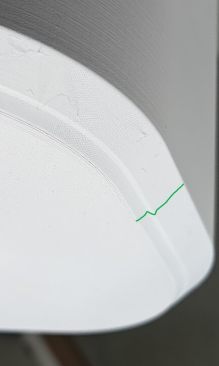

In this case, it would be understandable if the whole thing had some flaws, but here there is simply a jump. Any “windows” / holes in the printouts also correspond to lines around the entire object.
That’s why I call them awful :slight_smile:
The problems stem from speed and the FDM process. The faster you print the more of those problems show up.
For the chamfer, a simple change from 45 degrees to 48 degrees will make a big difference. Especially with some small fillets around the top egde.

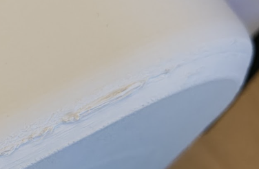

a few things that i’ve noticed already:

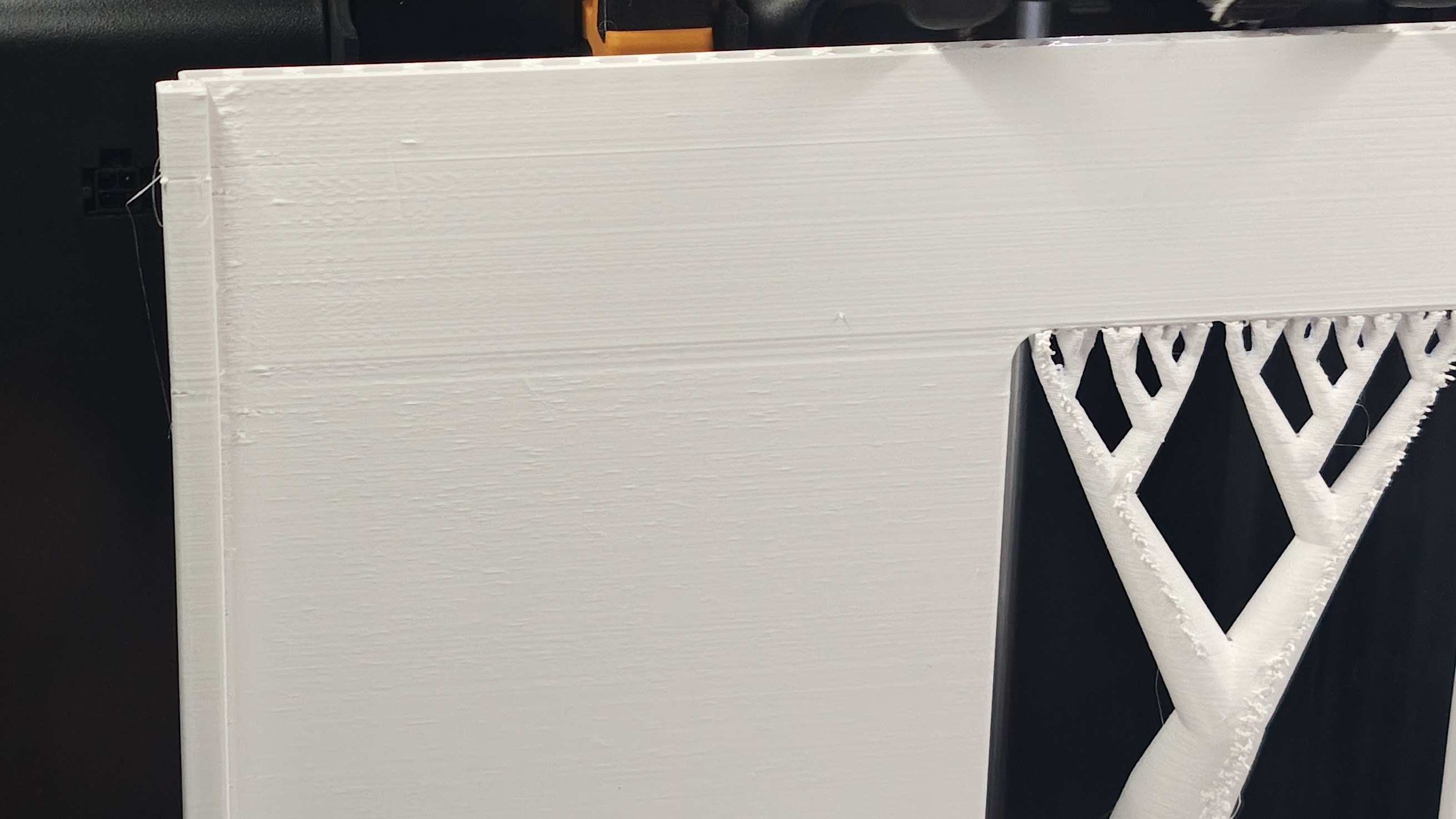

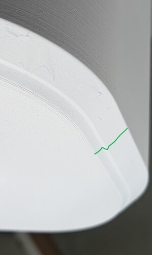

1. the filament is definitely still wet:
The uneven extrusion here is caused by either wet filament or bad Pressure Advance (Bambu calls it Flow Dynamics or K value)
2. you have bed adhesion issue; the part warped slightly near the corners.
This kind of line is caused by warp. The part warps lifted, and that blocks normal extrusion, which causes this ugly line over extrusions. This warp is commonly caused by bridging layer under large flat surface. To prevent it, either slow down printing, or use glue, or both.

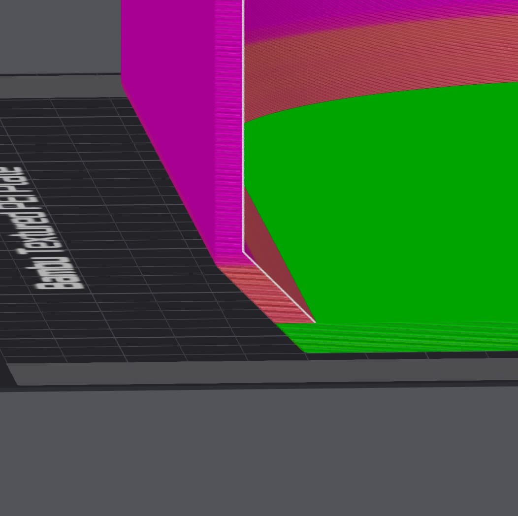

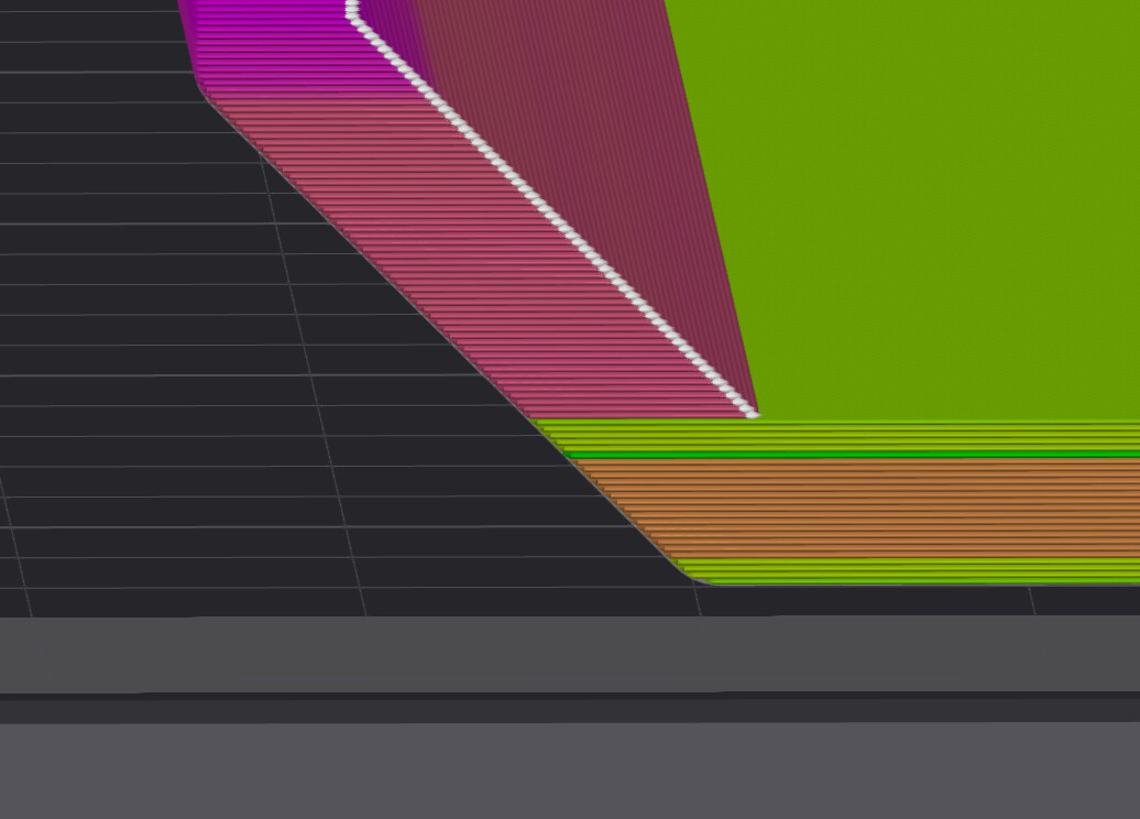

**3. Over 100% overhangs **
This is an over 100% overhang. There’s no fast printer can do this well enough. By over 100% I mean that at least one or two lines in the same layer has completely no support under it. So, it’s completely attached by inner walls in the same layer. And it won’t be printing well at all. And it would also introduce extra cooling due to slow downs and overhang extra cooling fans. So you would get weaker part, uglier part, and probably warped part.

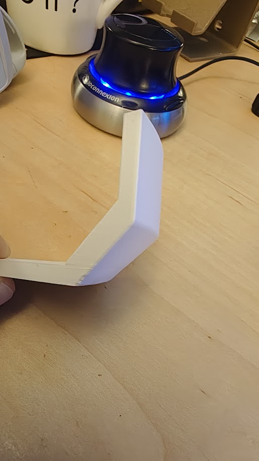

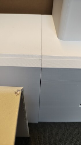

Here is a print of same part, but I did cut just a piece to see if chamfer is ok.
Thanks in advance

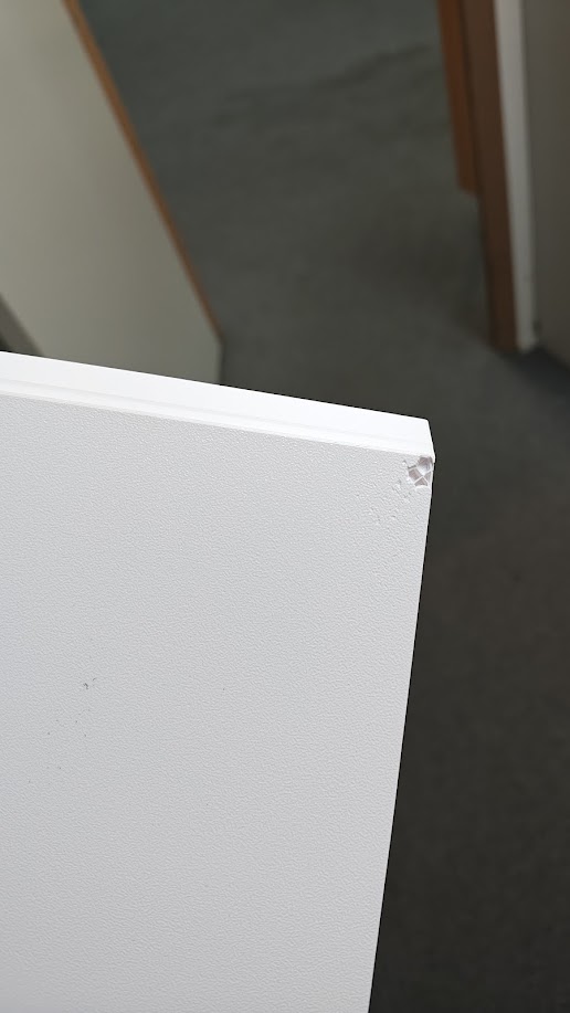

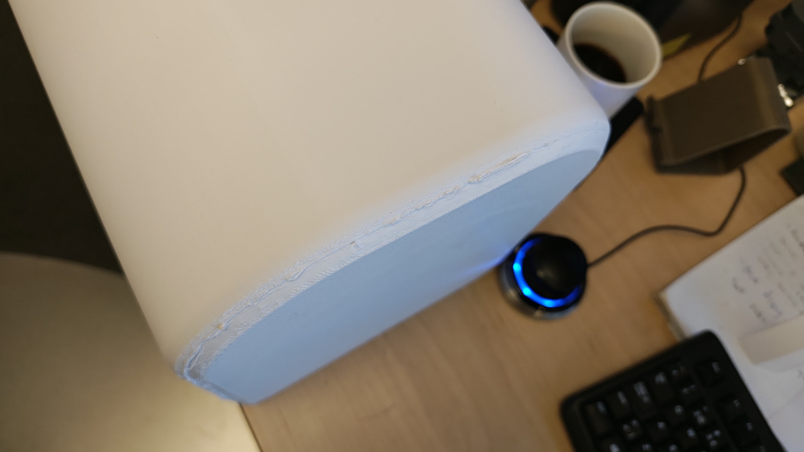

  1. Of course, that’s how it looks. However, there are two issues. The filament was new and dried immediately before use, and the second important issue is that this problem only occurs in the print above a certain height. Before printing subsequent elements, I dry the filament again according to your earlier recommendations.
  2. I clean the print plate before each new print. Every print sticks like crazy (see photo below). This print also had supports enabled! That’s why I find it very surprising.
  3. There should be no overhangs here. The slicer also did not show any overhangs.
    This change in line when printing is equal to the height of the base. Doesn’t that mean something?

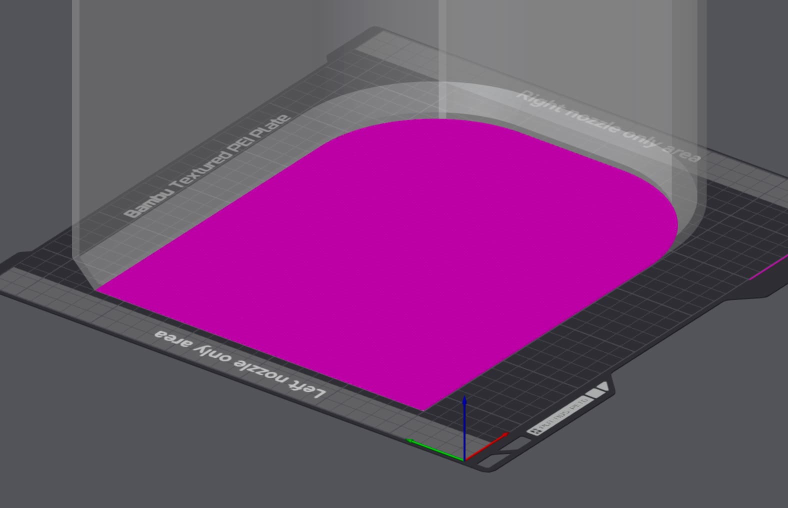

Here is a project, I hope that’s what you meant.
4x Skærm ben-print 2026 .3mf (115,8 KB)
and step if it will help
4x Skærm ben-print 2026 .stp.3mf (45,0 KB)
Yep. It’s caused by strong shrinkage. The pulling force in the corners are super huge

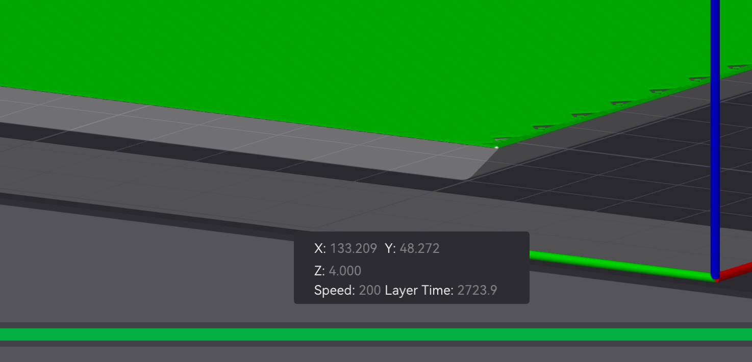

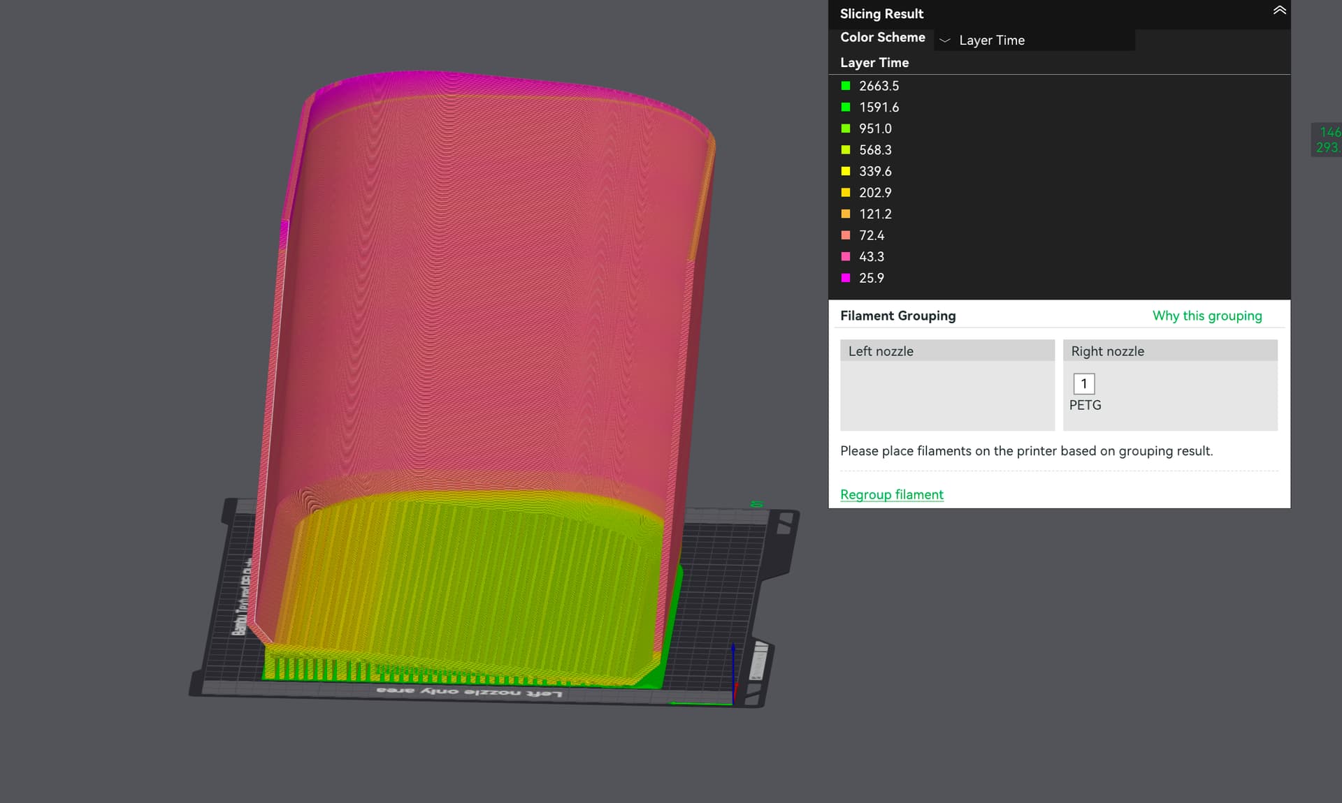

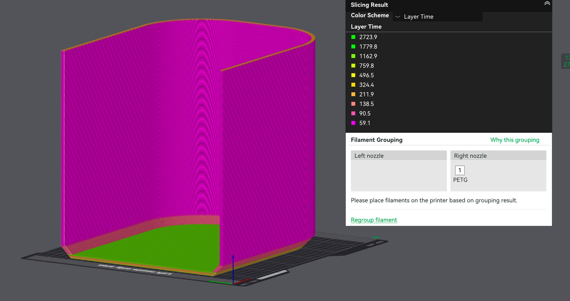

So starting from layer time view. You can see that the top surface layers are taking exceptionally long time to print.
The Internal Bridging Layer took a whooping 2800s to print, which is why it’s shrinking so much compared to other layers. The layers below the bridging layers only takes 190s to print. That’s more than 10 times of time difference alone. Then, it’s also blowing fan speed to 100%. The normal petg printing fan speed is 20%. So youre getting a huge ton of cooling from both high fan speed, and extra layer time, and extra layer time * extra fan speed. This alone causes massive shrinkage difference and can pull the corners upwards.

This is your original settings’ layer time view:
The main culprit here is that bright green bridging layer. It’s taking 2800s compared to previous layers’ 180s. As long as you can smooth this out, you would get a much better result.
So a slow layer above a fast layer is big no no. But a fast layer above a slow layer is fine.
Using this logic,

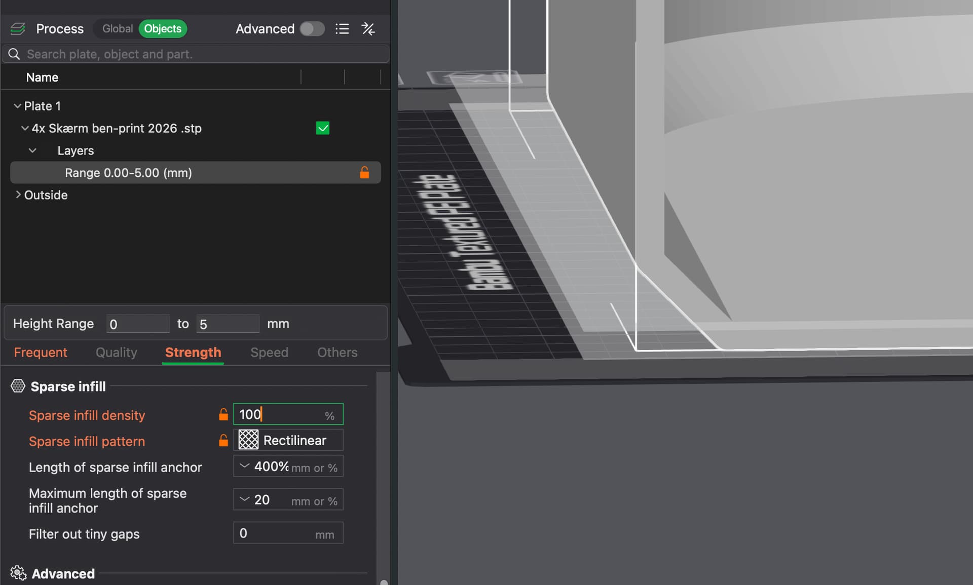

Instead of using default settings, for this one particular model, if you print the entire bottom at 100% infill, by using modifiers, you can set it like this:
Then you would get a layer time view like this:
The rule of thumb is:
Slower layer on top of faster layer = bad results. E.g., 2800s on top of 180s = bad
Fast layer on top of slower layer = usually not very visible E.g., 180s on top of 2800s = nothing serious
