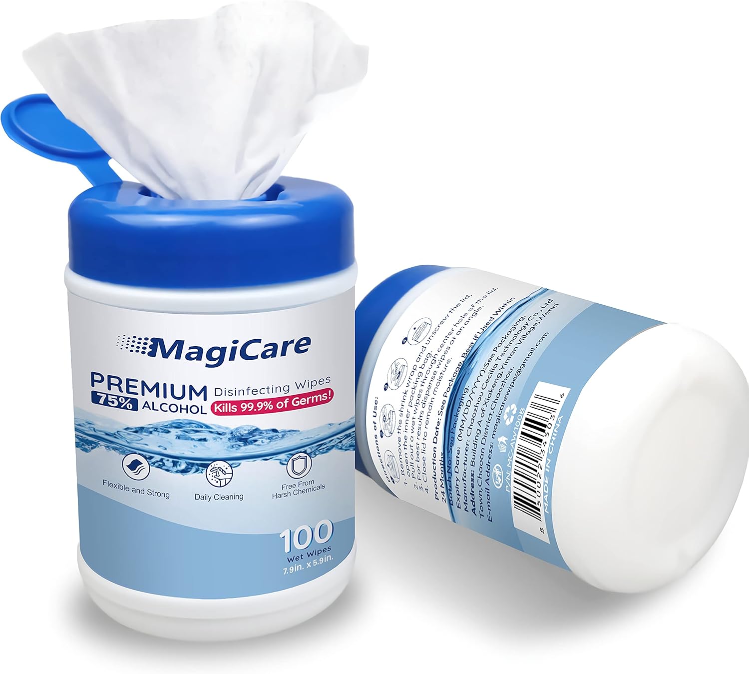

Do you think it would be ok to use Alcohol-based hand wipes like these? or no?
Alcohol wipes a nice and I often use them.
But be aware that there IS a lot to consider/test.
Those cheap, general use ones usually are Ethanol based, meaning they have to have something in it to make sure people won’t abuse it.
Added Methanol is no problem, added bittering agents or such can be.
I buy the smallest possible packet size if there is no chance to check them in store and try them on a clean mirror first.
If all the wet stuff dries off with no visible residue the wipes are good.
And haze, streaks and rings from dried off droplets mean I use them for other things and find a different product to try.
Those alcohol wipes that come with IPA (isopropanol) on the label usually have nothing else but water added.
Does not mean all are equal or perfect for the job though as even some of these can leave a residue or haze.
If you already invested into a canister of IPA to save money and it is is not leaving any residue I guess the easiest option is to go with these ‘water only’ wipes for the extra sensitive babies/elderly.
Leave the pack open in a warm or sunny place and once dried up enough just add enough IPA to ensure all wipes are well saturated.
Good IPA wipes can be quite costly depending on where in the world you are…
And even than some manufactures provide IPA for just cleaning use, or worse rubbing alcohol that is IPA based.
Some of these come with additives, scents or such that will always mean you leave a haze on the plate.
Thanks for the reply! :slight_smile: I have not purchased any yet, I like your suggestion! :smiley:
