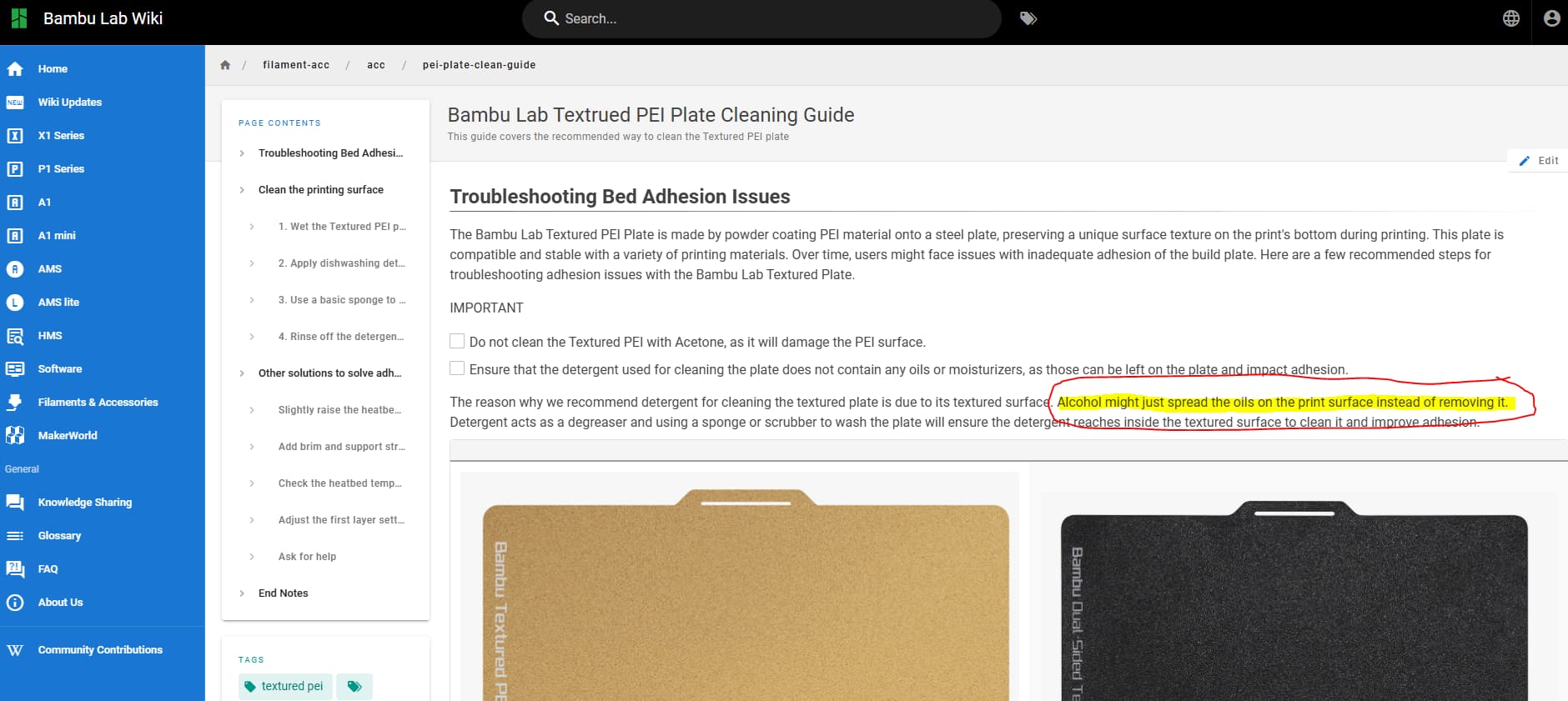

I have used dawn dish soap since 2012 as stated those were old printers before i got all my bambu printers… so since bambu launched i have used the same exact formula on my pei sheets and …oh look even the Wiki doesnt recommend alcohol…
here is link to wiki in case you ever want to learn the proper recommended ways… Bambu Lab Textrued PEI Plate Cleaning Guide | Bambu Lab Wiki

so reading your test that is “on the internet” doesnt always mean its right?.. gotcha… and i fully agree. I dont need a test when as I stated before I have 13 years of real life successful 3d printing experience…
Alcohol is an excellent degreaser if you use enough of it. Dabbing a little bit on a cloth and wiping the plate will just smear oils around. A good scrub with Dawn (US) Fairy liquid (EU) will remove gross contamination, flood with 98% pharmaceutical grade isopropyl alcohol or bio ethanol fuel (colourless) and wipe off with white disposable towel between washing works well. I was involved in developing cleaning very sensitive analytical instruments, a finger print would render it unusable. Cleaning with surfactant would remove gross contamination, isopropyl alcohol the final residue. Purple methylated spirits will make things much worse as it has pyridine added to make it undrinkable.
THERE IS ZERO NEED FOR ALCOHOL AFTER WASHING THE PLATE WITH DAWN AND HOT WATER I HAVE A PROVEN TRACK RECORD OF THIS FOR THE PAST 12 YEARS. GLASS BEDS AND PEI BEDS!! Im not doing a science project or a brain surgery, it does not need to be sterile, just CLEANED PROPERLY
I had 35 years experience in scientific instrument service an cleaning, the argument was that alcohol is not a good degreaser, my argument was it is, as confirmed by the development of cleaning procedures in an ISO accredited facility. Surfactants work as does isopropyl alcohol. I could argue that it is as good as Dawn. There are choices.
you could argue, but you would lose… the argument was it was not as good of a degreaser…so again it does not need to be sterile, it needs to be clean!! and as I have shown above to the other “know it all”, even the bambu wiki states soap and water is recommended over alcohol… for the EXACT reasons i stated… no one is going to saturate their bed as you state to get the results you claim, they all just put it on a rag and wipe it…
