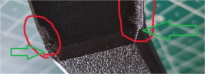

I have some problem when I print rounded corners.
In this case i printed with PETG.
Does anyone know what could cause this?
Looking at this inverted (the way it printed), it looks like the end lifted from the plate, which would have messed up the layers above.

No, the end has not been lifted from the build plate so that’s not the problem!
Anyone else out there who has a clue what cause this?
Is this angle change part of the design? I thought it was the corner lifting.

There’ a lot of things that could cause this but your post isn’t very helpful. Pardon the annoyance but you’ve provided a photo that clearly isn’t representative of how the model was oriented on the build plate. That will only serve to confuse an observer and waste a lot of time while we tease information out of you.
It’s clear from the print that the top of the image shows the impression left behind by the textured PEI plate, whereas the bottom of the image shows layer stripes that clearly represent the top of the model. While not immediately obvious, these are two separate parts. So what you did, without realizing it, is obfuscate your model, thus confusing any viewer and making analysis very difficult, if not impossible.
That’s not fair to the community if you want to seek quality feedback you need to produce and clear post.
If you want quality feedback, it would help to print a screengrab of the model as it is shown in the slicer preview window. From there, we can ascertain the orientation of the model on the build plate. The image you show indicates that you’re experiencing bad layer adhesion. Model orientation might remedy this, or adjustments to filament or slicer settings may help too. However, since we don’t have that information, we can guess as to what is going wrong.
Also, what steps have you taken to verify your calibration and setup? Are you using a tuned filament profile or just defaults? What temperature is the filament at and do you have the part cooling fan turned on or off? What speed are you printing at?

OK. Thanks for clarifying that information.
So based on this, it confirms that you’re having a overhang issue. I am leaning towards thinking this is a layer adhesion issue exacerbated by multiple causes. The two leading suspects are related to temps and filament flow.
May I assume that you already calibrated your filament? If not, that should be a first step. In this case, I’m thinking you will want to first run a temp tower. Normally I don’t recommend this but what you’re looking for in the temp tower is filament hanging like you see in your model.

Humour me… If this happens again, then before removing the part from the plate, try slide a very thin piece of paper under the ends to check if they have lifted, even if it’s only a fraction of a millimeter.
PETG does not stick well to this plate, especially for long parts that are more likely to curl up at the ends. It may not even be visible but if it lifts 0.1mm per layer due to shrinkage, that’s enough for the nozzle to collide with the preceding layer.
The apparent change in angle of the filament layer looks like a compounding lifting or over-extrusion at the corners.
You could monitor this by inserting a PAUSE at the end of every second layer for the first 30 layers and take a photo. A timelapse video may also show the increasing defect at the corners as every layer is added. If the nozzle is colliding with the preceding layer, it may also make a noise.

Sorry … no gap between piece and plate.
Printed the same part on my Prusa XL and got similar defects :frowning:
Trying to print the part now on X1C in Stelth mode … will let you know the result!
Almost perfect corners! One corner had a small defect!
I will try to change printing with outer walls first and see if that helps … if not the next thing will be to see if it will help to slow down the speed for the outer walls.
Change to print outer walls first seems to help but slow down speed did not. But I am satisfied with the result now except for the fact that the seam now is the most visual defect on the part.
Is there a way to make it less visible? I can’t cange the position (Change the seam position or paint it someware else) … it’s still eyecathing!
