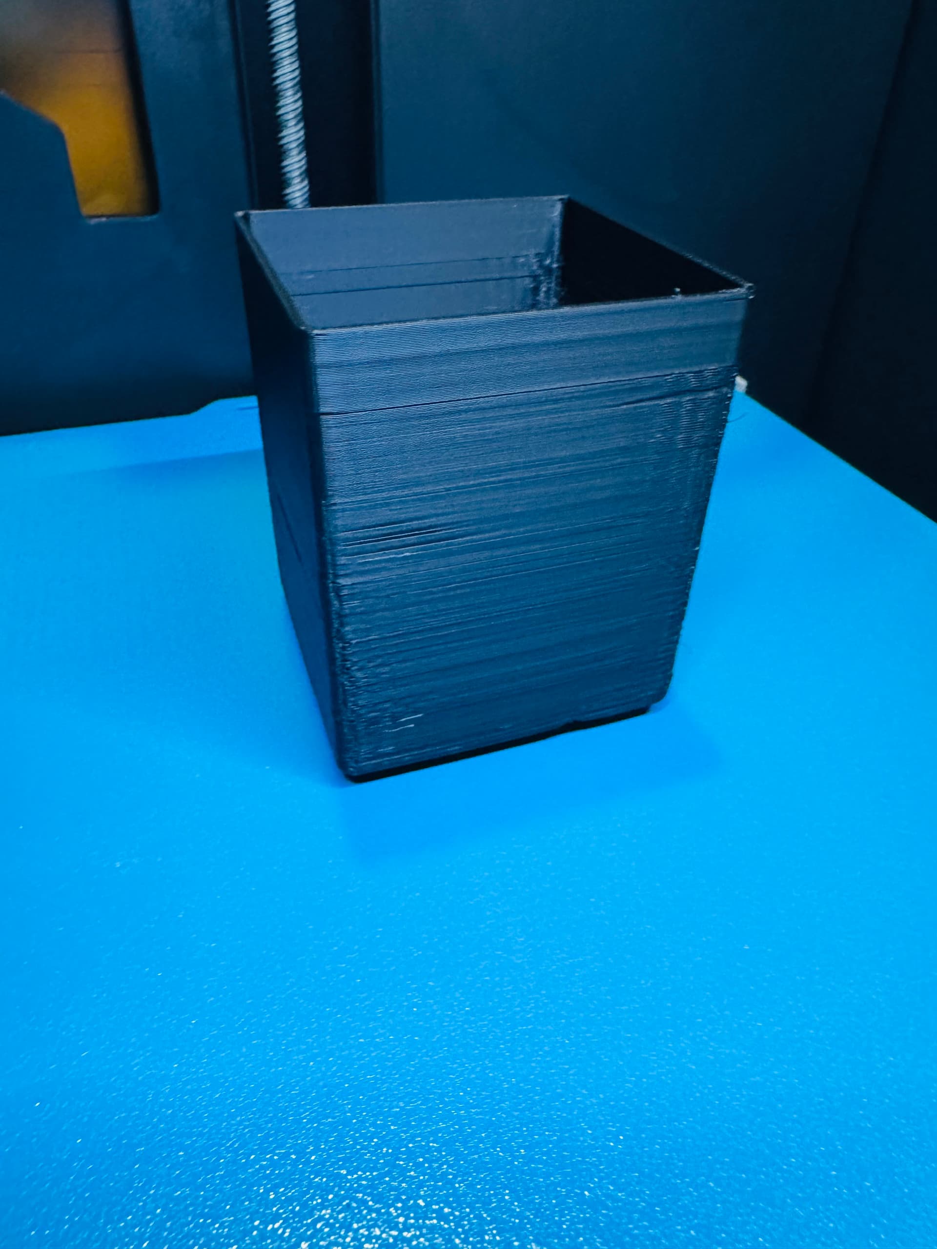

Bad extrusion that is causing rough edges
Hi there! I originally posted this to Reddit to get some answers and after a few tips I was not still not able to get stuff to print correctly.
I’ve had this printer for about two years now, and I only use it for the essentials around the house. I’ve logged about 253 hours on it, so after a failed print, I thought I’d do some maintenance to see if that helped. But it didn’t. I was printing a grid, and this recently started happening where the left side of the print starts to get really bad extrusion.
So far the steps I have taken on my own:
  • General P1S Maintenance steps
  • Changing out the filament to see if the filament was the issue (using PLA only)
Steps I have taken based on advice I received from Reddit (Wasn’t much help):
  • Get BIQU CryoGrip Pro Frostbite plate (someone on Reddit said it was an adhesion issues)
  • Add Brim
Please help me figure out what could be going on. I really need to get this sorted out as soon as possible.
Also here is the original reddit post if you need more info.
Thanks!

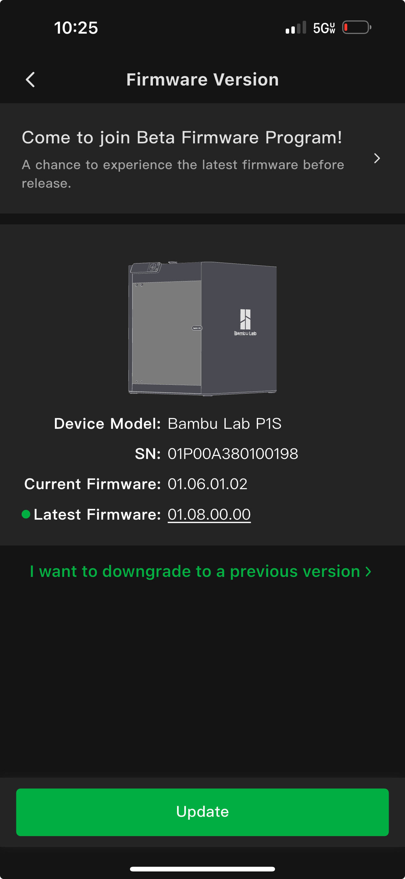

I’m not sure what firmware version you are using, but there has recently been a semi-large firmware controversy. Version 1.08.00 seems to be messing up some people’s printers. This is fixable though.
Assuming you are using 1.08.00, I recommend downgrading to 1.07.00.
(The source post is linked, as is a video link on how to downgrade)
In this video, he only downgrades one version, but everything else I see says to downgrade to 1.07.00.
Thanks for getting back to me! I was actually thinking that could be the problem since I recently upgraded to 1.08.00. So, I went ahead and downgraded to 1.06.01.02 yesterday, hoping that would fix it, but it didn’t seem to work.
Oh.
Have you tried a factory reset?
These are the steps that seemed to work for me:
  1. Downgrade firmware
  2. Factory reset
  3. Hardware calibration (in settings on P1 printer)
I have also read that people are having luck rolling back Bambu Studio and Handy versions, but I would have no clue how to do that.
