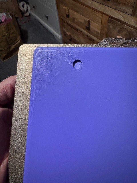

Bad top layer but only on sections near the back left of the bed
I print 90% of my objects with PETG, I use the same brand, and never have any issues. this is the first I have printed an object that is almost the full size of the bed. The object comes out great, except for the top surfaces on the very back-left corner of the bed. I have tried with print speed at 50% and 100%. I tried two brands of filament - my go-to Hatchbox brand does the best but still has issues, while Polymaker looks really awful. I haven’t played with settings yet because the whole print looks fantastic except for just the back-left section, and that is a reproducible issue. I can’t imagine the issue is settings if the print looks flawless everywhere but the back left corner.
Gyroid infull 15%, 4 top and bottom layers. The part is not lifting off the bed or warping.
I ran a calibration (via Orca slicer) and do an automated bed level with every print. This seems like an issue with the printer itself and not settings. What do you folks think?
This is Hatchbox brand. Not bad and hard to see the peeling/roughness, but note that it only occurs on this part of the object which is in the back left of the printer:
This is Polymaker brand. Much worse, but note that it only occurs on that same part of the object - back left corner.

Really hard to say what’s going on. Which maybe means there’s more than one thing going on here. I agree that issues with the left side of the print could be cooling related. But this looks almost like you’re under extruding. But the top of the extrusion should still be flat, the layer height is less than the extrusion diameter. And especially with these loops at the edges, the filament top is clearly nice and round. Like the nozzle is too high here. Which might also explain why the filament isn’t sticking to the underlying layer. Sticking requires the new layer to get squished in to the previous layer. If the printhead is too high that won’t happen (which is why supports with the same filament as the print are printed with a gap that is 1/2 of the nozzle diameter, so the extrusion will just rest on the previous layer). If the nozzle is too high, under extrusion will tend to cause the filament to get balled up. It doesn’t stay where it’s put, it’s under tension because the filament is flowing a little slower than the nozzle is moving, so it gets dragged along behind the nozzle. Every time the nozzle changes direction that string gets wrapped around it. Except, why would it only be higher for this top layer?
Given that the other filament works much better, the primary issue here has to be filament flow or PA. If it was mechanical it wouldn’t care which filament you were printing with. Unless the filament is only marginally tuned and a mechanical issue in this corner brings it out. You need to run the calibrations and also do a temperature tower for the “uglier” filament and see if those tweaks at least make it equivalent to the “prettier” filament. :slight_smile:
As for why that corner, assuming the chamber and aux fan isn’t running, I dunno. Hard for me to imagine it’s cooling related. Why would that corner be much hotter or cooler than the opposite corner, for example? Front of the build plate, with air gaps around the door, yes. But not the back. And if it was the build plate, I’d expect it to mess with the first layer not the last.
Things to try:
If you rotate the model 90º on the build plate, does the issue stay in that corner or follow the model rotation? If so, there’s something funny with the model (I doubt this is it).
If you scale the model down to 1/4 size and print it so it’s still in the same left/rear position, is the issue still there? (this will change the outcome if it’s cooling related)
Tram the build plate. And then run a straight edge across the back edge and left edge and see if that left rear corner is low. The auto-level doesn’t measure everywhere, if the build plate height changes unevenly between the sample points, the printer doesn’t see it. (I’m not sure how I can see this being it)
Dry the “uglier” filament a lot longer and see if that makes a difference.

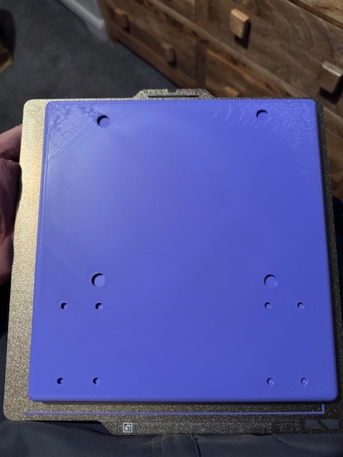

I am having the same issue with p1s and it has happen to all 3 of my prints I’m Using pla basic and have no clue what to do. Corners seem really rough at the back of the plate. Seemed to print fine all of the way through but final layers went wrong.
Any help would be massively appreciated I’ve spend days trying to fix and over 1kg of filament and still not happy

thank you for your reply. i have added 3 photos of the most recent print using PLA Basic.
so far i have slowed down the outside wall and top surface to 50 mms, i have also tried to print with the amended layer height but i am not getting any better results.
could it be that it is too big for the plate as i have never printed something that fills the whole plate?
i have seen things about possibly turning the AUX fan off but have not tried this as of yet as i do not want to continually do failed prints.
the plate adhesion is all fine and the plate is clean properly. during printing everything looks perfect however when it gets to the final layers it is when the issue happens. i almost want to say that it is like the nozzle is scratching the surface.
doing a little bit more digging into this as i am totally new to the the world of 3D printing and i have come up with some other possibilities.
i know it is not the design as i have rotated 180 degrees and the same issue happens at the back of the plate. my thoughts currently run as far as:
inconsistent plate heating causing the corners to be cooler and affecting adhesion (how to change this i do not know). whist all other layers look as though they print fine the top layers are almost scratching the surface. (i do have the timelapse of the print still).
AUX fan at back of plate affecting the cooling of the project as it commences top layers. i dont think affects the infill grids due to the filament only passing over for a very short amount of time before going to another area of the project.
any thoughts, help or people with first hand experience of this would be gratefully received.

Unfortunately a part that big and thick is really going to struggle with warping in the corners. The cooling of the top layers creates a shrinking forces that pulls on the corners. This combined with the bed not being as hot in the corners as well as there being less magnetic force to hold the bed plate flat all leads to lifting and poor surface finish as the printer nozzle will rub in the part.
PLA is not nearly as bad as other filaments but it still has its limitations. Things you can try:
  • Using a different top patterned as printing with your current one putting even more “shrink” forces into the part.
  • Using an infill like gyroid and help the limit internal shrinking stress. Lower percentage but enough that it supports the top layer.
  • Use less top layers but again like infill percentage this is a balancing act between too many and not enough that you see the infill outline.
I understand that printing these parts consumes a lot of time and filament and truth be told that your part doesn’t look that bad. You could post process the part to get a smooth finish on the top layer. PLA actually wet sands pretty good. Dry sanding will whiten the surface but wet sanding won’t. I’ve gotten some really smooth surfaces wet sanding PLA with progressively finer sand paper.
