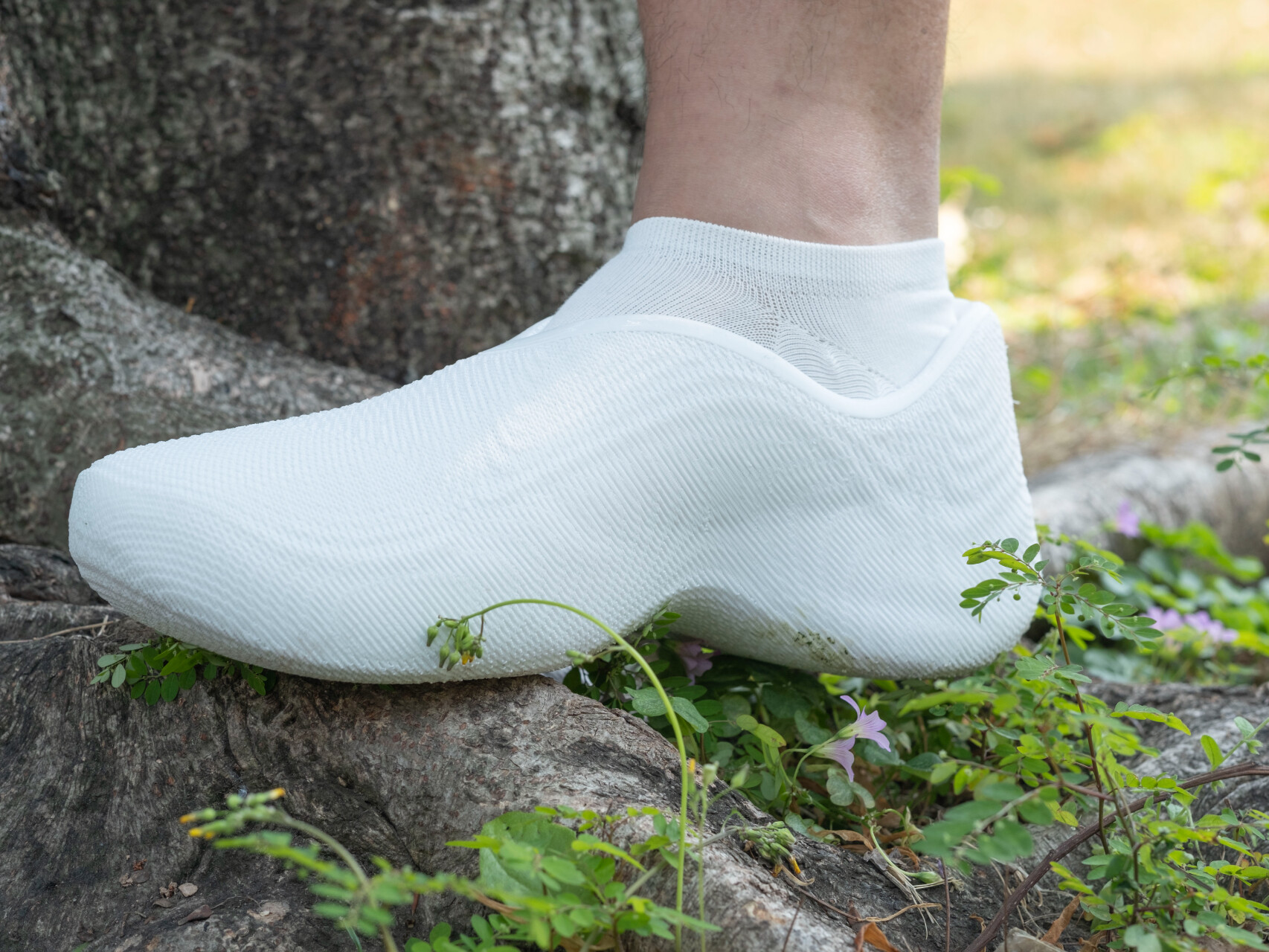

I hope my shoes fare better.
Thats what I want to make for the wifey. Gotta order some .6 nozzles. Hopefully theres a size guide for the shoes somewhere. $40 ish per roll makes it an expensive failed experiment
I have the filament and all the nozzles to play with, I just need to organise myself as the filament has to go through the top, and I have all of my printers well managed and located with multiple AMS units each.
All the shoes have guides for scaling for each size. Scroll down past the images in the description. One example:

85A for shoes… wow, you guys are very brave.
I haven’t left my house in over 5 years for medical reasons, so they will be used in the house.
Given I am in bed for 23 hours a day, they will be rarely used.
Brave isn’t the right word, curious is closer, stupid is never too far away.
I wonder if I could use tpu for ams in the other nozzle for the tread
