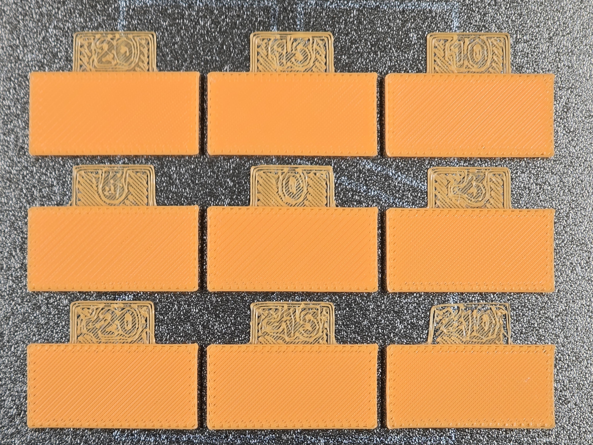

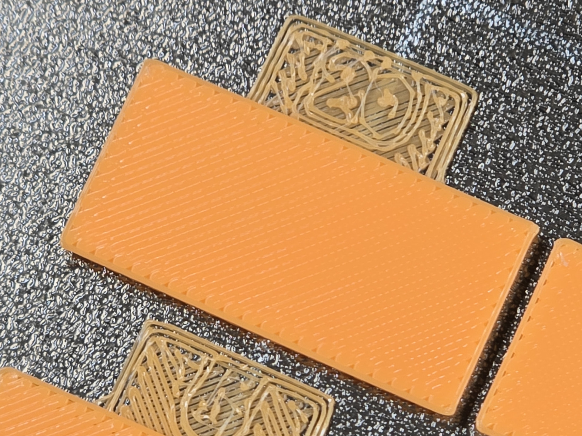

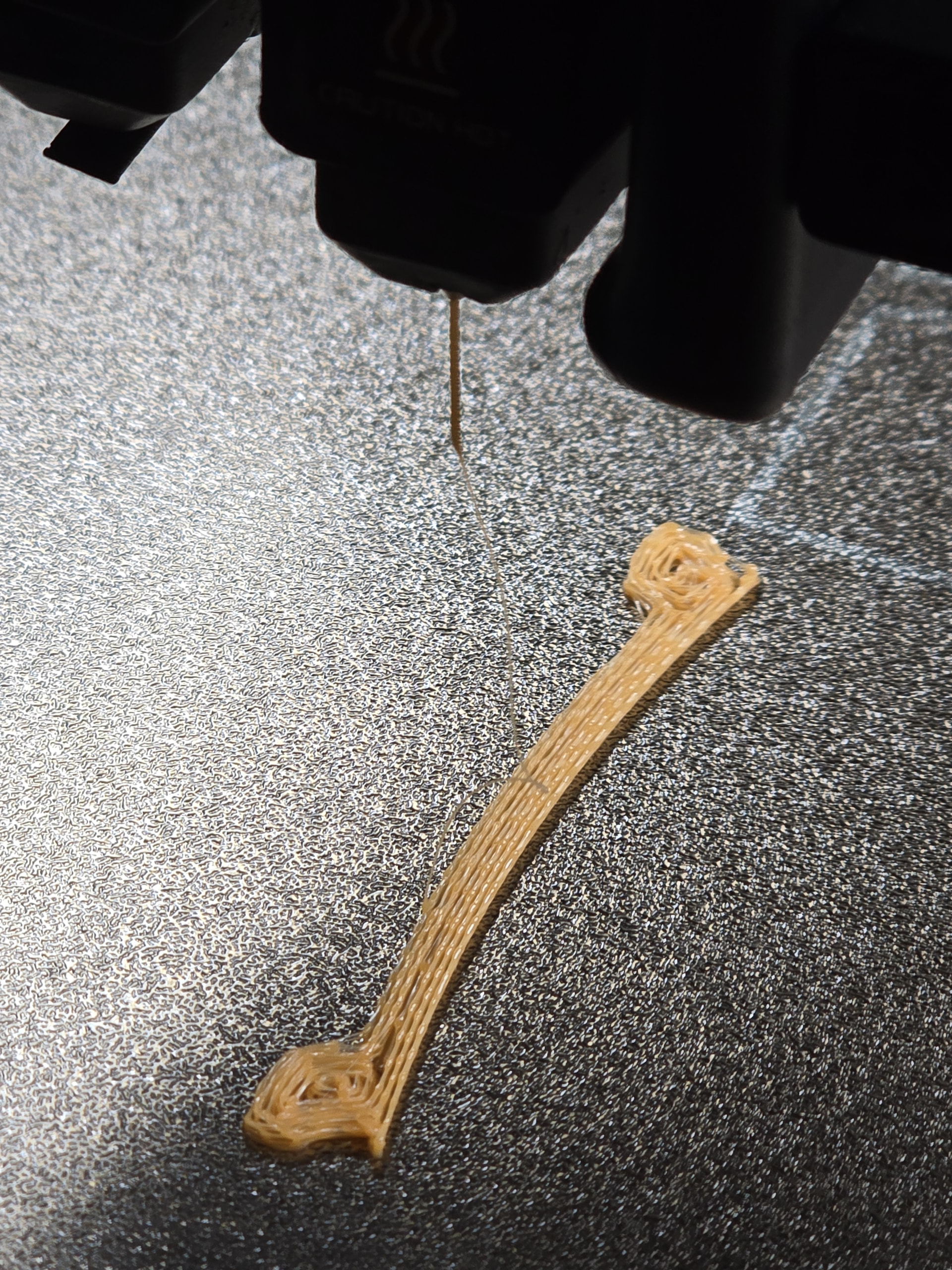

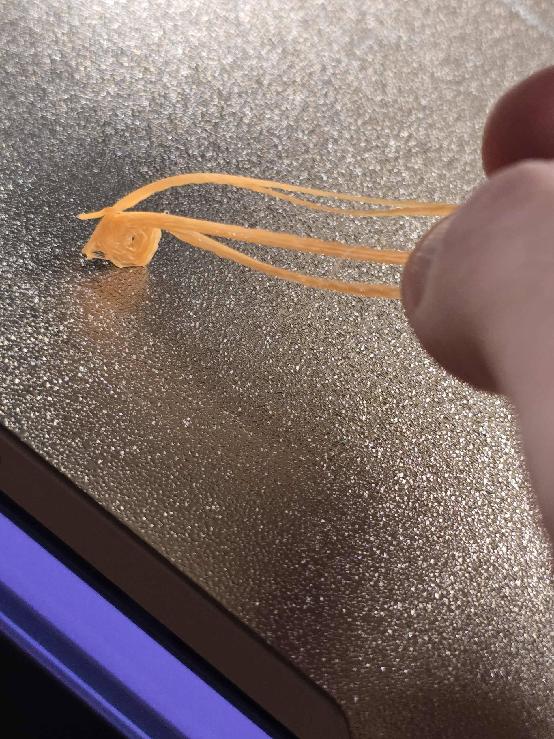

This is a very slow print on the 85A - takes more than 10 hours. As you can see from the timelapse below the print was progressing beautifully, but towards the end (roughly at the 7-8 hour mark) I started experiencing severe under-extrusion issues. But my biggest problem is not this single failed print, but that this issue seems like it is now persistent and shows up from the very first layer of any subsequent attempt to use this specific 85A TPU spool.

I suspected and tried the following, but I am still unable to figure out what’s wrong here.

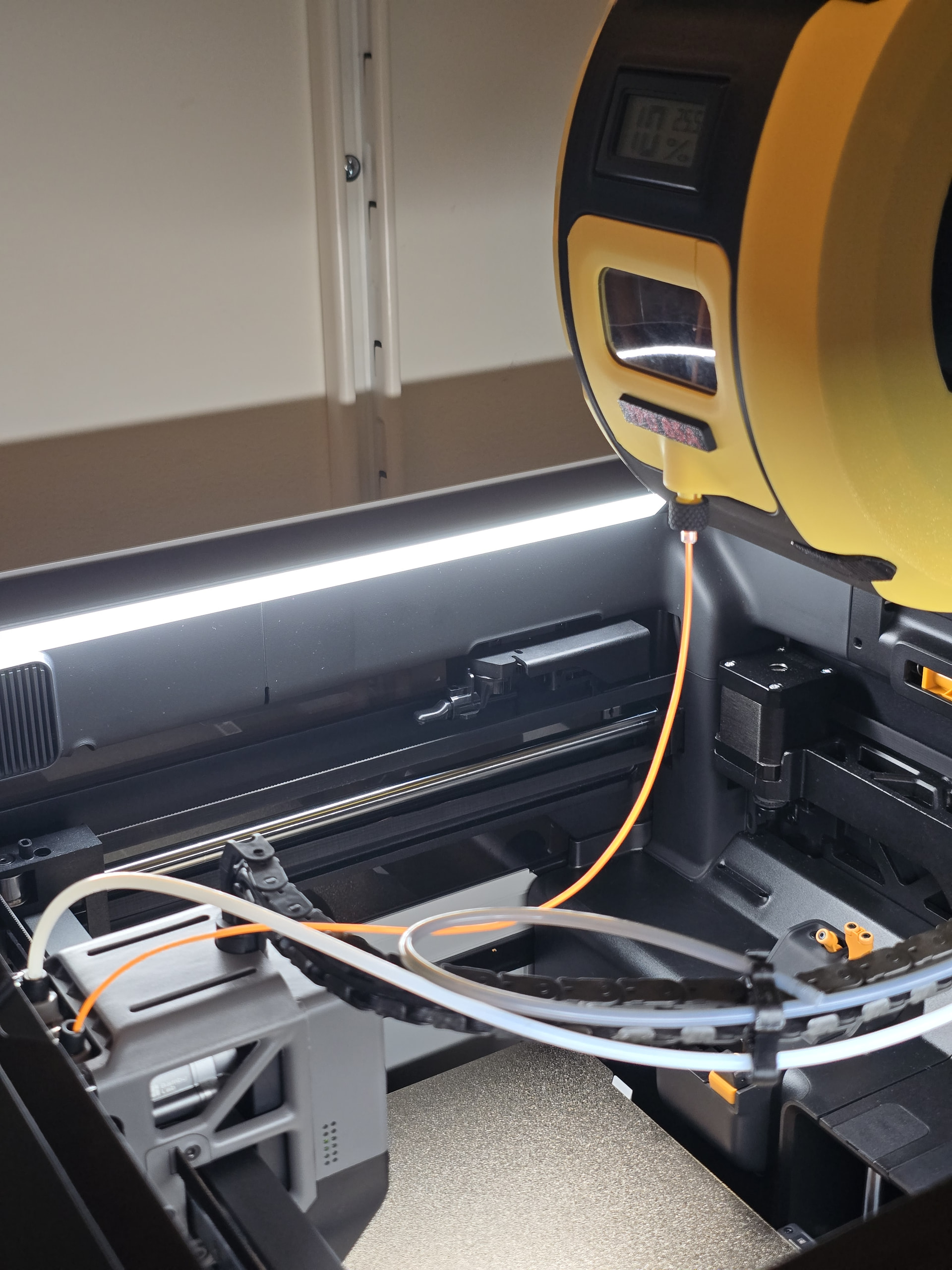

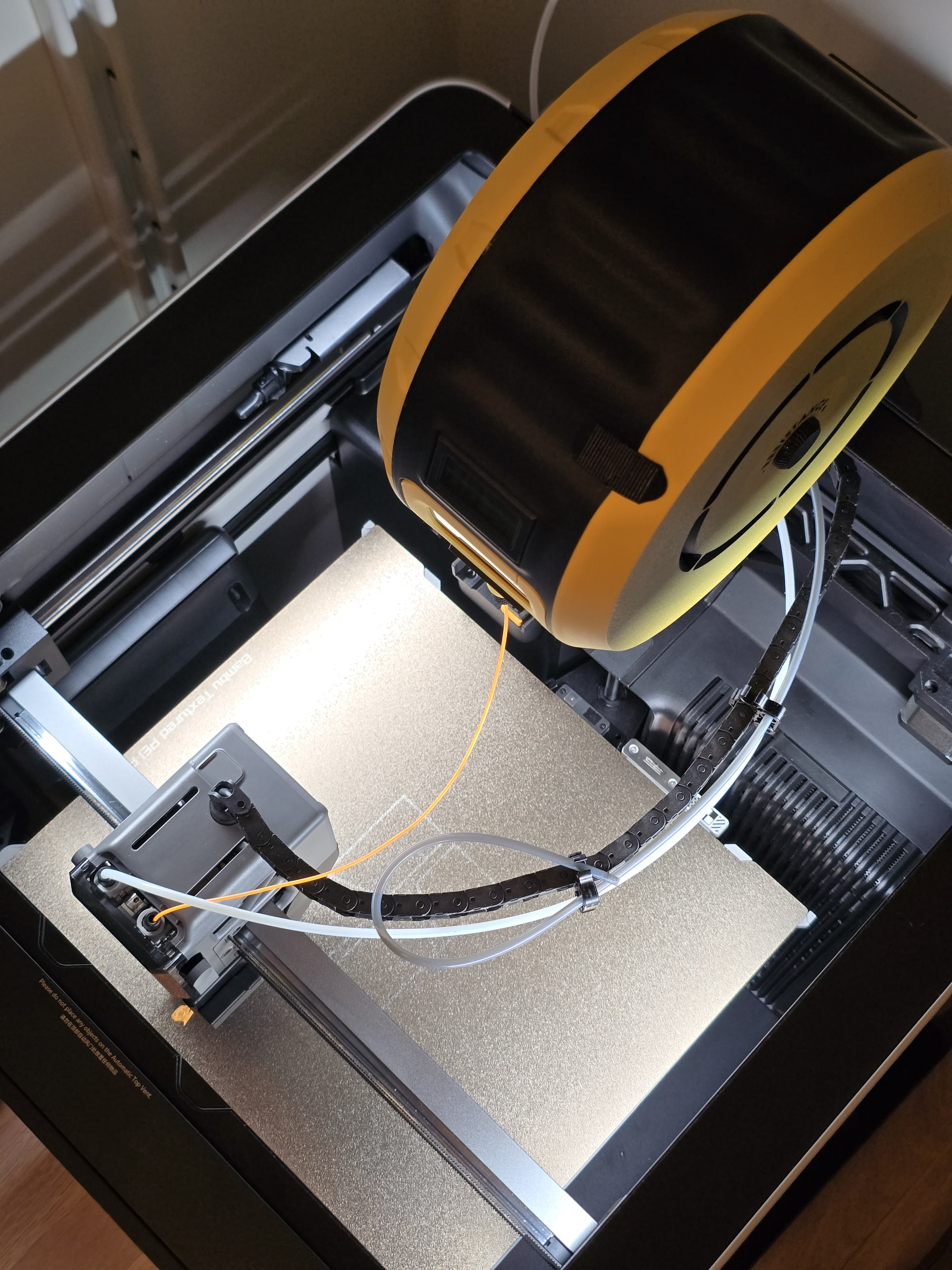

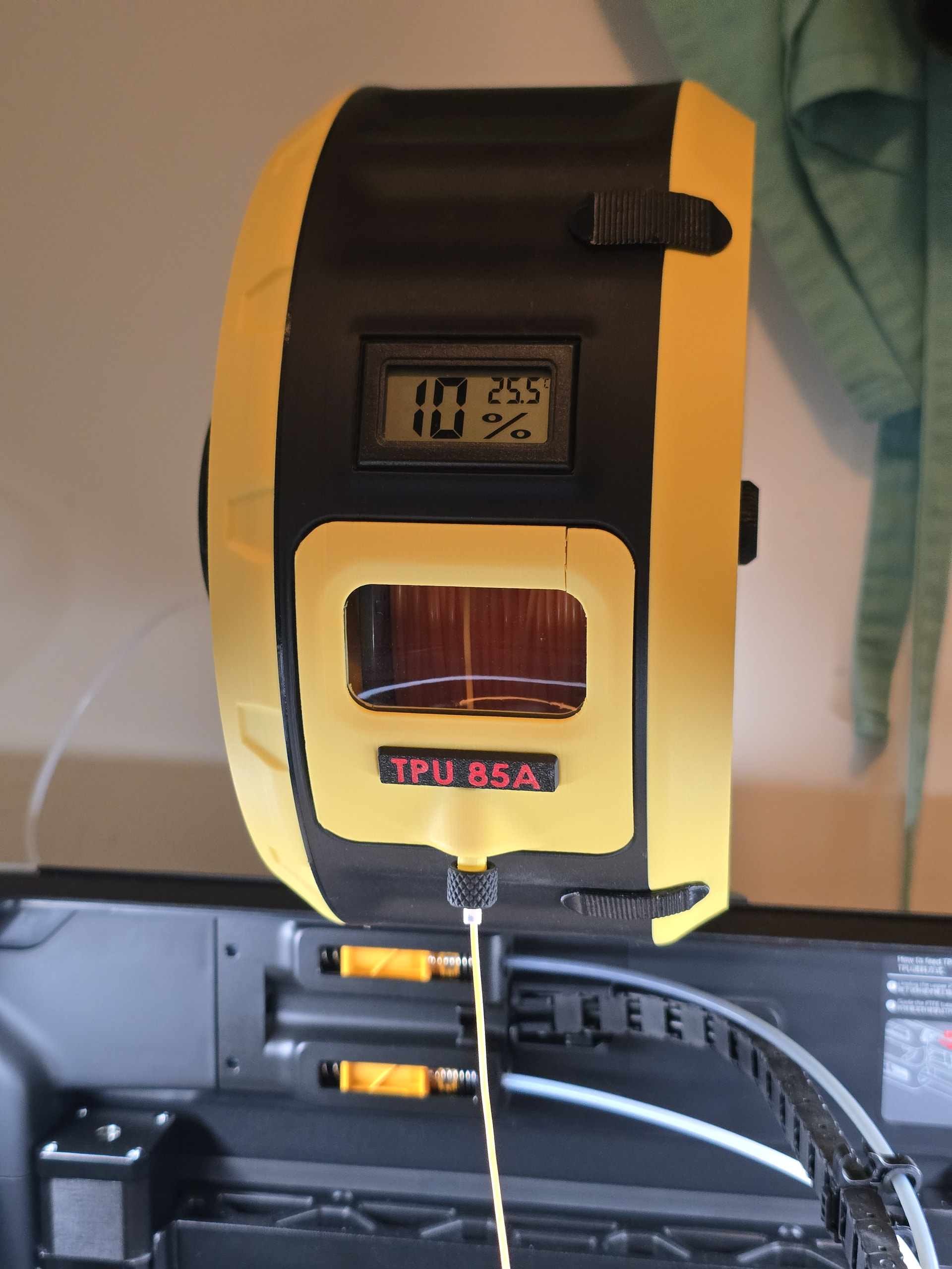

  1. Filament drying: The filament was dried in an AMS-HT at 75C for 18 hours (that’s the default recommended setting when you select the TPU drying option) right before I started the print, and I feed the TPU directly (no PTFE tubes involved) with the Retracting Spool Holder Pro: Retracting Spool Holder Pro (+SPiNE for P1/X1/H2) - Free 3D Print Model - MakerWorld
  2. Friction that hinders pulling of the filament in the extruder: I ruled this one out as the direct feeding with the Retracting Spool Holder doesn’t involve any PTFE tubes and the spool is nearly free rolling - sometimes too much!
