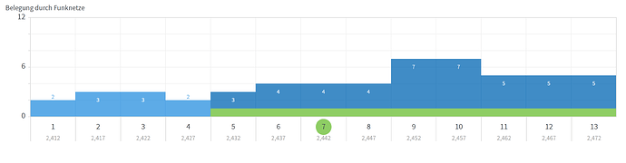

Have you ever tried switching channels on the 2.4 GHz band?
Maybe some of them are overloaded - for example, due to neighbors or interference. You could start by scanning to see what’s going on on your channels, and then switch to one that’s stable.

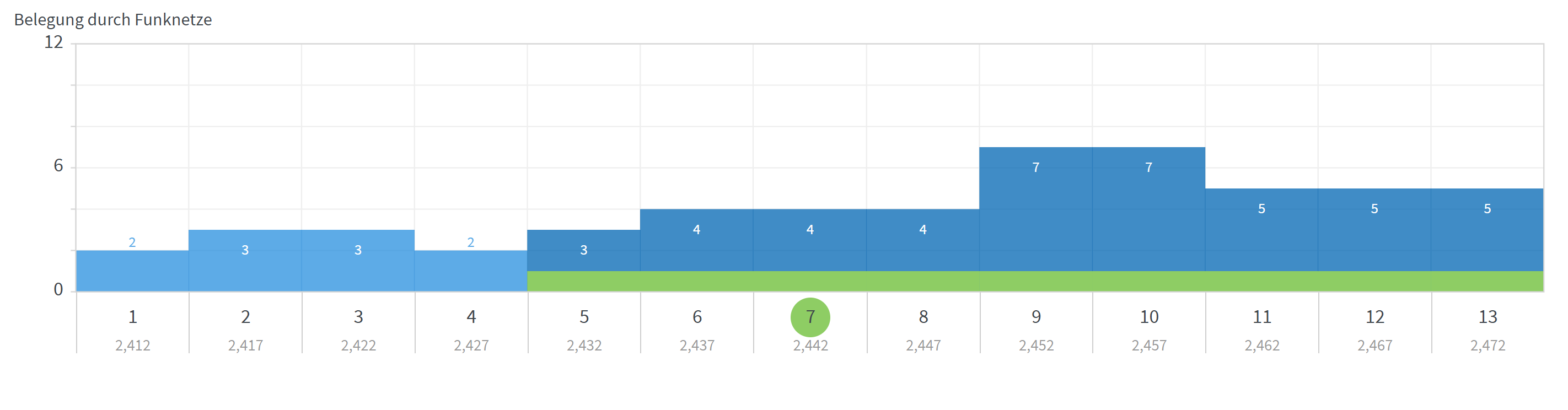

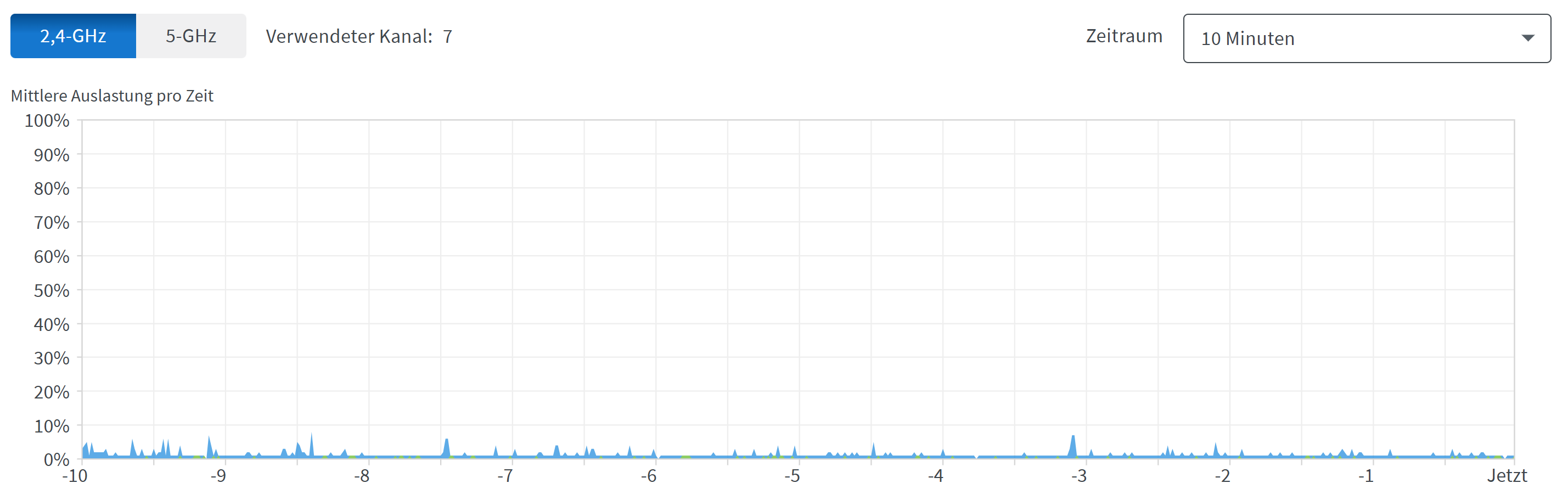

That would also explain the randomness, because depending on which channel your router connects to and causes problems, it might kick some devices off, but not all of them. Here’s a picture of what it looks like. For example, I’m currently using Channel 7 because it has the lowest traffic at this time of day.
In particular, your “adaptive-noise-immunity=none” fix also suggests that a channel in your area might be overloaded or interfered with - for example, by a neighbor.
Try scanning your surroundings for channels 1–13 on the 2.4 GHz band, and note the time as well - the interference might not always be present. In fact, cases like yours are often caused by a neighbor’s rather than a router or network problem, and they don’t necessarily affect all devices - often just the weakest ones, and unfortunately, Bambu doesn’t use powerful antennas.
You could try setting a specific channel - a different one every day - and see if that solves the problem.

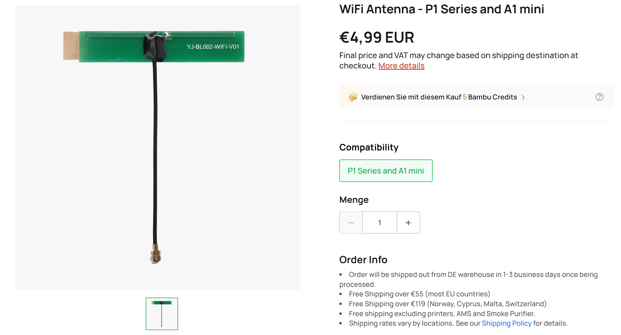

Contacting support and having them send a new antenna. Even if the warranty has expired, the parts are pretty cheap. Maybe the cable just isn’t fully plugged into the circuit board properly anymore. The printer vibrates constantly, so it’s not surprising that a cable might come slightly loose.

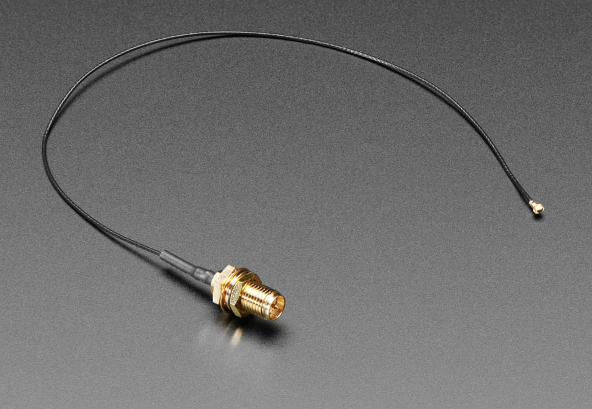

or, get an adapter cable and install a decent antenna.

Yep then I’d open a ticket. They’ll probably send you a new antenna/module/mobo, i dont have the mini flavor and don’t know the specifics. Since thats the likely route [IMO], it’s maybe a fun time to crack it open and see if replugging/reseating the antenna/board fixes the issue.
