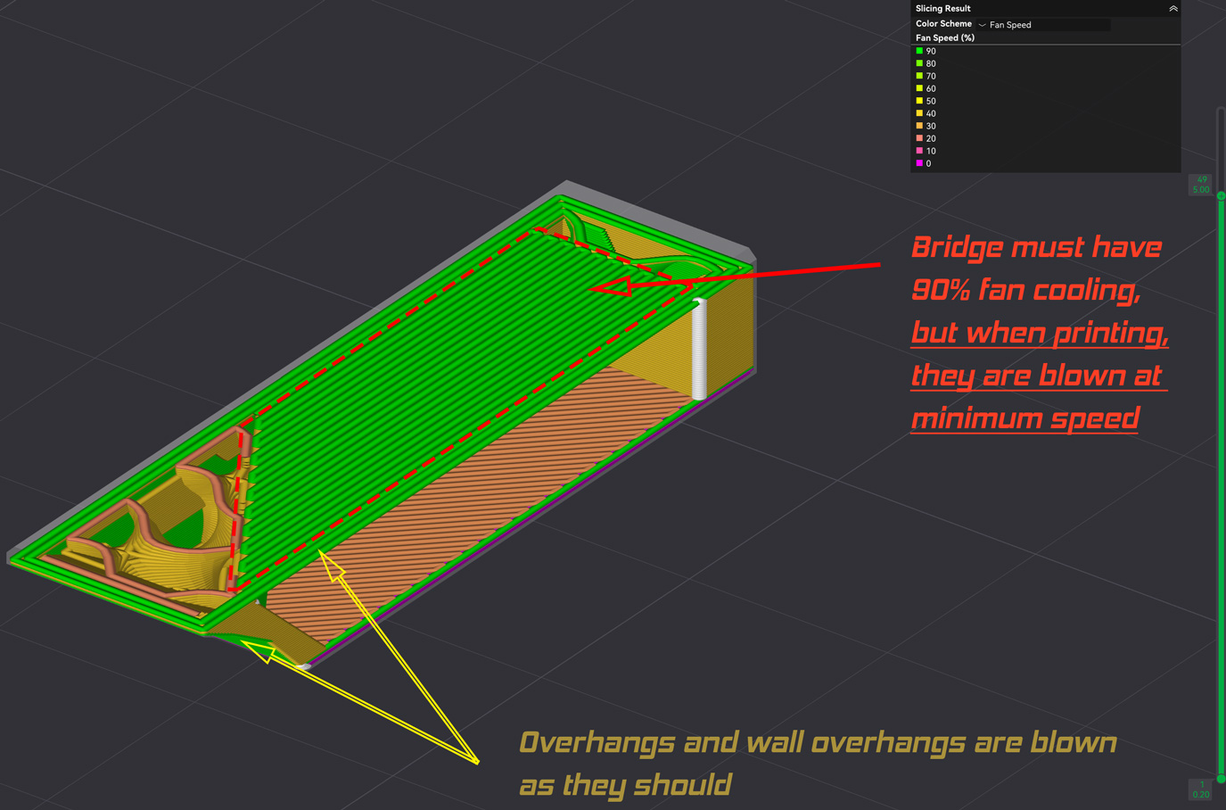

Problem: Part fan pre-start logic leaves fan speed at minimum on bridges in certain conditions.
Firmware Version: 01.07.02.00
Printer: Bambu Lab A1
Steps to reproduce:
  1. Open attached SimpleTestObj.3mf in Bambu Studio
  2. Use PETG plastic for high temperatures or lower nozzle temperature, but leave fan pre-start time at 2 seconds (1 second will also have such behavior). Also you can use for it default Bambu PETG or PETG-HF profiles (with fan pre-start time =2s.)
  3. Slice, select “Fan Speed” display and notice that bridge must be printed with high speed (in generated g-code). See my screenshot with annotations. Pls give me permission to attach files and images to send screenshot and print file (new users can’t do this)!
  4. Print and observe the print process, test object is small so it will take about 5 minutes to print
  5. Notice that it will turn cooling to max (set in Fan Speed for Overhangs) only in ovehang, overhang wall, but not the bridge itself.
  6. (Optional) Set Pre start fan time to 0 and observe result – fan will force cooling on bridge as it should. But no fan pre start, will cause worse cooling on short overhangs.
    * This is very important especially for printing transparent PETG, where good layer bonding and high-quality overhangs are essential.
Log file: No such option, don’t have SD card reader.
Other information:
I tested it on different filament profiles and so far have only found a dependency with fan pre-start time. It seems that sometimes (not always, but depending on the commands sequence) it glitches and cuts off the airflow in critical areas. Apparently, there is some kind of command overlap between fan pre-start and stop (slow down) that leads to incorrect operation.
A screenshot and .3mf file to check and reproduce. Thanks for attention!
FanPrestartBug
FanPrestartBug.3mf (28.4 KB)
