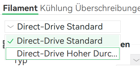

Oh guys, you also need to adjust the corresponding value for the max. flow rate in the correct profile. To do this, you have to switch from ‘Direct-Drive Standard’ to ‘Direct-Drive High-Flow’ in the filament profile at the top and change the flow rate at the bottom, then it will fit.
Today Bambu has delivered new profiles and adjusted this at least in their PLA profiles and PETG-HF (even if only the same default value of 35mmÂł/s everywhere).
