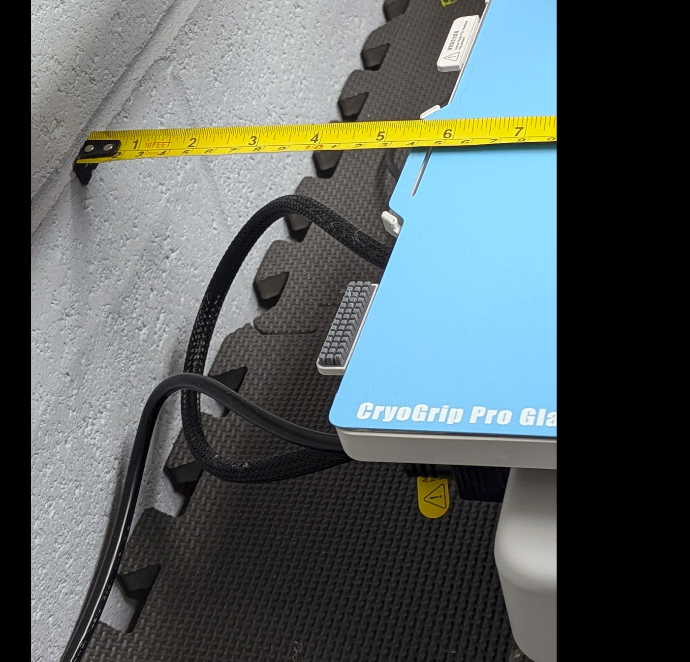

Bambu requires now 14cm from the most rear print bed edge to the wall:
wiki bambulab com - a1/manual/faq#how-much-space-should-be-reserved-behind-the-heatbed-to-prevent-the-heatbed-cable-from-being-impacted
I don’t see any reason why the additional 8cm are needed as the cable in the diagram looks that it’s just using 6cm of room.

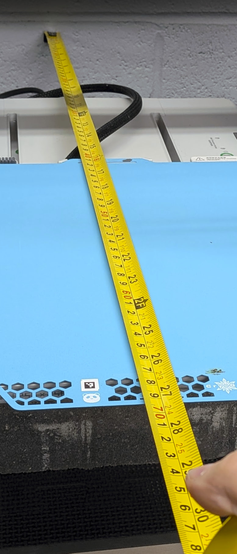

As I have a hard stop and every cm counts I would be very glad if a proud owner of an A1 could be so kind and measure the shortest distance from the front feet to the wall behind the A1 suitable.

There is conflicting info about the dimension in red. A reddit thread states it’s 465mm (475mm to allow for the cable), or 605mm in the bambu lab wiki. This is a big difference. Can someone please elaborate on how overfill the 605mm dimension is?
605mm is definitely needed if you don’t want the cable hitting whatever you have behind the printer.
Edit: 605 from wall to front of printer base (basically desk space)… then the bed also will travel 80mm more forward from the front of the printer base.
