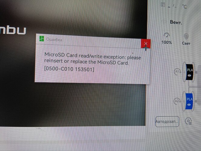

Maybe someone has encountered this
The problem is this: yesterday I put the model to print and after uploading it to the printer, the printer screen turned off and then turned on and instead of my model there is already a test model of the ship and I decided to reset to factory settings after the auto-calibration took place after the reset, the printer automatically reset me to factory settings again and so it was I think 2 or 3 times after this stuff ended, I decided to format the mini sd card, I thought it would help after formatting, I also put my model on print and he replaced it with a ship again, after that he did a factory reset again after calibration, I rolled back the firmware to the old one and it didn’t help after that I put it back on it didn’t help again, but he already started changing not to a ship, but to a test cube, and I decided to change the mini sd card, put it on, converted it to fat32 format, and it still didn’t help. He either changes to any model or gives an error, and the last time he changed my model I changed the cube to some gcode, and the video will show you how the model changes.

now I put a test cube model and the screen turned off and on again and gave me auto_cali_for_user_param.gcode

It was all because of the Russian language, and not only for me, but for many people.
