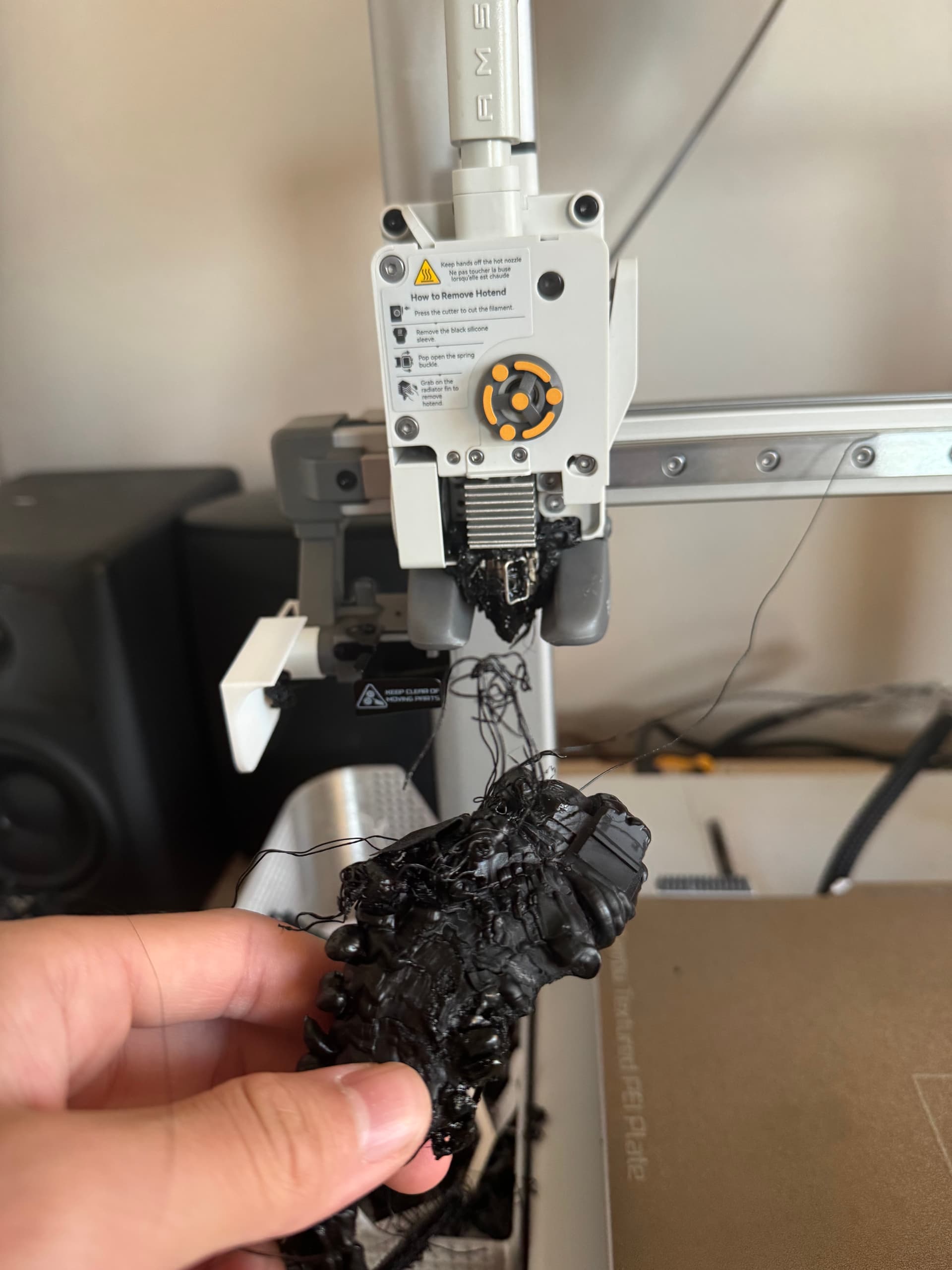

I sent a print overnight, and in the morning, when I came to check on it, it looked like this:
I’m surprised that the nozzle clumping feature didn’t work, so I’m just curious on why this happened.
Lol.wow that’s a big one
Mostly happens when the print detached from the plate due to poor adhesion, and finds itself reattached to the hot nozzle.
Clean your bed, dish soap, hot water, clean scrubber. Should be ok. You might not be able to recover the sock.
