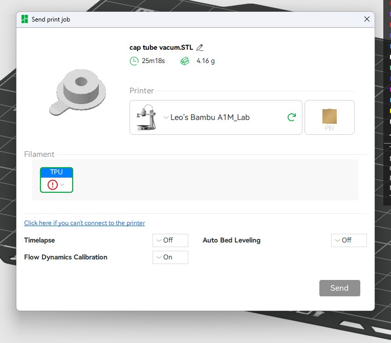

Hi everybody, after the last update, i noticed the bambu sutio only lets me print with PLA, is there anything I need to tweak for other filaments to work?
i have no AMS installed, i simply just want to use the TPU filament (like i have done before),
It looks like you sliced for something other than TPU. Assign TPU to the object(s) before slicing.
Edit: Sorry, too quick to put my glassed on… @MalcTheOracle is right
It appears that you selected TPU in your model, as it shows at the top of the swatch.
It is a shame you didn’t expand the swatch match window so we could see what material you told the printer you have.

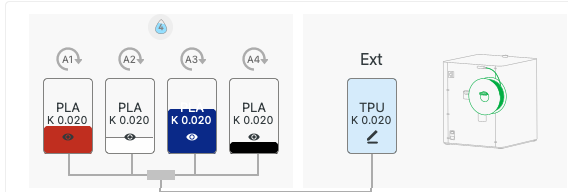

What material does it show in the Device tab for “Ext”?
The example below illustrates TPU for me, and it should do the same for you. IF not, change it there or on the printer.
Read this:
( basically you have to select your filament in two locations now, they must be of the same type )
Thanks everybody for clarifying the issue. This seems like a minor bug, as we now have to edit the type of filament in two places, but in the end, it’s not a significant problem.
thanks again
