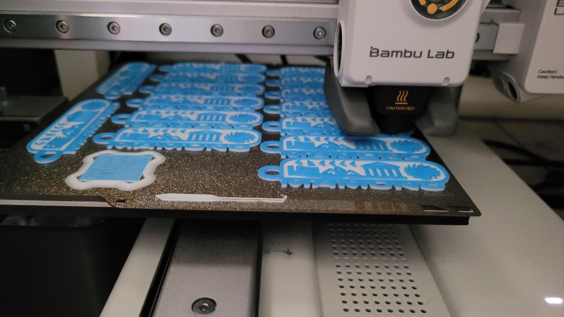

Hello, I have a question. I’m new to 3D printing and I have a little problem. My Bambu Lab A1 mini stopped printing for the 4th time in the same way, the touch screen does not respond, there is no information in Bambu Studio about what happened. The only idea that came to my mind was to restart it, after turning it off and on the printer does not continue printing. The information shows that the printing was successful, which is not true. After deleting the unfinished print, I start a new print, it prints fine 2 or 3 times, and then stops about halfway through the next print. I don’t know what to do because it doesn’t show any errors

It could be a faulty SD card. Try formatting it or replacing it with a new higher quality SD card. The ones that shipped with the printers are known to cause issues. Although I have had my A1 and A1 mini since they were released and I have not had any issues with the SD card.
