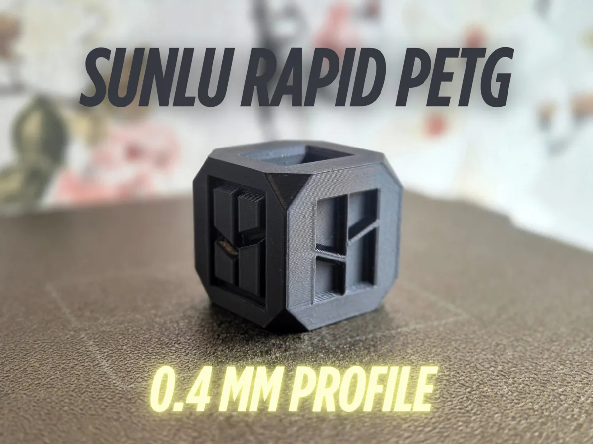

I don’t know about Sunlu PETG HF, but Sunlu Matte PETG HF is terrible; I’ve spent three days trying to dial in the settings myself through trial and error—testing configurations from people online and public profiles on MakerWorld—but it’s impossible to get a good finish. I only manage a decent finish at low temperatures (230°C) and low speeds (<30 mm/s), but even with that decent finish, the layer adhesion is awful.
I’ve used dozens of rolls of Sunlu Matte PETG HS, I get really good finish with it. I dry it out for 10-12 hours then print it with the standard Bambu PETG HF settings but INCREASE the temp by 10C up to 255C. Sunlu recommends:
230-240 at 50-100mm/s
240-255 at 100-300mm/s
255-270 at 300-600mm/s
Seems you may just be printing too cool.
I’ve printed a ton of the Sunlu High Speed PETG, I’m assuming that is the same thing. It is matte, but not quite as matte as the Bambu.
Mostly the important thing was to dry it first, and I think I changed the retraction a little, but it printed fine with the Bambu PETG HF settings.
Maybe try this profile?
