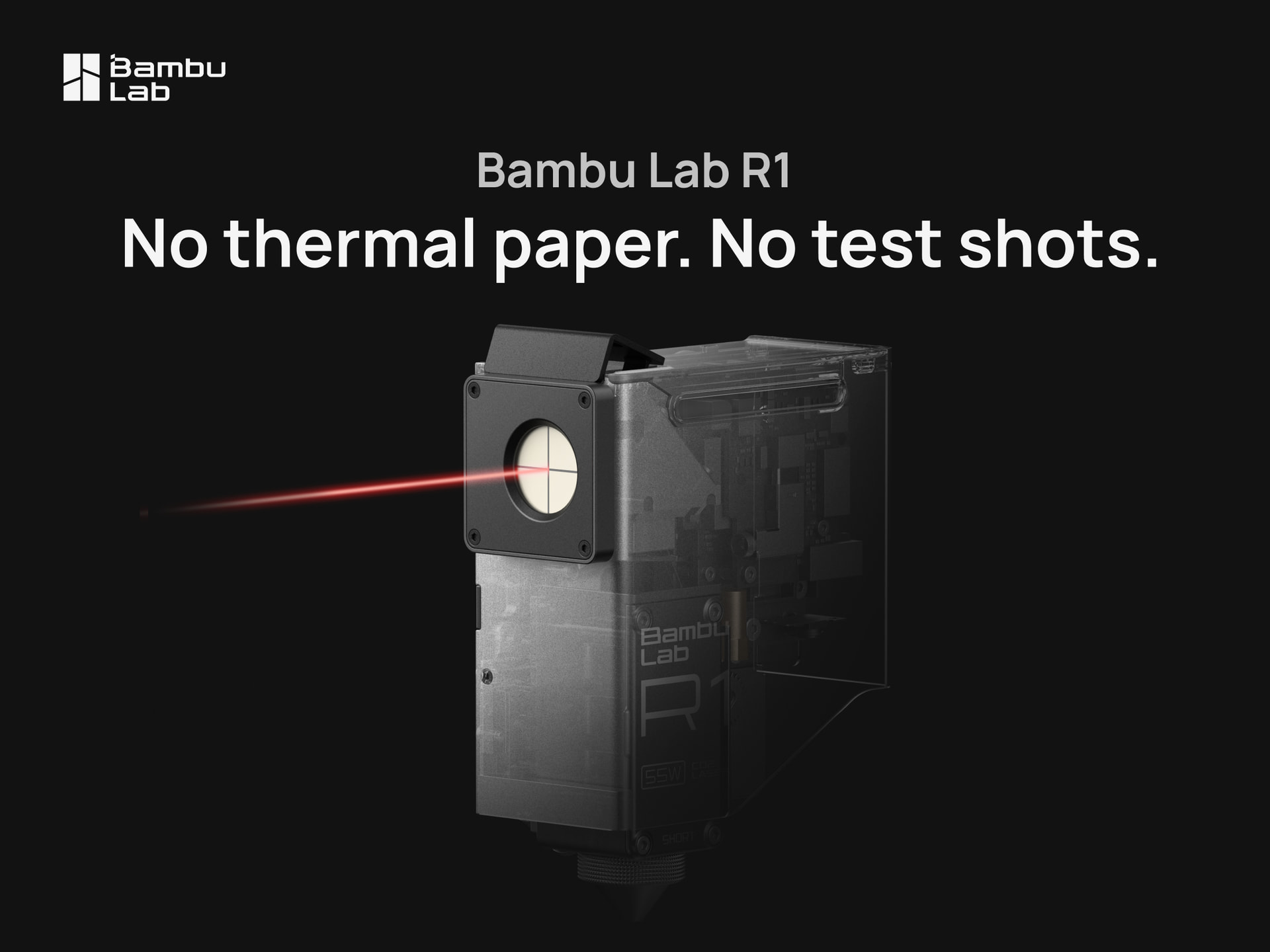

[Bambu Lab R1] No manual calibration
R1 aligns the optical path automatically – a first for a laser cutter.

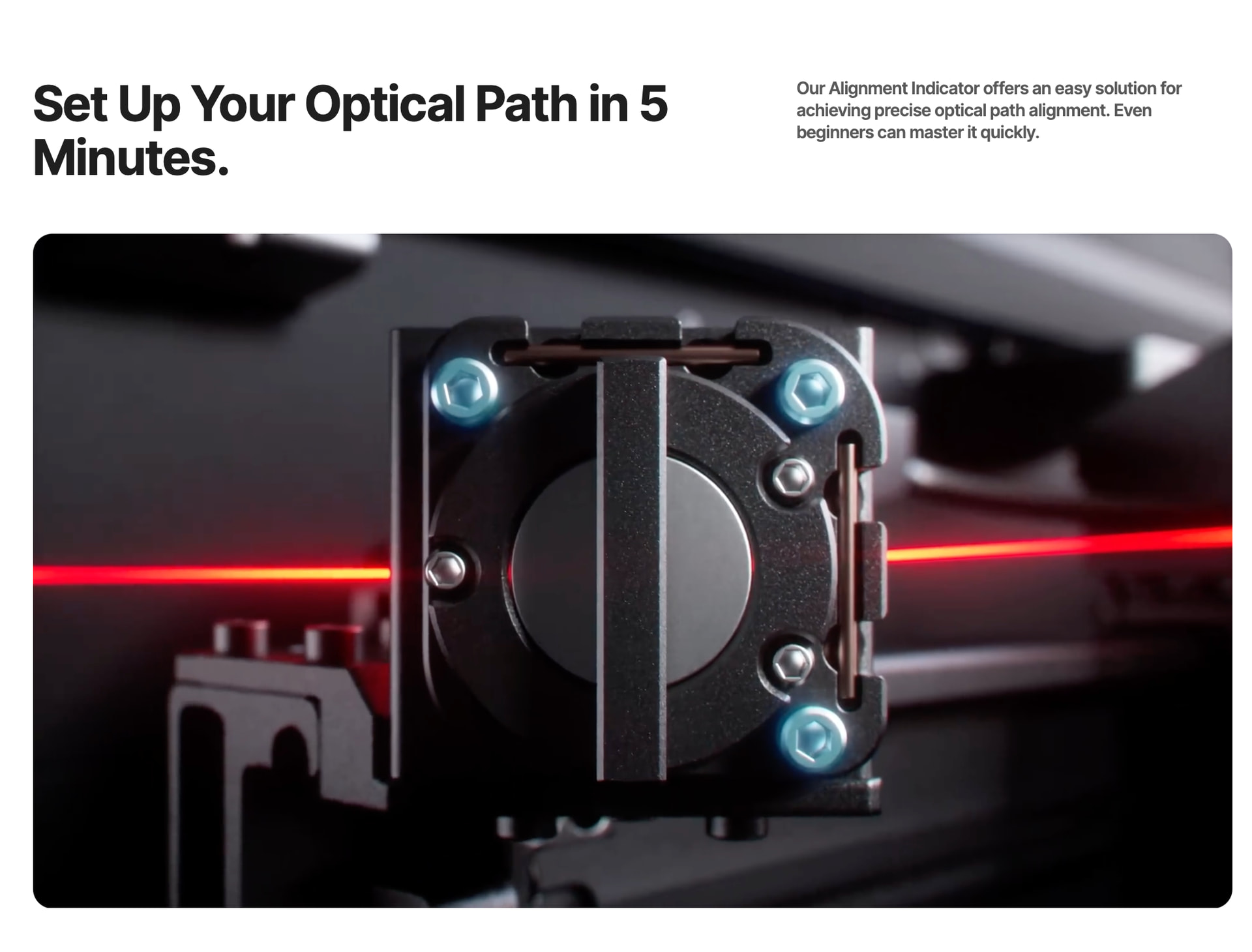

This is not something you 100% have to do on the Xtool P2S, mine came already aligned, but should you get a misaligned machine, you’d do it only once anyway. (with some paper and a screwdriver, “5 minutes”.) Smoother onboarding, but again, it only affects the first day.

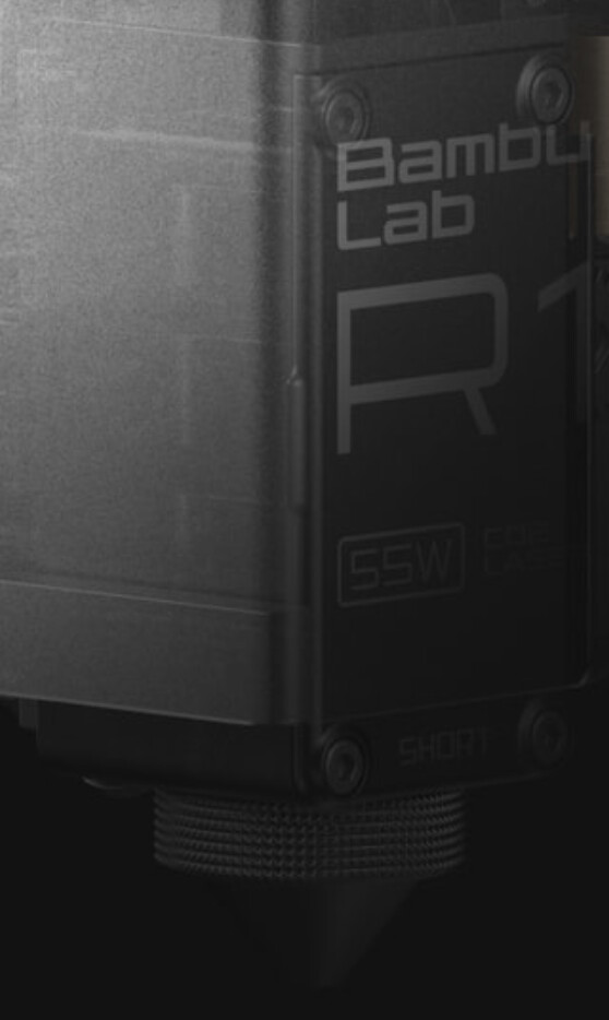

Maybe I missed where it is covered, but what is the little nozzle type thing at the bottom of the picture labeled “SHORT”?
Good catch
So why is the laser horizontal?
And if it is rotated, why is the writing that way around?
If it did rotate, that would be a nozzle or sensor? Does it rotate to tap the bed to calculate height? (But why, surely it can use optics to determine distance?)
Maybe it’s only for positioning (side target), maybe it usees a mirror system. Hopefully only 4 days to find out. I wonder how many pre-release testing YTubers are out there waiting to release their vids?
Edit: which posters have been unusually quiet the last couple of weeks?

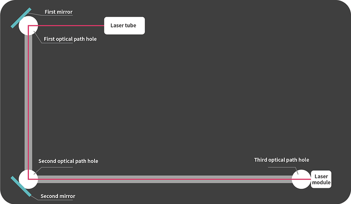

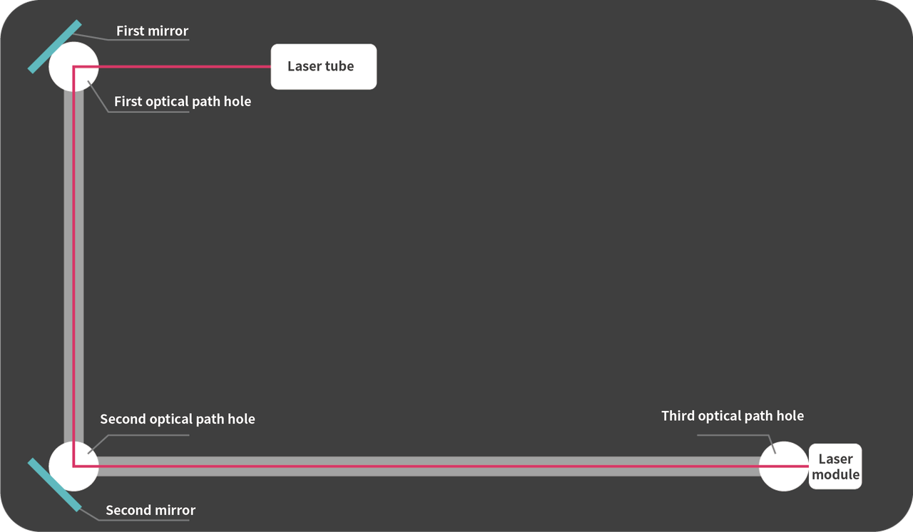

CO2 laser source came from a giant glass tube and typically has to be housed in the very back of the machine. the beams are delivered via mirrors to the actual laser head that is nothing but a mirror, a motor, a lens and some control electronics. That’s why it goes sideways first.
OK, so the “target” looking orofice is probably recieving the laser, then a diagonal mirror directs the beam down to the “SHORT” opening. Guessing.

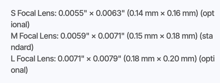

I suspect it’s swappable lens. But Short not Small? no idea.
Likely this entire assembled module gets pulled out. Xtool P3 has something similar but more exposed
Basically finer laser spot or bigger power. But the difference is… not huge, at least for the P3.
vs. a UV laser’s 0.02x0.02mm laser spot or Fiber’s 0.03x0.03mm for real fine details.
Yeah, the R1 “module” has what looks like a clip or safety switch right above the “target”. If that is the case that whole thing maybe removeable.
