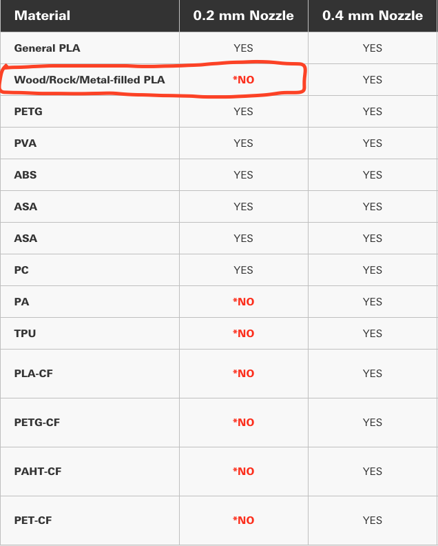

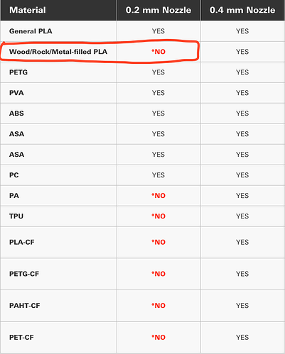

Does anyone know if the metallic PLA can be printed with the 0.20 nozzle in the X1C? I know silk needs a 0.40 but I don’t see anything saying what size is ok/ recommended.
Ok, but the Bambu Labs Metallic PLA does not contain metal…
If anyone was curious. Yes, it prints perfectly fine.
