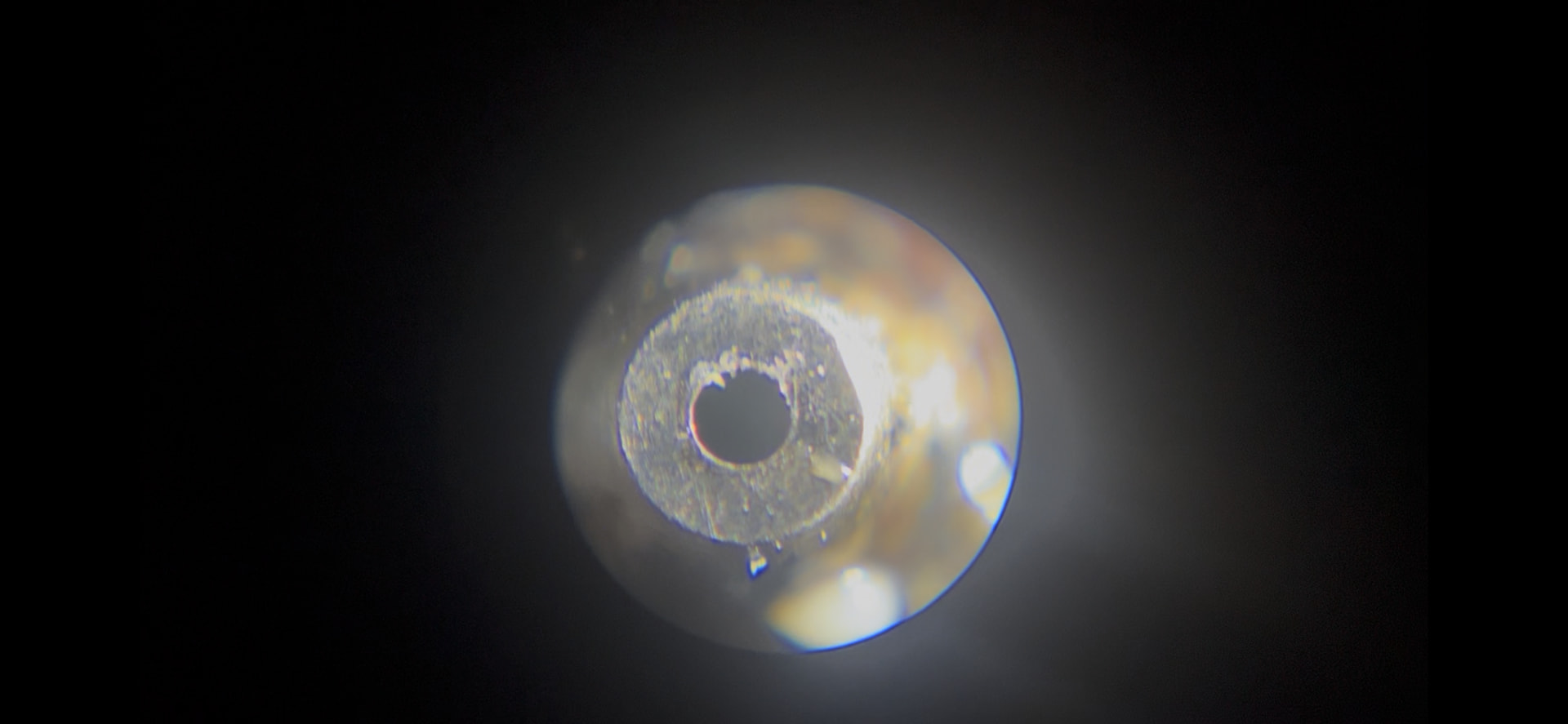

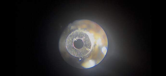

This is the image of my 0.4 HF nozzle. Is it okay or should I replace it?
That looks to be in very good shape - as long as you’re not seeing print issues, I wouldn’t replace it.
I might try cleaning it with some of my finer grit papers like 2000 grit or finer. The orifice is what is critical. Don’t open up the hole.
That looks like a nozzle in perfect condition. What looks like a little roughness at the ege of the hole looks to me to be nothing more than some plastic, which will get removed the next time you use it.
You might, I wouldn’t. 2000 grit is far too course and would dimensionally change the orifice. If, that is, you could actually get it in there. If you feel the need to use abrasive material on a precision hole then it’s time to buy a new nozzle.
Nowhere and in no way did I elude to sanding the inside of the orifice.
I would very lightly clean it across the face of the orifice. It is showing some grunge.
Sanding or digging around within the orifice would be a terrible idea.

I would not use any sandpaper at all on any part of the nozzle. I’m not sure, but I would expect the nozzle to be coated or surface treated and anything harder than the nozzle could destroy it.
For removing grit, I use softer metal like a brass brush. I think BambuLab even advice against brass.They recently released a cleaning sponge, similar to the sponges used for cleaning soldering irons. Maybe that is a good way?
