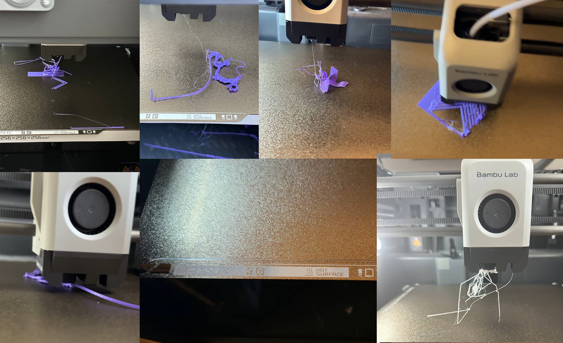

Hey, I’m having an issue with my Bambu P1S — I haven’t been able to get a single successful print so far.
Problem:
The first layer doesn’t stick well, and the print quickly turns into a mess of wicked spaghetti
What I’ve tried:
Replaced the hotend (set up the correct nozzle I’m using in both cases)
Cold pulls
Extrusion looks normal in the air
Tried to print with PLA(violet) and PETG(transparent)
Factory resets & full calibrations (bed leveling, flow, vibration, factor)
Cleaned build plate (dish soap or IPA) + tried printing on 50° & 60°(checked if the plate is warm)
Correct plate selected (Textured PEI)
Default temps and profiles
I’m starting the prints from Bambu Studio with auto bed leveling enabled
No errors during the print, no errors after
I bought the printer from a friend who had it working perfectly. It was transported for a short distance by car in the original box, but without fixing the bed with factory screws
Still getting similar results every time (it’s messy right from the start, or did okayish first L line and then gets messy during printing a model).
Question:
Any idea what could cause this on a P1S?
Could it be something hardware-related, or am I missing something obvious?
Appreciate any help :folded_hands:
