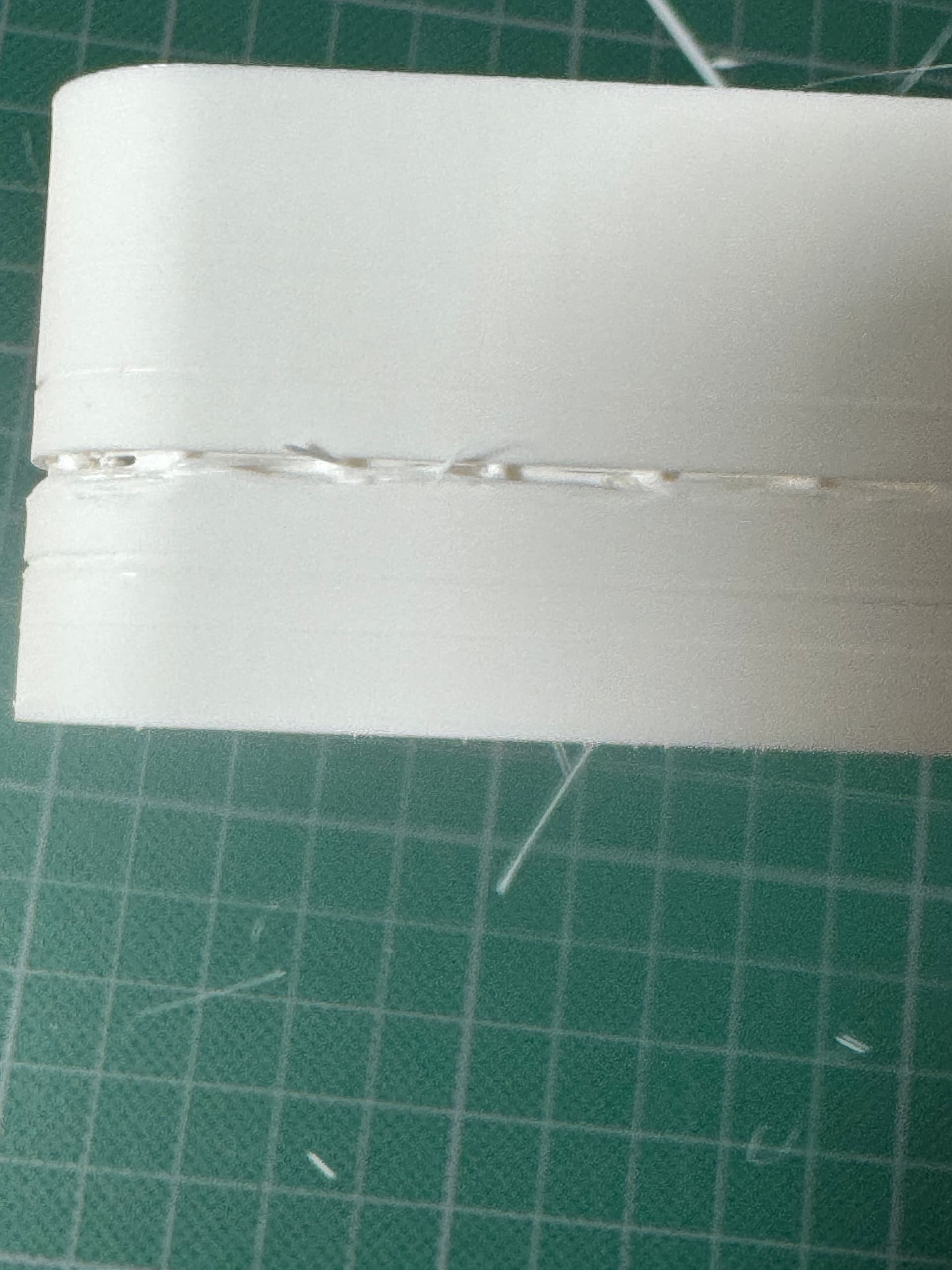

I’ve recently swapped out my head (to another .4) and added a new spool of PETG.
Using the stock values, my results are looking like this. Previously i didnt have these types of issues. I’m really new to this forum. And am currently doing the flow calibration to see if it will help.
Thank you for any thoughts.

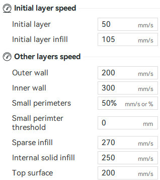

What are the print speed settings? My prints with PETG come out better when I slowed the speeds.
slow your speed settings down by 1/3rd or 1/4th. everything but acceleration

I print multiple objects on a plate, and I think travel distances have become an issue. It happened on simliar layers, for two different test prints. PEGT seems to drip as it travels.
It did not happen when I printed only one part. Got great results.

  1. Adjust speed (as recommended) - I’ve included my current speed
  2. Move to PLA (not sure why i’m using PEGT!)

I set my initial, top surface, and outer layers to 30 mm/s and my infills to 60 mm/s but that’s because my infill was crumbling. Try setting your outer wall to 30-60 and see if that helps.
let me assure you that you can not print petg at 300mm a sec or even 200. No one setting should be higher than 100 mm a sec for basic petg
thank you sir. I was going to use
  1. Speed outer wall - 100 mm/s
  2. Speed Inner wall - 150 mm/s
  3. Sparse Infill - 135 mm/s
  4. Internal Solid infill 125 mm/s
  5. Top Surface - 100 mm/s
But now i’ll drop them all down to 100mm/s
reliability is huge for me. failed prints are such a bummer, so i error on the side of caution and am always presently surprised to find how little time is added by slowing a few speeds down. If been testing out pressure advance with orca slicer and it def ads some speed ability.

When printing multiple parts on a plate, you can change the “Print sequence” to “By part” under the “Others” tab, “Special mode” heading. If the parts are not too big, this will allow you to print multiple parts without all of the travels for each layer, minimizing the travel defects.
This feature won’t work if your parts are very tall or long though.

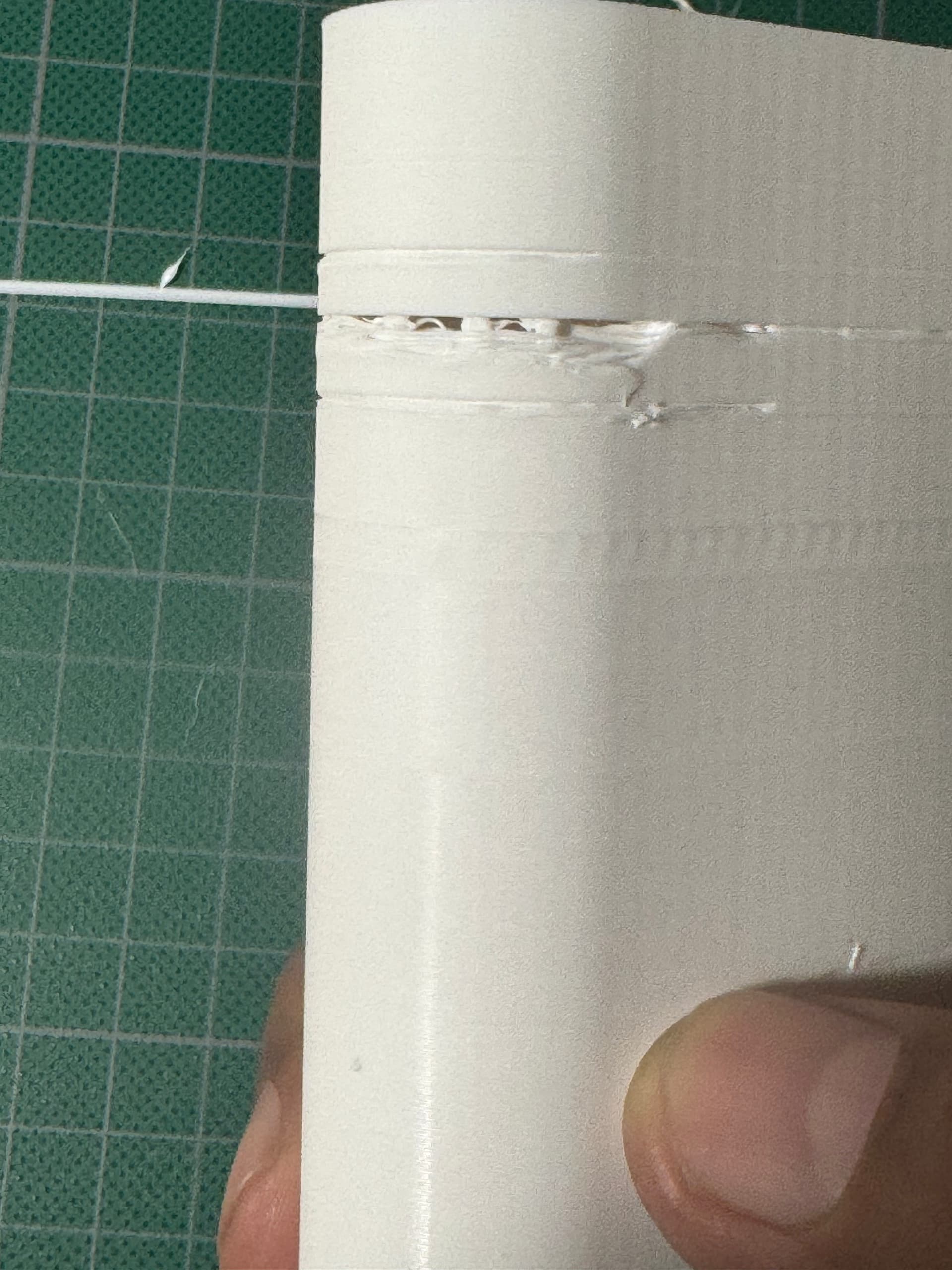

Most of my issues have been resolved from slowing things down.
However I still have this ‘banding’ issue. These two prints were taken over a week apart. Print on the left uses slow speeds.
its werid that the bands are on the same print layers.
Maybe something wrong with the rods? have you cleaned and greased them?
