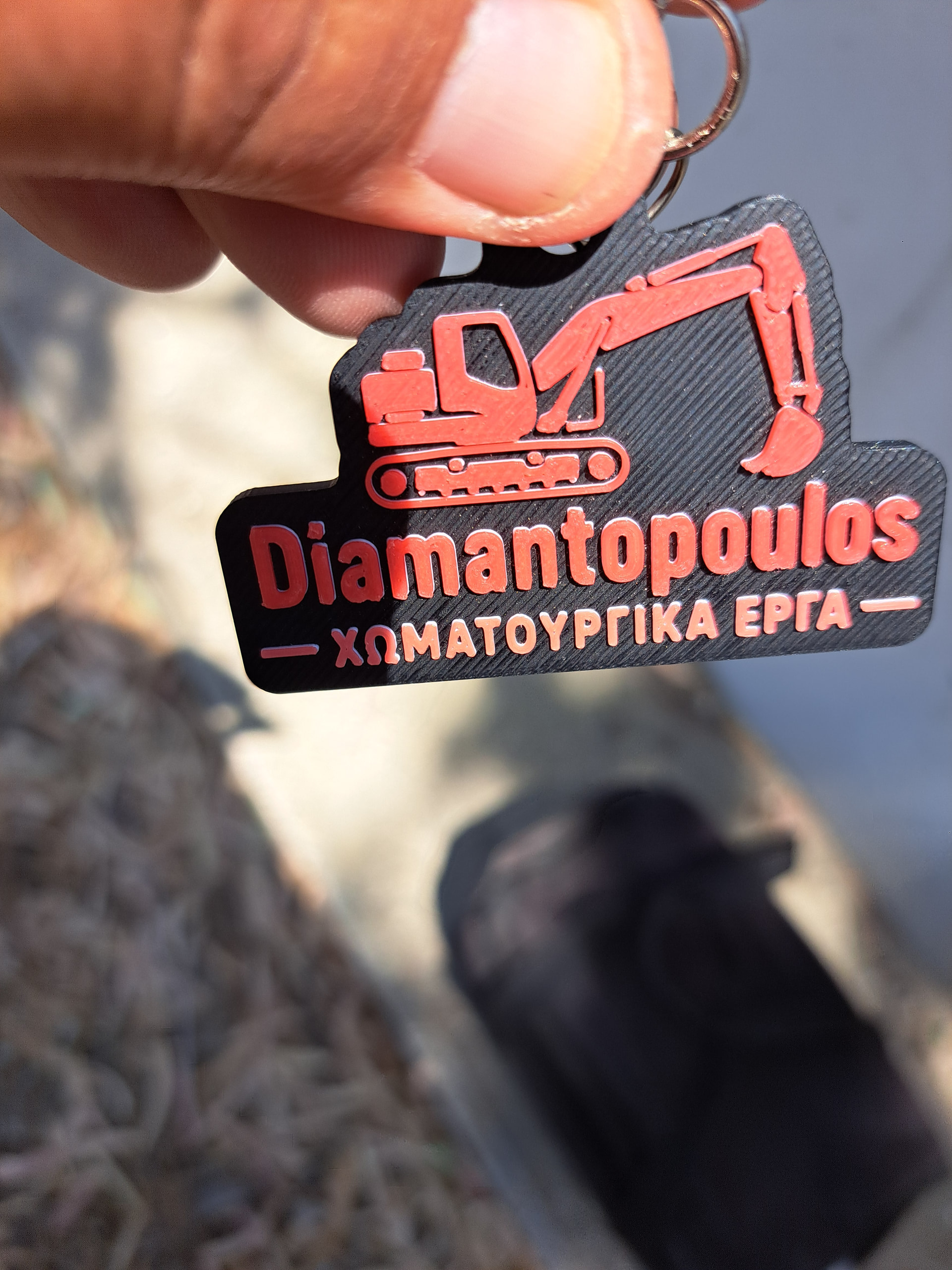

I have printed many of these keychains successfully before. The model, printer and nozzle are the same, and the prints were previously coming out very clean.
Recently, however, the small raised letters started printing badly.
As you can see in the photos:
Photo 1 – Previous successful print:
The large white and red areas are clean and the small details were much better.

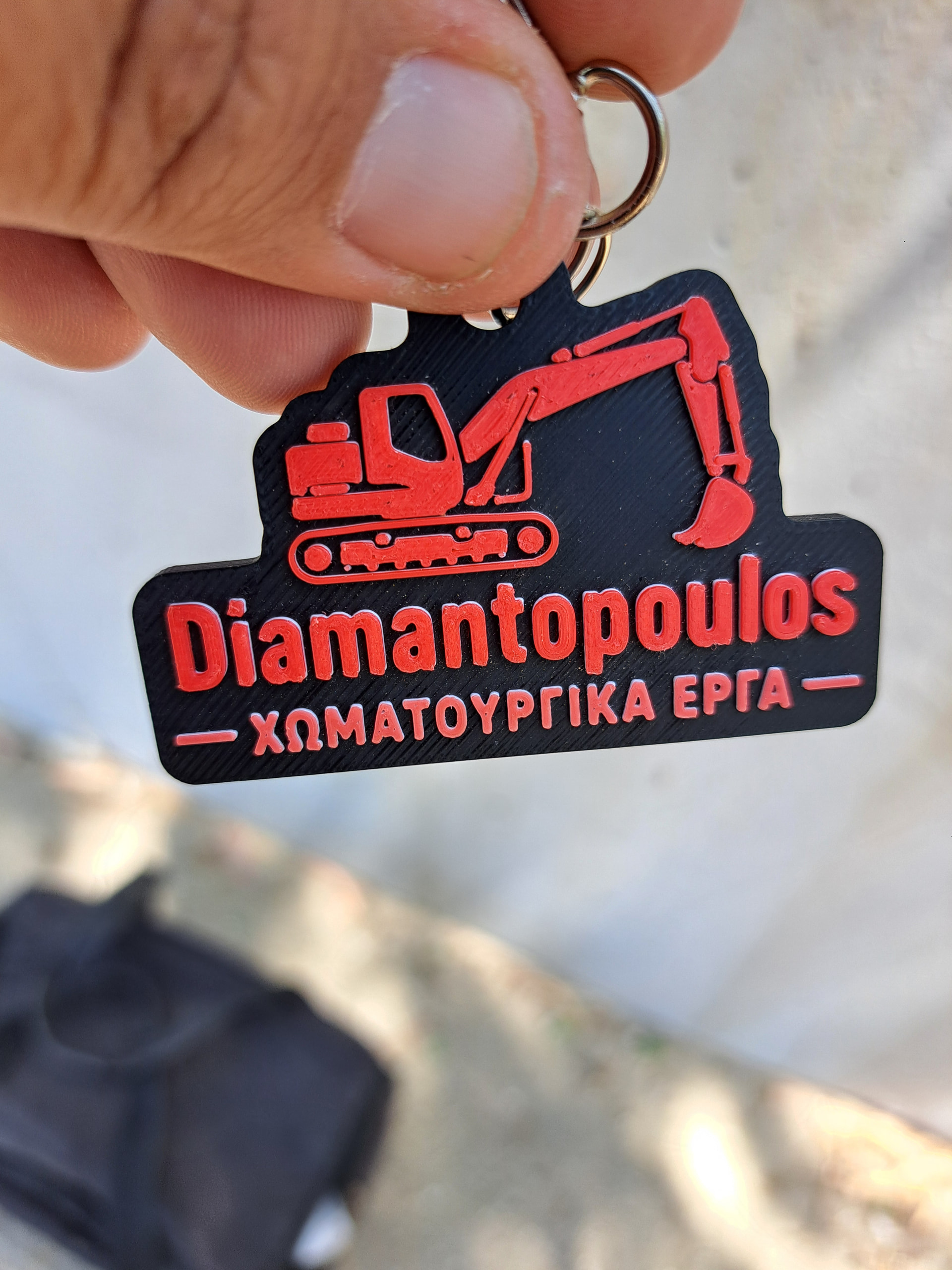

Photo 2 – Recent print:
The large surfaces still look very good, but the small raised letters have become rough and poorly defined.

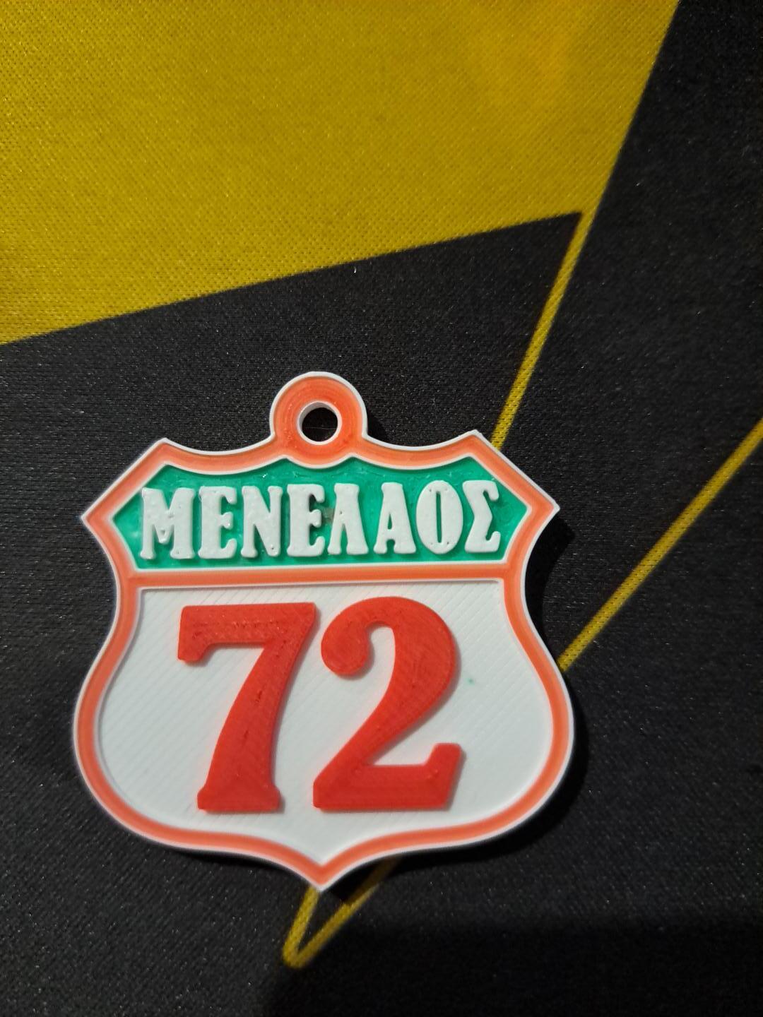

Photo 3 – Close-up:
The main problem is especially visible on the small text “ΜΕΝΕΛΑΟΣ”.
