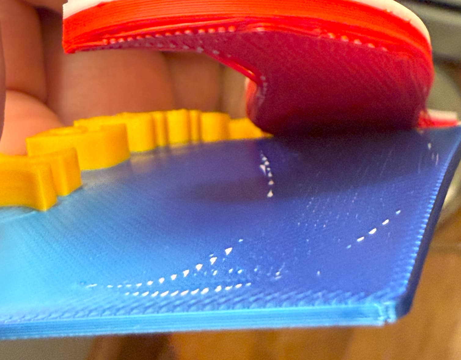

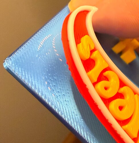

Hello.
I’m printing some stuff for my son but am having an issue where Bambu PLA Matte will not properly adhere to the layer of Bambu PLA Silk+ beneath it. This results in the model easily splitting into two. If I print the model entirely out of PLA/PLA Matte it comes out fine, and it’s only when introducing the PLA Silk+ for the background color things go wrong.
Is this a known incompatibility, similar to using PETG as a support for PLA and vice versa, or are there some settings I should adjust to have a better chance of this working?
Silk is very shiny due to additives.
It is these additives I think causing your issue.
Silk filaments are decorative rather than structural. They also have issues sticking to themselves with a little pressure they can break on their own layers.
It makes sense. Maybe I should embed the red section into the silk a few layers and try beam interlocking.
Best solution- super glue.
Not all glue works with PLA, some melts it.
If this is a route, better to get products designed to work specifically with PLA like PLA Gloop.
I have had adhesion issues with silk mixed with other PLAs as well, not always.
If you can glue it, I’ve used a variety, for small areas I use superglue gel control to just place a drop. I use plastic cement (scigrip) for larger parts, like glueing an arm on a large figure.
