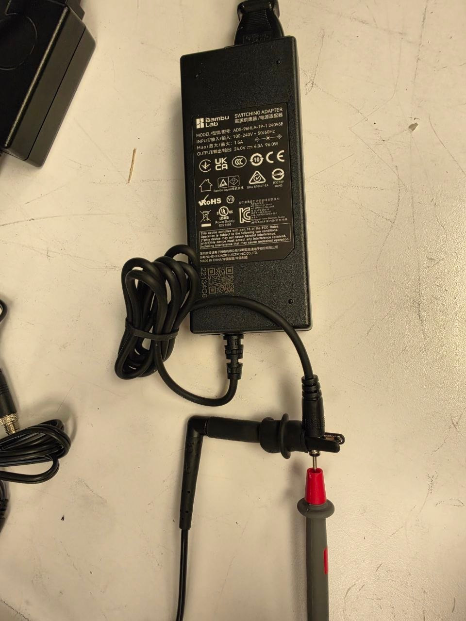

So fellas. Better late than never. Kudos to LaserShip, they only delayed the delivery by half a week.

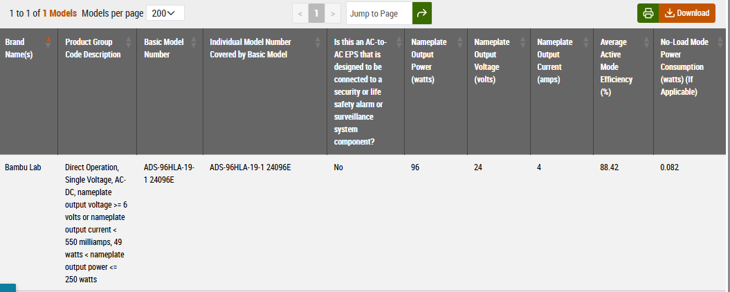

So, as it was mentioned earlier, the brick has DoE Level 6 efficiency rating and I can say that … Yes, it has the claimed 88% of efficiency. But not everything as simple, as it may seem.

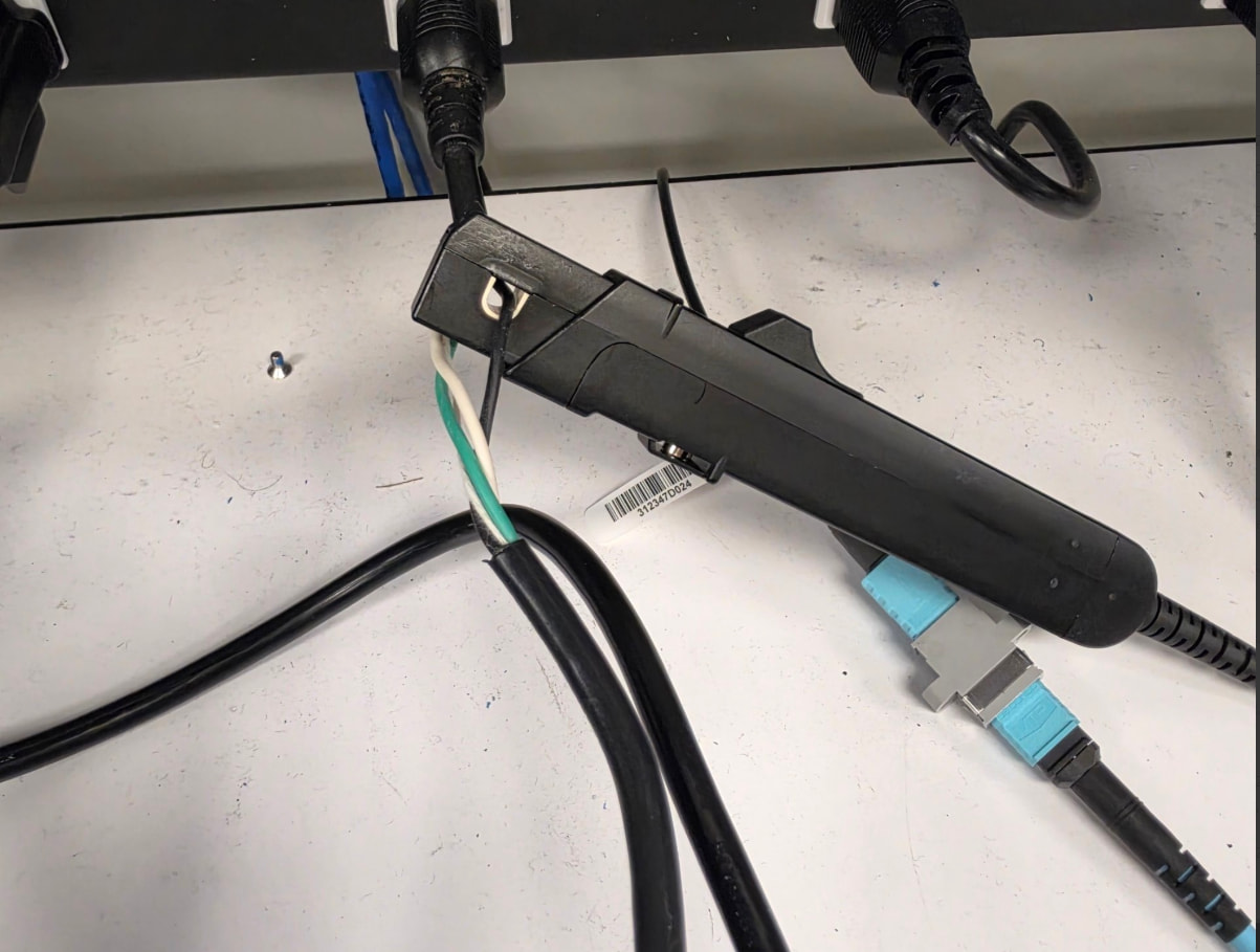

With the help of the static load and AC current probe (along with the MSO) I was able to quickly gather some info on this.
So let’s begin.
All measurements are done on the US grid (@ 120VAC)
Idle power consumption is 2.67W (with zero load applied).
DC Load VDC (out) AC Current (in) VAC (in)
1A 23.74V 0.417A 119.1V
2A 23.57V 0.451A 119.2V
3A 23.39V 0.667A 119.3V
4A 23.21V 0.886A 118.8V
So we get:
At load: Efficiency
1A 47.8%
2A 87.7%
3A 88.2%
4A 88.2%
So… as you can see, except low load, this PSU does perform quite efficiently for a power brick. Good Job BL, you sourced a good brick. I wish more companies would do that.
However, at 4A load, the power consumption off the wall is 105W, while the P_out is only 93W. That means it releases 12W in heat, which at 4A load results in quite a toasty brick (uncomfortably toasty).
After 1 hour of constant 4A draw the efficiency dropped a bit to 87% which increased the wall consumption a bit (106W).
