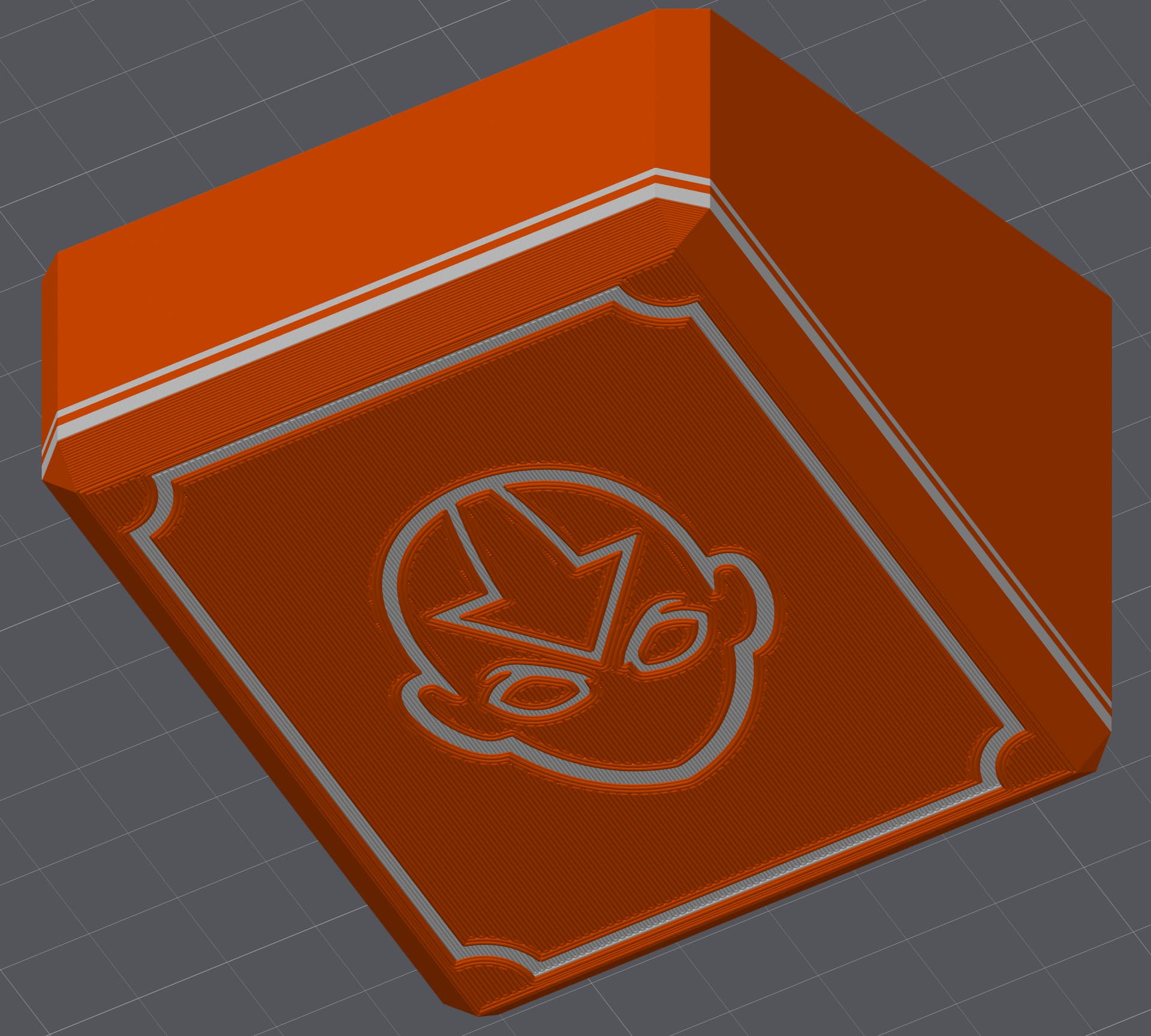

Bambu Slicer won't bridge painted surfaces, instead creates overhangs
I’m trying to paint a negative feature on the bottom of my models,
letters\numbers etc because I need text on both sides…
should be no issue but instead it turns what should be an easy bridge into a pure overhang…
to demonstrate, take a standard 20mm xyz cube… flip it upside down, and paint the Z
if I remove the painted surface it bridges the small gap just like anything else no problems
I also have this issue using 1.10.1.50.
Did you ever find a fix?

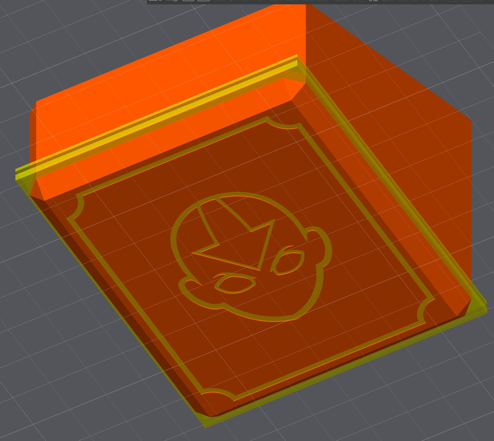

Only fix I found was to make a completely seperate part and position it where the bridge would be and paint it
Very broken
That is what I have found too. But this results in 3x as many filament changes for me.I tried painting just the surface that shows on the bottom, but it did the same thing.
Nevermind. I just have to tune how big it is and the location to the main model
Thanks! Hopefully they get this fixed.
