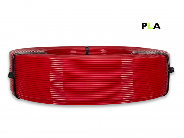

I am truly amazed by their winding and it has zero issues. The sad thing is that this kind of winding is possible, even on refills, but most manufacturers send out a messy pile of filament anyway.
“Das filament” is a good example, I have only ever gotten very tightly wound, immaculate refills with a square profile from them. Even without a (cardboard) core! I don’t know how they do it, but it proves that it is possible:
I have only ever had 4 Bambu refills and they all worked, but none of them were nicely wound
