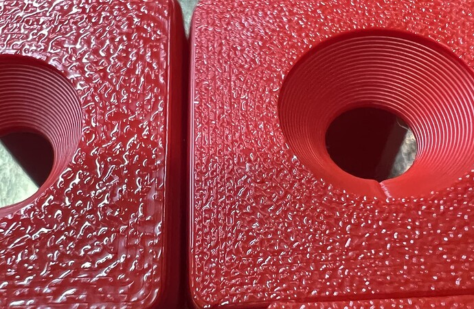

I own a KS X1C and an EB P1P. Both came with textured plates or I ordered textured plates when purchasing my printers. After 100’s of hours of printing on my “Discontinued” PEI plates I decided to order the newer Gold PEI. To my disappointment the texture on the new plates do not hide the layer lines like the older PEI plates. At first I thought it was my X1C acting up until I received my P1S last week which shipped with a TOTALLY different Gold PEI plate. Color tone is different and texture is the same as the original PEI. My parts look AMAZING printed on the P1S. I also ordered 2 additional Gold Plates with my P1S. These plates match the previous purchased plates that have a finer/smoother texture than the original PEI and the new P1S PEI.

Attached is a picture showing the texture difference between the Gold Plate that just arrived with my new P1S (left) and a new Gold Plate (right) that was purchased directly from the store. Everything is exactly the same except the build plate. As you can see the P1S Gold plate has a deeper texture (same as the original PEI textured plate) than the other which hides the layer lines and wall loops.
Print is Polymaker ASA

I am not sure, but I could speculate that you are working with sub-extrusion. For whatever reason. Because the first layer should be perfectly smooth. You get a visible separation of the wall lines if, for example, the extrusion is set too low. On the other hand, you can also adjust the line width of the first layer, the printing temperature and more. I would experiment with these parameters to get a nice and closed first layer. That way, you don’t have to rely on a specific accessory because it happened to give a nice appearance to the first layer with that and their print settings used.

I just looked at some prints of mine made with PolyMaker ASA on a gold PEI plate purchased separately mid July (USA) on my X1C. I see lines similar to the ones shown on your two photos. I never noticed them because I use the default monotonic pattern and I tend to have just 1 or 2 walls and the lines become a pattern I don’t really see.
In your samples you must have many walls or the concentric pattern? I have the feeling that this accentuates the lines. Maybe try using monotonic on a diagonal and select “only one wall on first layer”. That combined with a bit boosted “first layer flow ratio” as KanneKaffe mentions should get you to a point you like.

But I’m still frustrated and concerned that we’re getting different build plates when we’re to believe that the build plate sold separately is the same as the build plate that ships with the P1S. Which it is not. As I mentioned I have 4 brand new Bambu Store purchased Gold plates that are all the same (smoother texture) but the P1S build plate has a deep/rougher texture similar to the original Black PEI plate.
Leads me to believe these are coming from different sources.
You can see the option at @3dsurfr-picture, names “first layer flow ratio”. E.g. try >1. I would first check whether the filament is really calibrated accurately.
I’m fairly confident that what you’re seeing isn’t really a defect or quality issue more than just the texture that’s sprayed onto the sheet via powder coating. It could be as simple as one had a higher texture powder than the other when being applied. My guess also is no two sheets will be identical with this process.
You are correct. I don’t feel it’s a defect as I have 4 plates exactly the same. My point is the plates purchased via the Bambu Store are different than the plates that are shipping with the P1S.
The plates from the store have a finer/smoother texture which is different from the original PEI and what shipped with my new P1S. I can’t print production parts with different textured plates. And the Bambu Store plates are not as nice aesthetically.

When the first layer is optimised, it will look even better. How high the outer structure is on the printed part and whether it looks good or not is also a question of personal taste, but of course it depends on the print plate.
And before you change the flow ratio, increase the temperature a little for the first layer, print a little slower and see what the result is.
