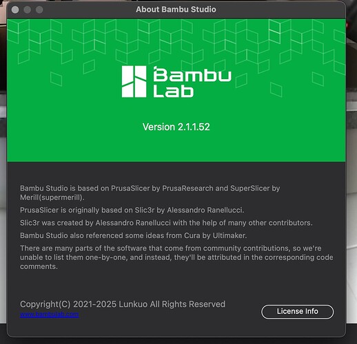

Hello,
I just recently upgraded Studio to the latest version, 2.1.1.52, and I’ve been experiencing Studio crashing, just disappearing from the desk top, at any given time. This happens even when I’m not doing anything on it.
Has anyone experienced this?
The printer is connected via our company’s internal network, ethernet, not wi-fi.

Same. Got some configuration file errors everytime I started up Bambu lab. I uninstalled 2.1.1.52 and installed 2.0.3.54 and it works just fine.
Since you have B-labs open all the time, are you sure you’ve restarted it since the update? The update doesn’t take effect until you close out and restart the application. Just wondering. This new update seems to break connectivity with your printer and crashes because of it.

Windows 10, Network plugin not installed, Changing printes or filaments available in vendor selection several times (< 6) BS will “disapear” on clicking confirm without saving changes. BS has been restarted several times (not including crashes). Don’t have access to event log at the moment.

I’ve uninstalled and reinstalled 2.0.3.54 (the previous version I was using) and things are working fine. Hoping the folks at Bambu get one this and issue an update soon
