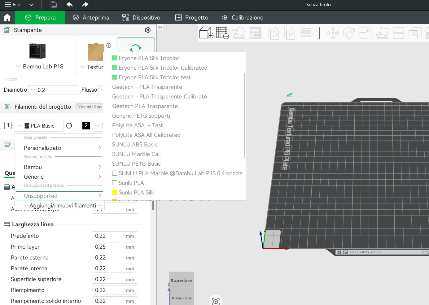

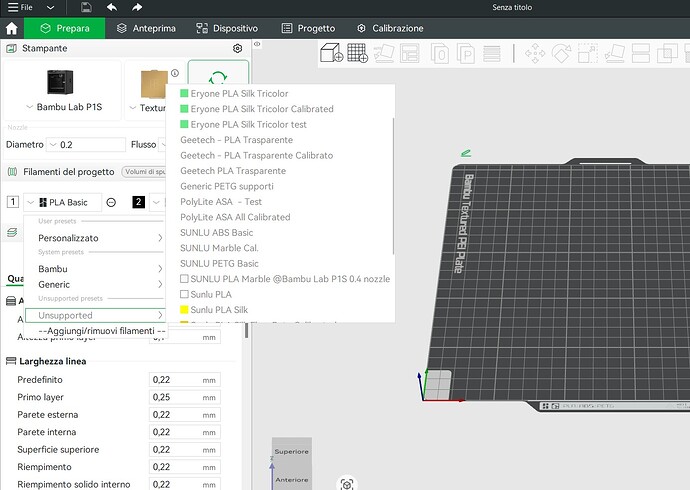

I just updated Bambu Studio 2.1.0 to the new version 2.1.1 and no longer see all my personal threads in User Preset and have been moved to Unsupported and my personal Print Preset. I logged out, rebooted my pc, closed Bambu Studio, opened it again and logged in, but I have the same problem despite I confirm the import of my custom filaments. I uninstalled the new version 2.1.1 and reinstalled the 2.1.0, but now I have the same problem. I did the same operations as before, to see if it settled, but nothing happened. Has anyone had the same problem? If he solved it, how did he do it?
Screenshot 2025-06-18 123226
The update changed the printer from my X1C to a P1S. My presets reappeared once I selected the correct printer.
Upgrade didn’t change my printer like you. I’ve added X1C to my printer list and it works for me! Now I’ve my P1S and all my personal User Preset! Thank you so much!!!
