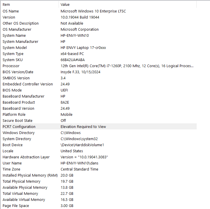

The updated versions are getting slower and slower. I compared 2.02, 2.03 and 2.04 to 2.05 and it’s very noticeable–I’m using 2.03–I’m a hobbyist. This is my system (not exactly low end):
