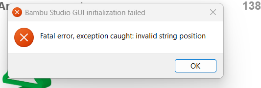

Bambu Studio displays error when opening
I used BS earlier today. But opened again and error is displaying.
Uninstalled and then reinstalled and same error. Any suggestions on how to fix it.
Fatal Error, Exception Caught, Invalid string position
Something is corrupt in the settings/preferences for the Application.
Deleting settings/preferences should fix it.
Chris, I recalled that when uninstalling BS there was an option at the end to remove user data. Didn’t do that the first time. Uninstalled again and selected that option. BS is now starting.
Thanks.
Removing BambuStudio.conf file and Bambu Studio settings setup quickly resolved this issue in my case
