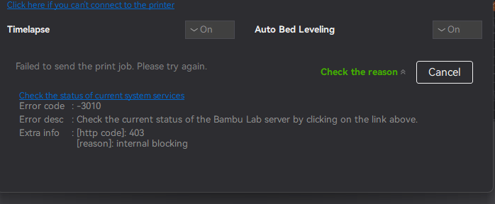

I was printing no issues next print in I get encountered this error
Can’t figure out what to do turn my ethernet to private, reset both printer and PC.

Able to print from my computer by the following steps.
  1. send print normally… get error
  2. click Device
  3. click Storage
  4. click Model
    The model IS uploaded to the SD Card… (weird right)
  5. Select Model
  6. Select Print
  7. Send model… AND it printed fine from there…
The error I get is:
Error code: -3010
Error desc: Check the current status of the Bambu Lab Server by clicking on the link above.
Extra info: [http code]: 403
[reason]: internal blocking
When looking up the error code on Bambu wiki, it says this code is for:
-3010
failed to request project id
Sending printing failed. Please check the network try again.

For me it was resolved next day. Perhaps it was an issue on their end… at any rate it is working now and I’m able to send my prints through the cloud once again.
