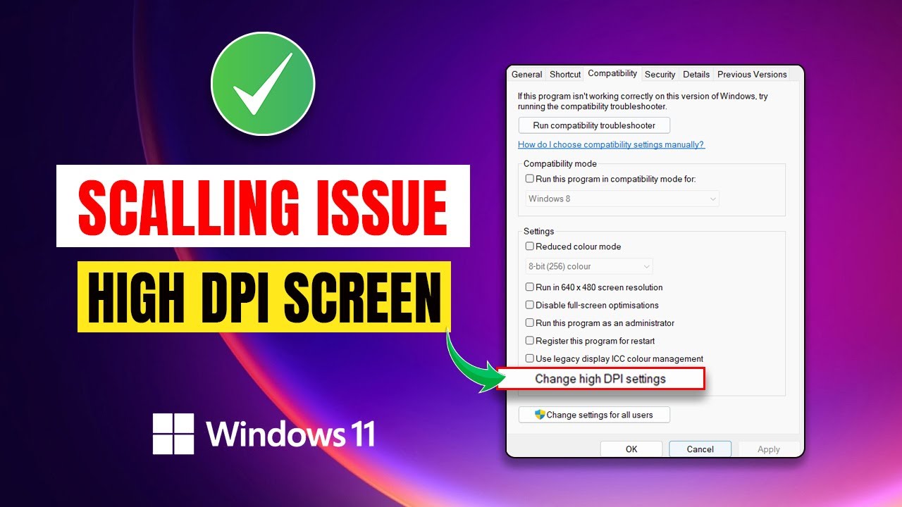

The second area that this can be controlled is in the properties themselves. Go to the app and right click on properties, then click on compatibility. Change DPI settings and experiment with each one.
Note that the Open Advanced Scaling Settings will take you to the Windows Setting for your display just like if you had right-clicked on the desktop.

I’m not sure I can reduce it down any further but perhaps check out this video as it provides a visual representation of the steps.
The one thing I might suggest. If you’re making the changes and you’re not seeing anything change, you’ll want to completely exit the program and start up after each change. There are three possible combination of high DPI, each one should be tried and the app restarted before trying the next.
