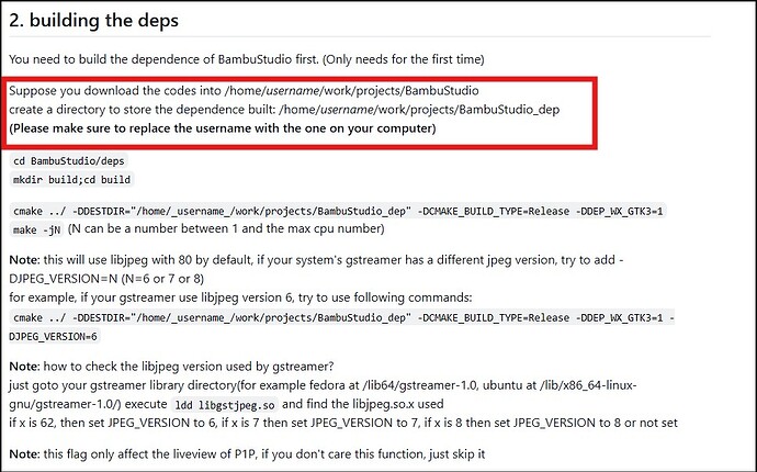

I am in process of trying to install Bambu Studio on a Raspberry Pi 4B and do not want to go down any deep rabbit holes if I can avoid it.
Over on the Bambu Lab Github pages there are instructions about the process.
I’m at this stage but in a holding pattern to sort this out.
Is this block in red important about the directory structure? My pi projects so far have not required specific directories which in turn have specific files in them but I know you can mess up if the structure is wrong.
Does the Ubuntu zip file have some default folders it will try and create or can I extract everything to a folder of my choosing.
I have not seen anything on the wiki that gets into installation on any Linux distribution.
There is a flatpak option also.
