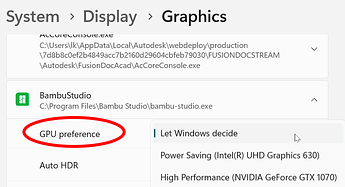

Hey Guys,
I was wondering if any of you are still having the problem that Bambu Studio is only using the slower integrated graphics card?
On my three laptops, each with a powerful dedicated graphics card (two GeForce and one ADA), Bambu Studio only uses the slower internal Intel graphics card in the preview window, and it’s really lagging.
I don’t want to disable it completely because the dedicated graphics cards would use so much more power when i am not connected with the power supply.
So, does anyone else have this problem or a solution?
Greetings

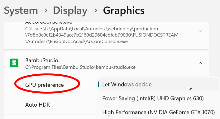

is the issue that the 3d view is slow? or glitches? because you can force one of the cards per app, like if you want the geforce to be the one for bambustudio.exe in Windows settings
What is selected in Windows Settings?
I really do not notice a difference, but my graphics card was never exceptionally fast. Some systems need to use internal graphics to prevent crashes from incompatible drivers.
Preview shows the sliced file; slicing is done with the CPU, not the GPU. View changes (pan, rotate, tilt, zoom) use the GPU.
You can see this by watching Task Manager-Performance while slicing.
Power options on a laptop may slow the CPU while operating on battery.
