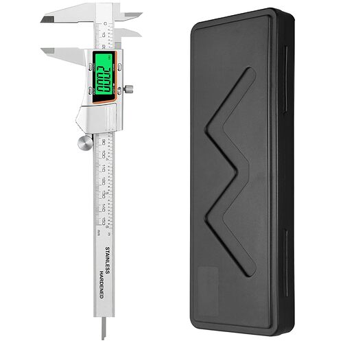

Then I upgraded to full metal with large text and backlit. I love these things as I prefer to work in a light-subdued office.
